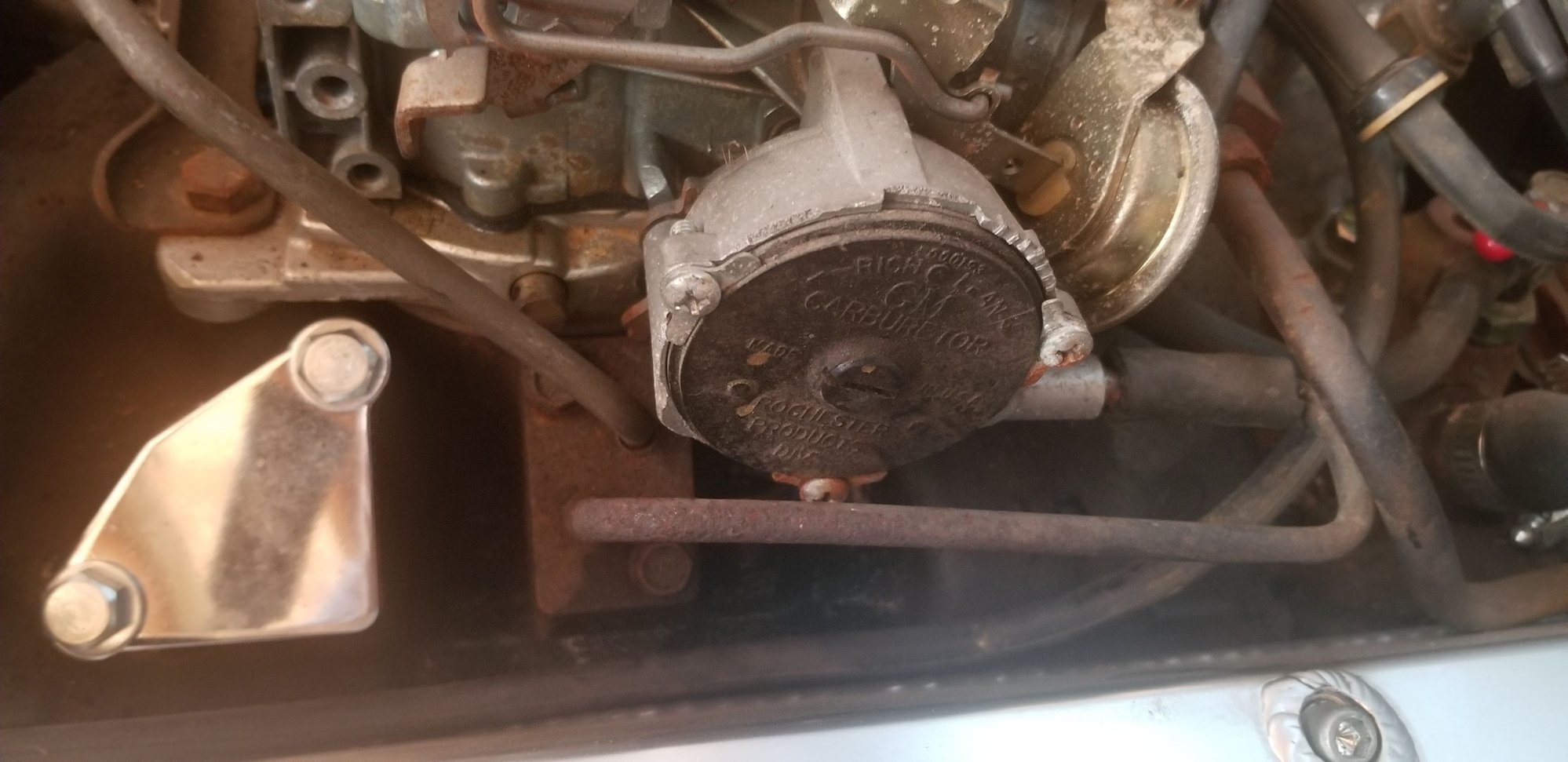

Hello everyone, just bought a 77 L48 auto, and I am learning a ton here! I am going to be doing a full tune up and putting on a Performer 2101 as well. Couple of questions though, hope you guys can help!
first picture, I have a rubber hose attached to nothing...should I plug that?
Second pic...there is a tube extending out from the top rear of the carb that goes into the intake...and then another tube that goes to the choke assembly from the intake. Do I need this??? Thanks in advance!

I'm not really sure what you are pointing out in the first picture. There appears to be a blue cap on a vacuum nipple. The pulloff should be connected to that port.
In your second photo, the metal tubes go to your heat stove. They are required to make your choke work. To swap to a different intake that does not have this provision, you will likely need to convert to an electric choke.
It looks like someone already did you the favor of removing your EGR valve. Make sure that your distributor vacuum advance is connected to a manifold vacuum port (not ported vacuum).

Thanks for the reply! In the first pic, I was referring to that inch long rubber hose right next to that blue cap. It is just a hose with no plug.
The intake I am using does have the provisions for these tubes, however i was going to plan on using Fel Pro 1204's to block the crossover...should i just use regular gaskets then?

In your first pic that is the vacuum for the secondary pulloff.....chances are it is bad and Bubba disconnected it and capped the port. What happens now is the secondaries will open too quickly and cause a stumble. The air valve needs to open a bit slow for the engine vacuum to pull a "quick shot" of fuel before the valve opens to engine demand. This shot simulates a secondary accelerator pump. Chances are you have abog when the secondaries open right now.

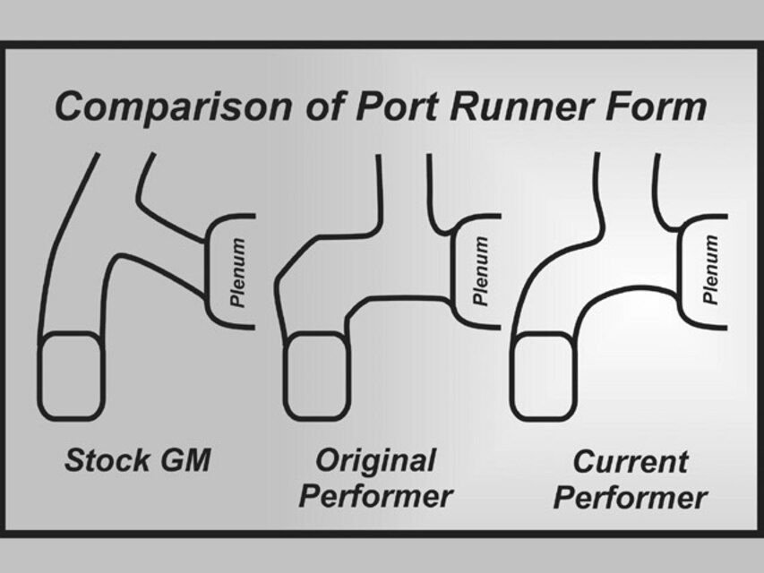

The pic below is a drawing of the GM vs. Performer vs. Performer 2000 on.
Jebby

In addition to having no secondary airvalve control due to the disconnected hose, you also have no choke pulloff operation, so your choke will remain fully closed upon engine start, resulting in a flooding or rich-run condition. If the pulloff has been disconnected because it's defective, you need to replace it and hook it up. If it's just disconnected because someone thought it prevented the secondaries from opening, you just need to hook it up. Test it by sucking on it.
If you do have to replace it, be aware that most of the replacement pulloffs do not have the correct bleed-off restrictor installed in them (if they have a restrictor at all). This results in no control of the secondary airvalve with a resultant bog going into the secondaries. You have to fabricate and install a correctly-sized restrictor in order to make the pulloff operate correctly.

I appreciate the response...so I plugged he vacuum hose into the port with the blue cap right next to it. The diaphragm immediately moved in. Dont know if its functioning or not, you mentioned sucking on it...

It's a good sign that it moved. I would still remove the hose and put a long hose on it that you can suck on: Sucking on it should make it retract, and you should be able to tell that it's not leaking. If it retracts, and it does not leak, it's good. If it leaks when you're sucking on it, you need to replace it, since this will be a vacuum leak source for your engine, whether the diaphragm retracts or not.
