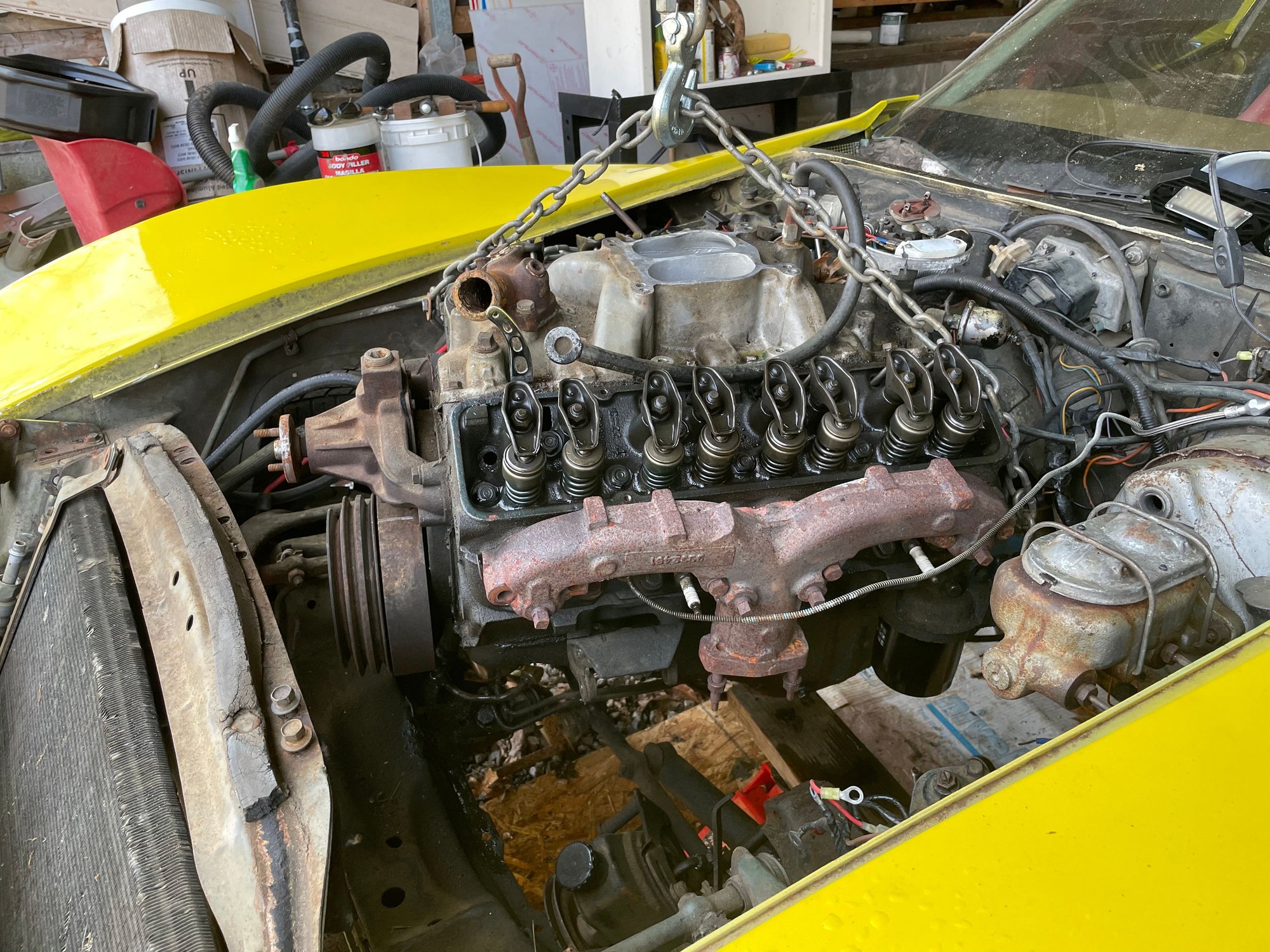

I've done it. I replaced the engine and transmission in my '73 by myself last year. Removed the drivers side tire and went in from the side. My Harbor Freight hoist worked well. I got the engine part way up and got nervous about how close it was going to get to the top inside of the hood. So, I used a rope to hold the hood in the most forward position I could get it and that gave me the extra clearance I needed. The only minor issue I had was that I was using heavy duty moving blankets to protect the paint and I neglected to extend the blanket far enough over the side of the car. The ram of the engine hoist rubbed a small spot in the paint at the bottom of the wheel well.
I used an engine leveler in conjunction with the hoist. There was a lot of distance between the top of the engine and the top of the boom on the hoist. If I had to do it again, finding a way to shorten that distance would have made it a little easier. As would actually having some help.
