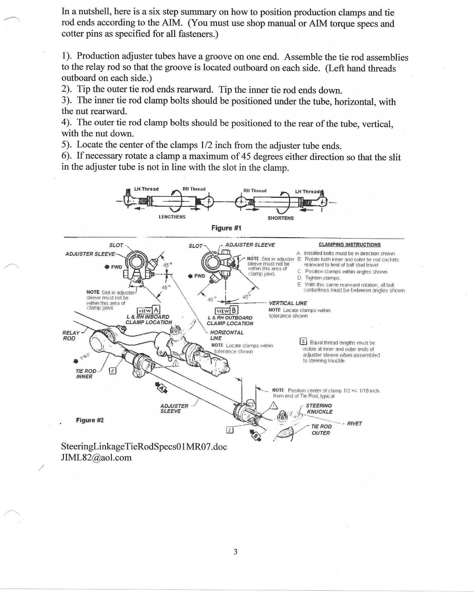

Default Does this help?
To Front Inner and Outer Tie Rod Threading
