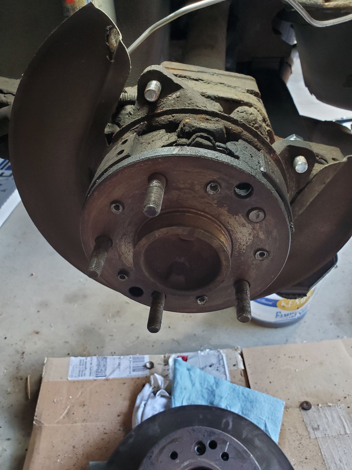

Quick update as I got a little time with the car tonight. So, I won another small battle. All of the rivets are out! Banging was not working. So I drilled and stepped up in size. The largest was 5/16. When that is done, then a simple flat head screwdriver (you all know how I like to use screwdrivers) can be tapped behind the rear head of the rivet and then pry it and it pops out easily!
​​So, here is my hub with all the rivets gone and just the bloody studs left.
As to what the back of the rotor looked like... There is a small Ridge, see following photo. My other thought is this... Recall that my wheel was not on tight and it was wobbling a bit... It was enough to snap a stud off. I'm guessing one or more of the remaining studs are bent and that didn't help the rotor coming off either. In fact, when I try to put it back on, it does not go on nice and easy like you would expect.
So now it's down to the studs. I hit them a few more times with my big hammer tonight and none of them moved. I sprayed some penetrating fluid on front and back. I'm hesitant to just keep whacking away as I don't want to damage the wheel bearing (I did check be grabbing at 3 and 9...no wiggle). So what about using an air hammer? Would that be better? Or.. What if I cut them off near the hub and then started drilling again (uggg). I'll take any suggestions!

Congrats on getting the rivets out.
The studs, however, are physically much harder than the rivets so drilling will be much, much more difficult. That said, give it a go on the broken one and see how it goes. Be sure to use a cutting oil and have high quality bits that are sharp.
