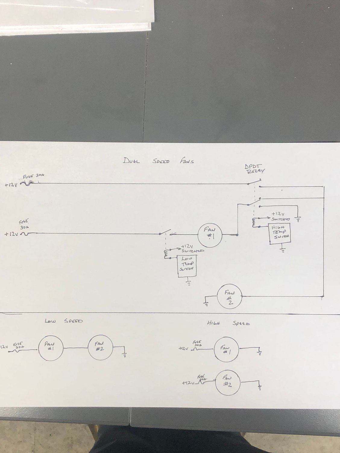

I'm a little confused. You have 2 speeds on the fans? You run 1 fan at a time? or do both fans run together at the same speed?
2 speeds uses 3 relays. Motors are in series for low speed and in parallel for high speed.

Here’s a simple diagram how my fans are wired.Sniper ECU controls the high and low Relays . You can use a temp switch or controller in its place .. I’m using two relays a SPST for low speed and a DPDT for high speed . You could use two SPST relays in place of the DPDT relay it’s up to you .. Mahalos !
