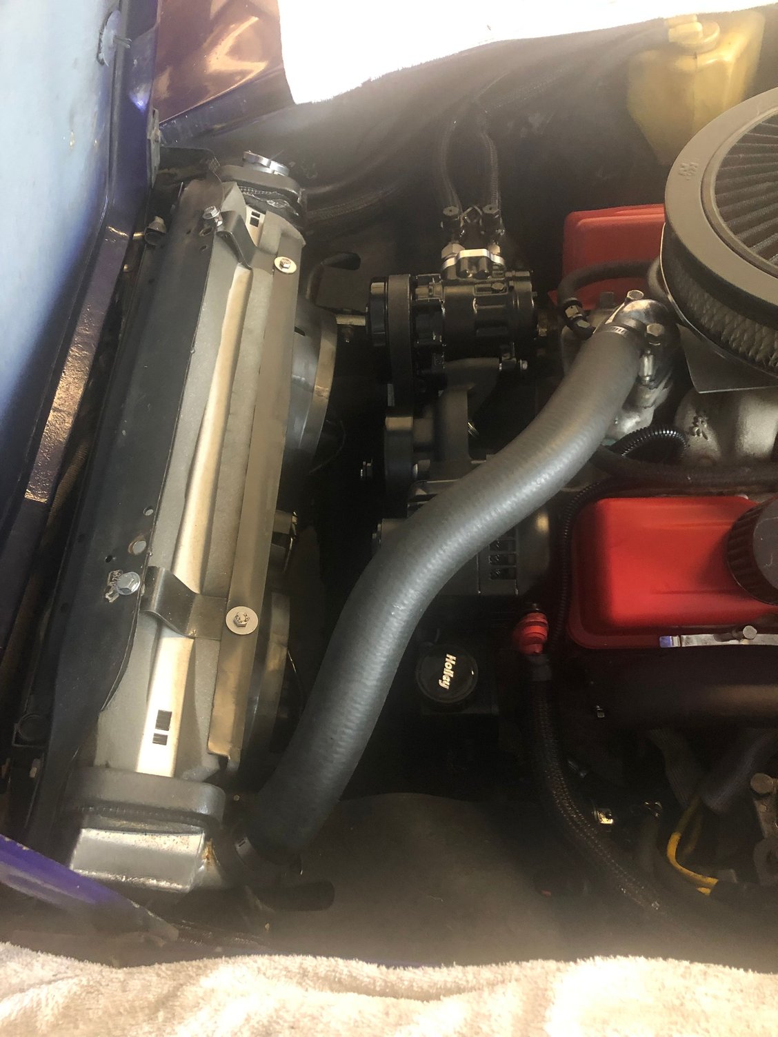

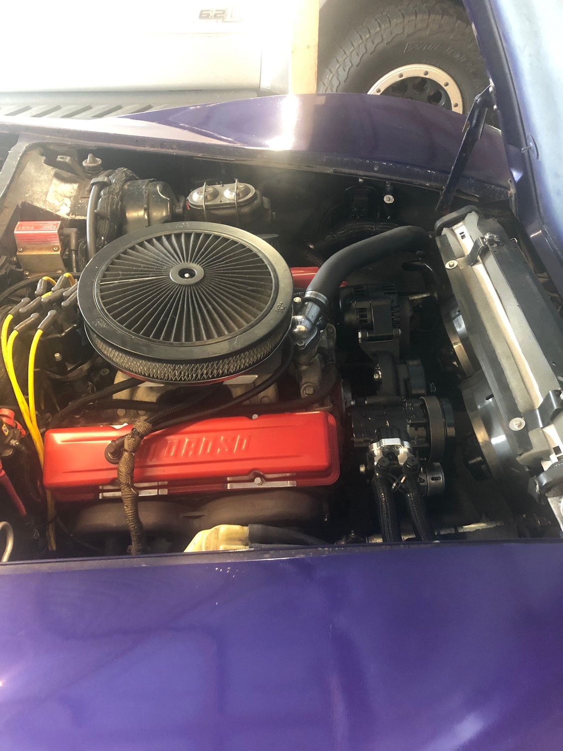

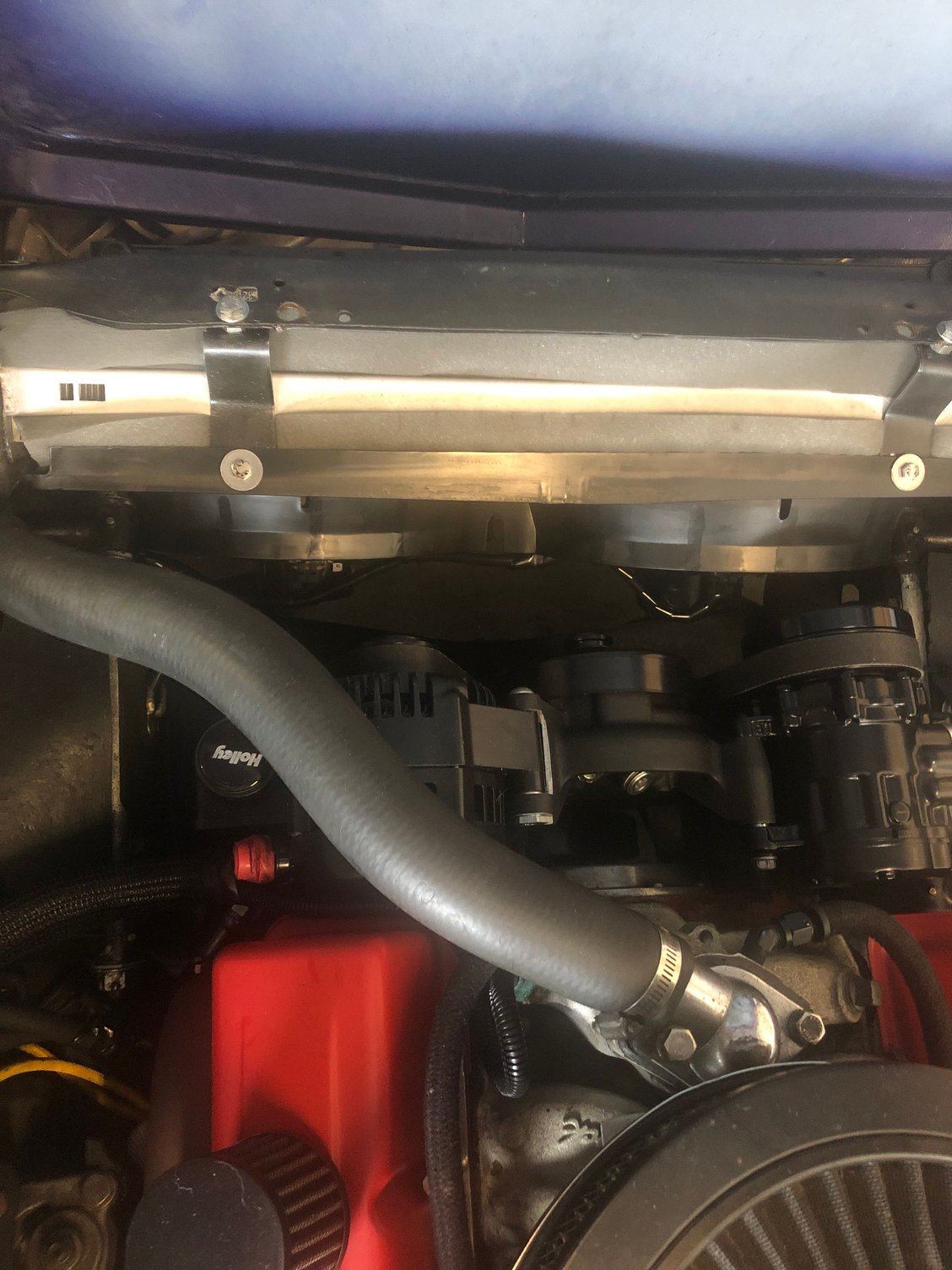

Just installed Dorman 620-634 c5 corvette electric fans they
fit good ..Wired fans in series for low speed and parallel for high speed .. Still have to do a road test but they keep the engine kool sitting in the garage .. Low speed the temp rises then the high speed kicks in and she cools right back down ..

Hard to tell, but how is the a-arm clearance on the driver and pass side? Any massaging needed? I run really thin spal fans and the driver side still touches the a-arm bolt slightly. Might be due to the thickness of the radiator but those look pretty thick. Also, what's the depth measurement on your radiator?

the c5 fans fit good. riht one would hit if centered. you offset it a bit to the left and the left one goes under the a arm. and waaaay easier to remove compared to the oe shroud. i did an ebay set in my 75. only a little less expensive than the dorman new set. i used cheapie amazon fan conrtoller. 25 bucks for everything. both fans run together.

What accessory kit is that? With clutch fan out of the way, it puts everything down low in front of the engine. You'd have lots of room for an over-the-radiator CAI setup.

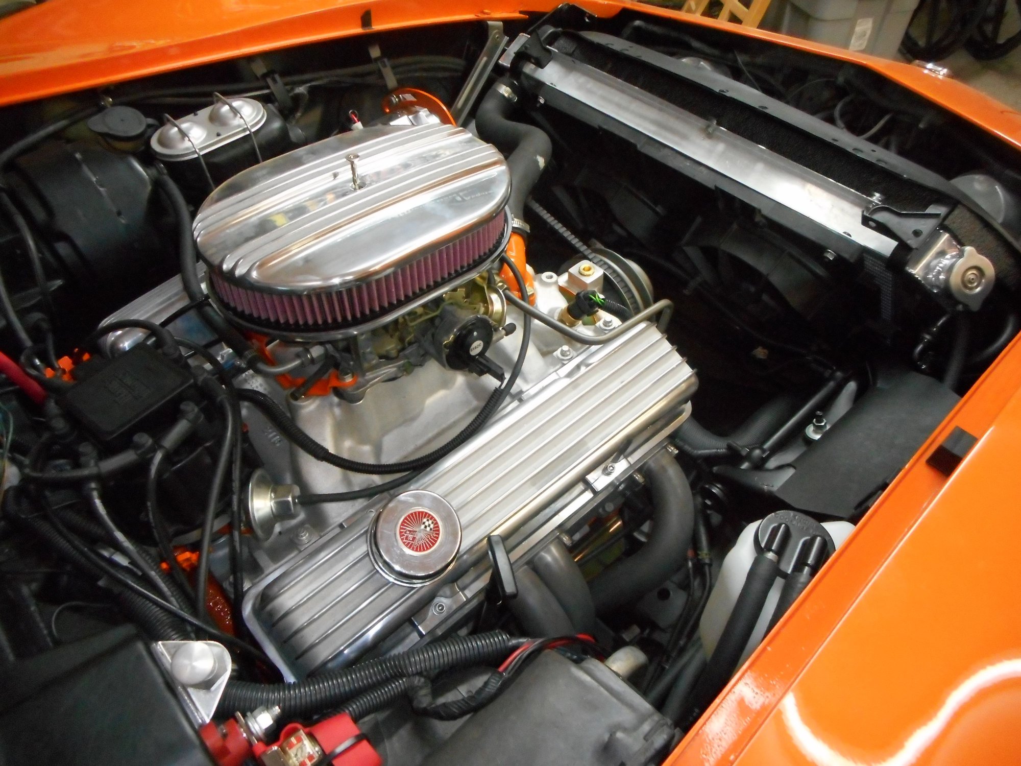

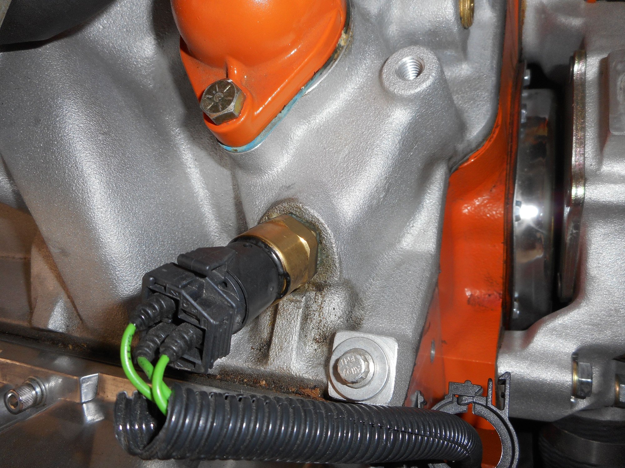

I have the same fans hooked to a dual temp sensor 185/195. My BP 383 stays cool in 95+ deg temps in traffic.Slight massaging to clear upper A arms. Very happy

Holley Mid-Mount serpentine system 20-240BK ..cleans up the engine compartment no mo noisy belts comes complete with all accessories.

I attached the fans after the radiator was in .Also its just shy of going edge to edge so I left it as is.

I am using a BMW dual temp sensor 185/195 w/a Tuff Stuff 100 A alt.Cant use stock alt. w/elec. fans Cant hear them when driving

BMW Dual temp sensor #61318361787. Rock Auto has it. Youll need the pig tail connector/ 3 wire also but I cant find that #.Also youll need a metric to sae adaptor to fit your location
