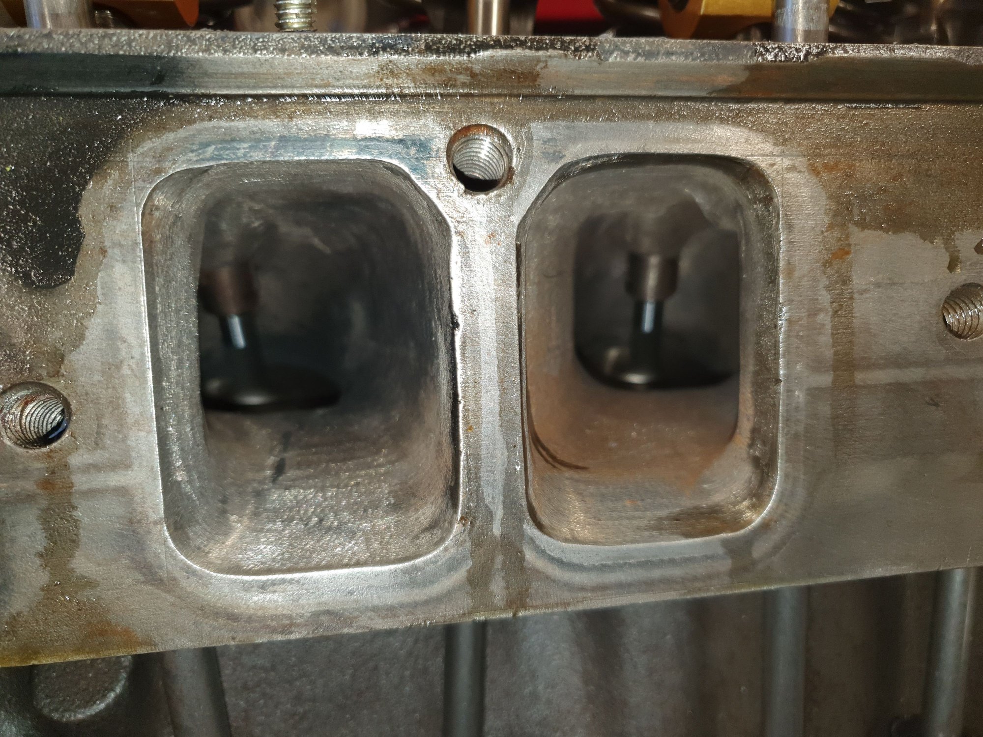

Old Aug 21, 2021 | 11:43 AM

Is it missing some parts in the cam valley? Those springs look like a rev kit, but it should have a cross bar on each side?
It's very feasable that motor is over 600 hp especially if you set something like 7500 into the rev limiter which I highly recommend.
Old Aug 21, 2021 | 01:31 PM
70rs/ss396's Avatar
70rs/ss396
Joined: Jul 2008
Posts: 323
Likes: 18
I think it is lunati lifters, they have a vertical bar towards the block.

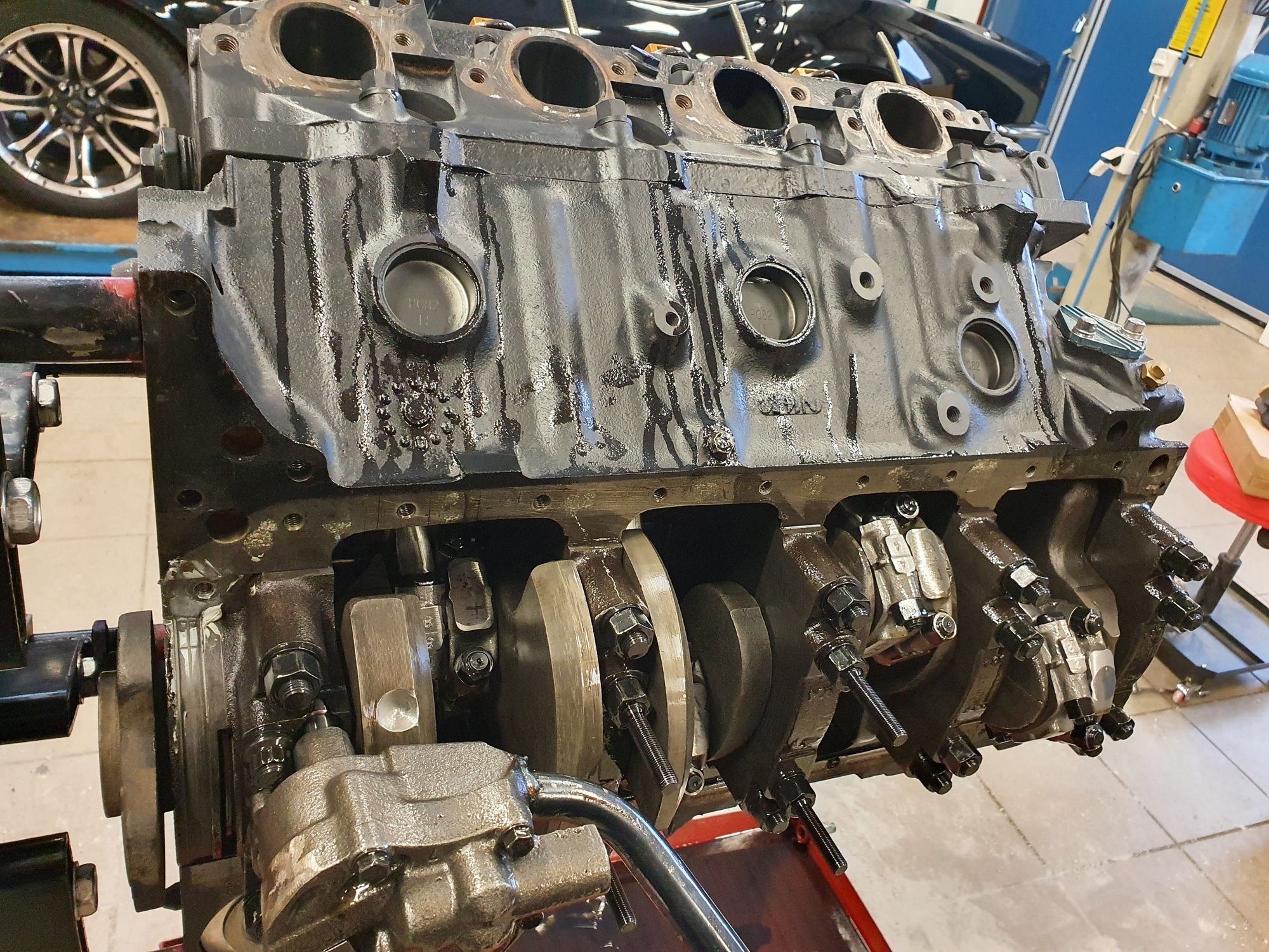

This is the bottom of the engine

I see good and questionable. The worst thing is it looks like a cast crank? Tried to zoom in on it but the parting like appears cast? It does show to be balanced and aftermarket rod bolts in stock rods (3/8" ?) and 4 bolt main studs, welded pickup...so that all points top someone trying to do things right. I'm assuming it's got forged pistons? They used to make cast 12.5 ones too...LOL I ran a set once!
Those look like the spring loaded Lunati lifters that allow you to change a cam without pulling intake. Need to find out how many miles/runs on them. And check them closely anyway for roughness.
It can easily be a near 575-600 HP engine if you spin it up a little...which 427's like. Need to get an idea of how old valve springs are and if those retainers are titanium or aluminum? Be nice to see a bearing or two at least to make sure all is healthy.
It's a lot of cam and will be rowdy...but a lot of fun once you get to 5000 RPM at WOT!
JIM
Its a 6223 forged crank, and original 7/16 rods 😄
