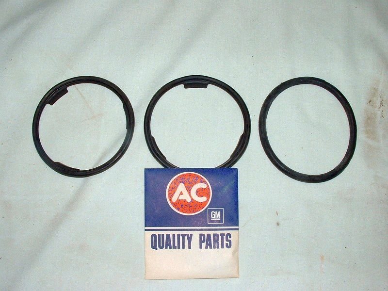

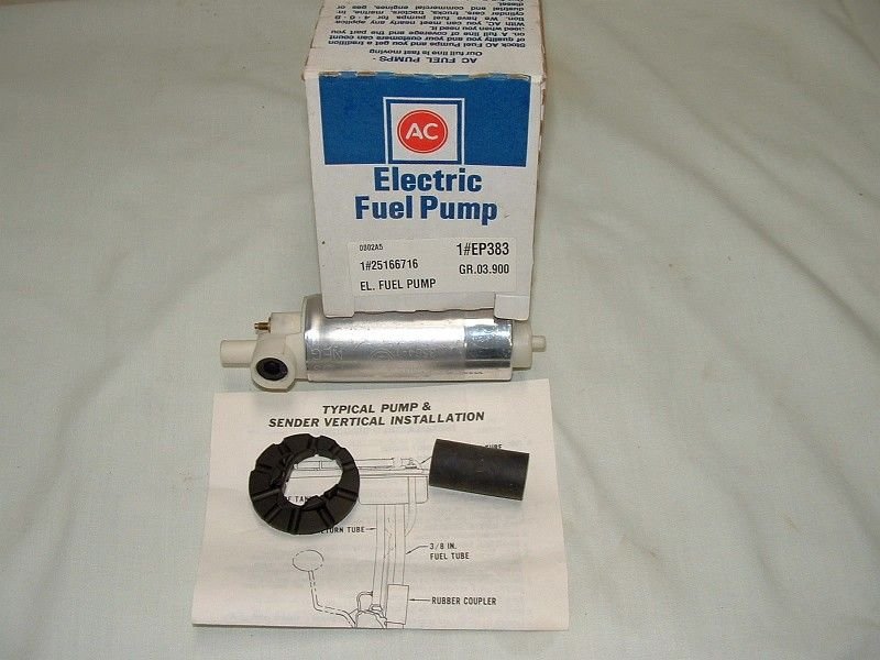

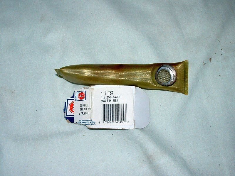

I have NIB OEM fuel pump if you need one.
