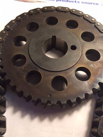

PS: Here is the good stuff, back when they used heat treated gears. Difficult to obtain but will last the life of the engine and then some.....

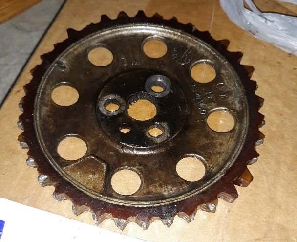

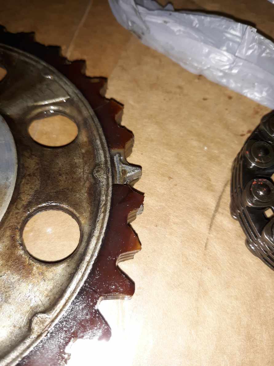

Interesting thread. FWIW my 79 had about 190,000 miles on it when I bought it 25 years ago. Engine ran like crap and leaked like the Exxon Valdez. I put a gasket set in it (not including head gaskets) freed up the frozen distributor advance mechanism and replace the timing set. The cam gear was worn but there were no broken teeth and the chain had not jumped. After that the engine ran like a Swiss watch. I offer this not to argue for or against nylon gears, (I personally wouldn’t use one) but simply to add a little more data to the discussion...

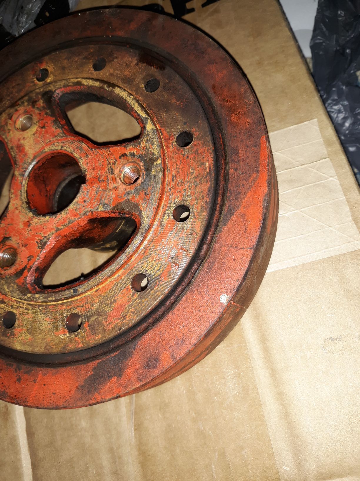

I just swapped the original in my 46k mile LT1 survivor for a Cloyes double roller last week... and not a moment too soon!
In addition I figured out my balancer had slipped by approx 30 degrees. (the timing mark should be just slightly counterclock wise of the key way.)

Slipped damper's hub appears to be stamped " A T P " ... is that an aftermarket replacement damper ? (atp does market low$ replacement dampers)
In addition I figured out my balancer had slipped by approx 30 degrees. (the timing mark should be just slightly counterclock wise of the key way)

It's stamped 7712 A 1 F January of 1971 -
The balancer off my other 71 LT1 reads 7712 M 0 F - december of 1970.

NEVER a good idea to re-use a factory harmonic balancer. The rubber is decades old and at the end of it's life cycle. All my builds here get new ones, usually the SFI variety since many of my engines end up at the track and many of those cars run quick enough they may require those parts during inspection........
