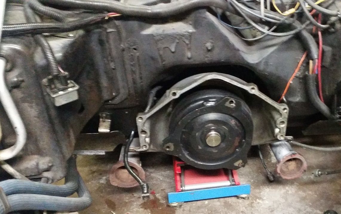

Got a question on Driveshaft differences.
This TH400 in the '73 is about to come out and the pre-70s M20 to take it's place. Instructions say a Driveshaft and Slip Yoke are needed. Why?
I'm assuming different numbers of splines between the two make the M20 Slip Yoke necessary.
But is a different shaft necessary due to different lengths? Is the TH400 Driveshaft and an M20 S.Y. incompatible?
Thanks for any insight on this folks.
Steve
P.S.: Was St. Louis really that sloppy in the application of Firewall coating?
