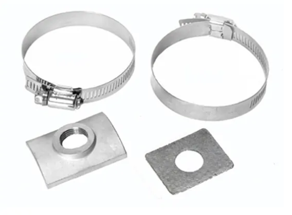

what Shark Racer said is really the best way to do it but if you are dead set against welding a bung on your pipe or collector innovate motorsports makes the tailpipe adaptor for the arf sensor. part # 3728 if i'm not mistaken.

Here's an inexpensive option to add an O2 sensor- less than $20
Tricks -Premium full tank of gas- back off the timing- make sure the engine is fully warmed up
https://www.speedwaymotors.com/shop/...1-11-483-16855
Better one $30
Amazon Amazon
