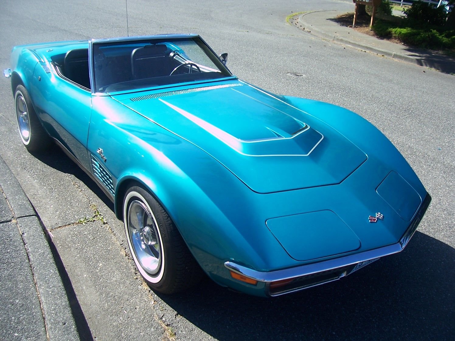

All C3 owners love LT1s. Here's my recently purchased 1970.
