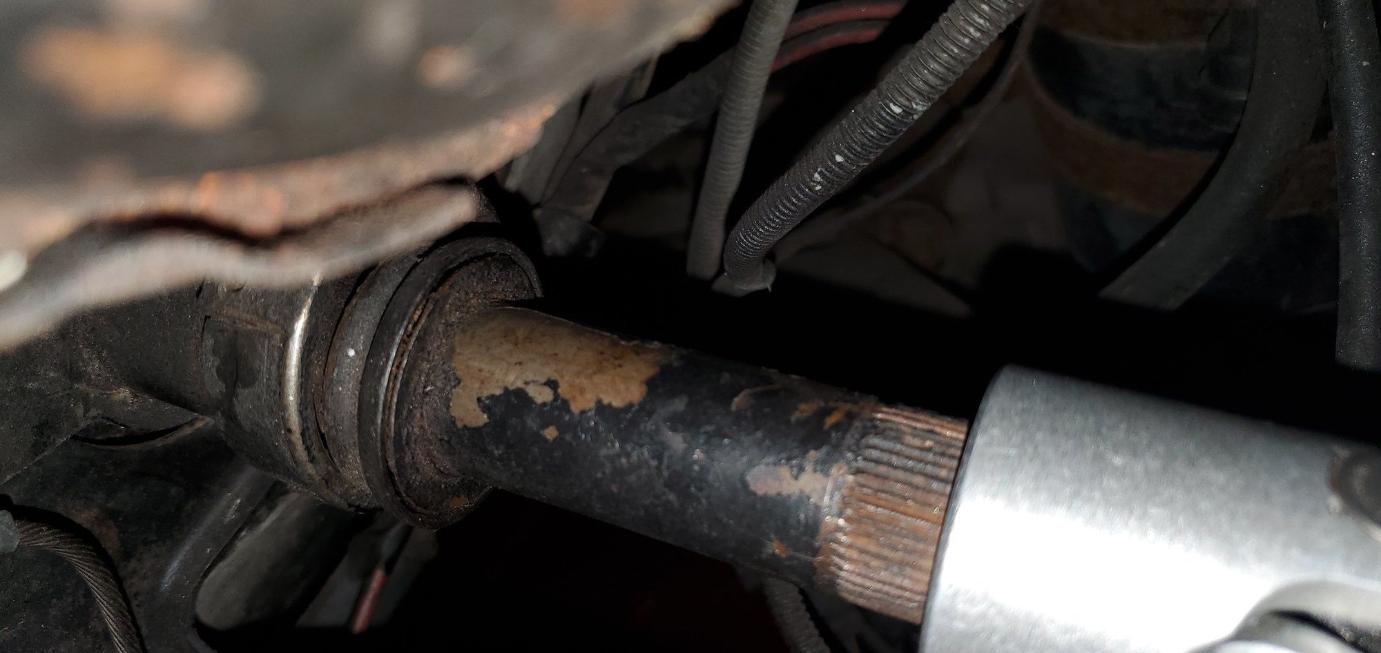

So I recently installed the Steeroids rack steering and the u joints bind a lot. I've since discovered that my steering shaft is very loose and I think that's contributing to the binding. I believe it's loose because the bearing on the steering shaft is not connected to the bracket attached to the firewall. It looks like the shaft should be pulled back to allow the clip to go around the groove in the bearing on the shaft but I can't for the life of me get the column to move back any more. I removed the two bolts that support the entire column and the two nuts that thread onto the studs that pass through the firewall but the bracket always moved with the bearing on the shaft. I can push or pull on the shaft and there's not enough movement to get the clip on. Can someone explain what I need to loosen or how I can move the shaft relative to the bracket?
My car is a 1976 but the steering column is tilt/telescoping and has a hole for a hazard button so I'm guessing it's not stock and I have no idea where it came from.
shaft bearing and bracket
clip that should go in bracket and in the bearing groove

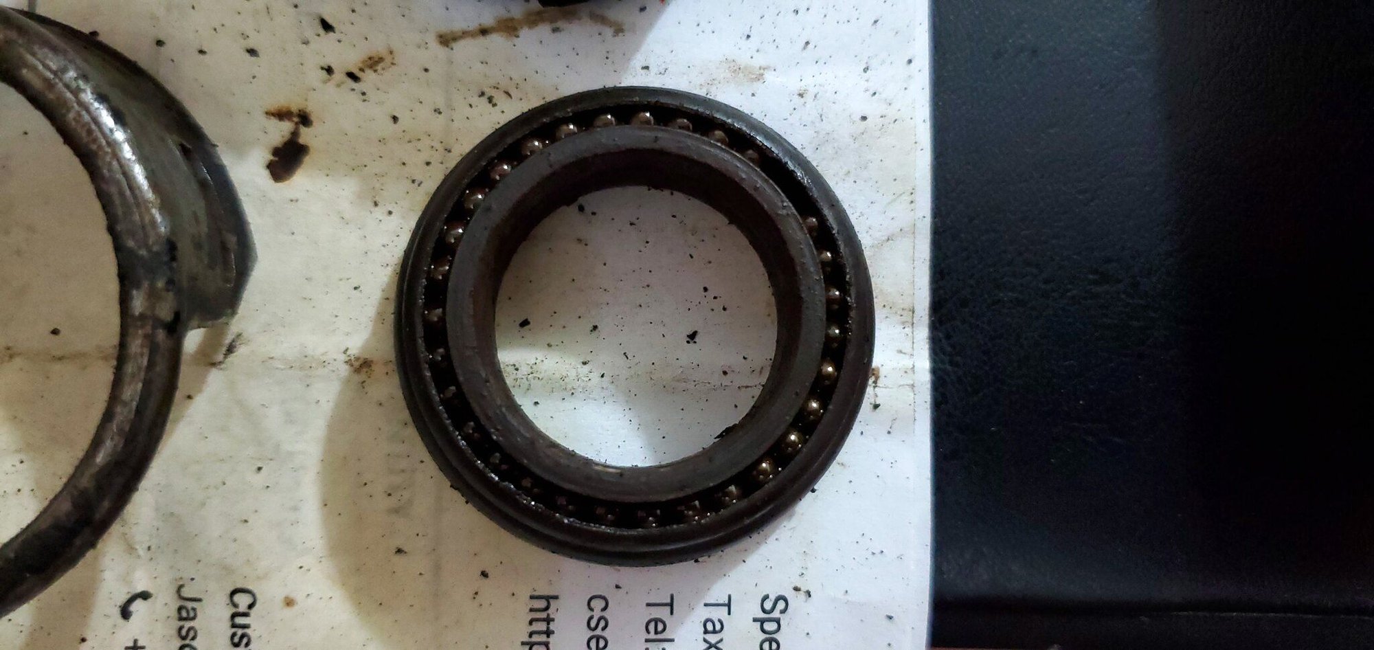

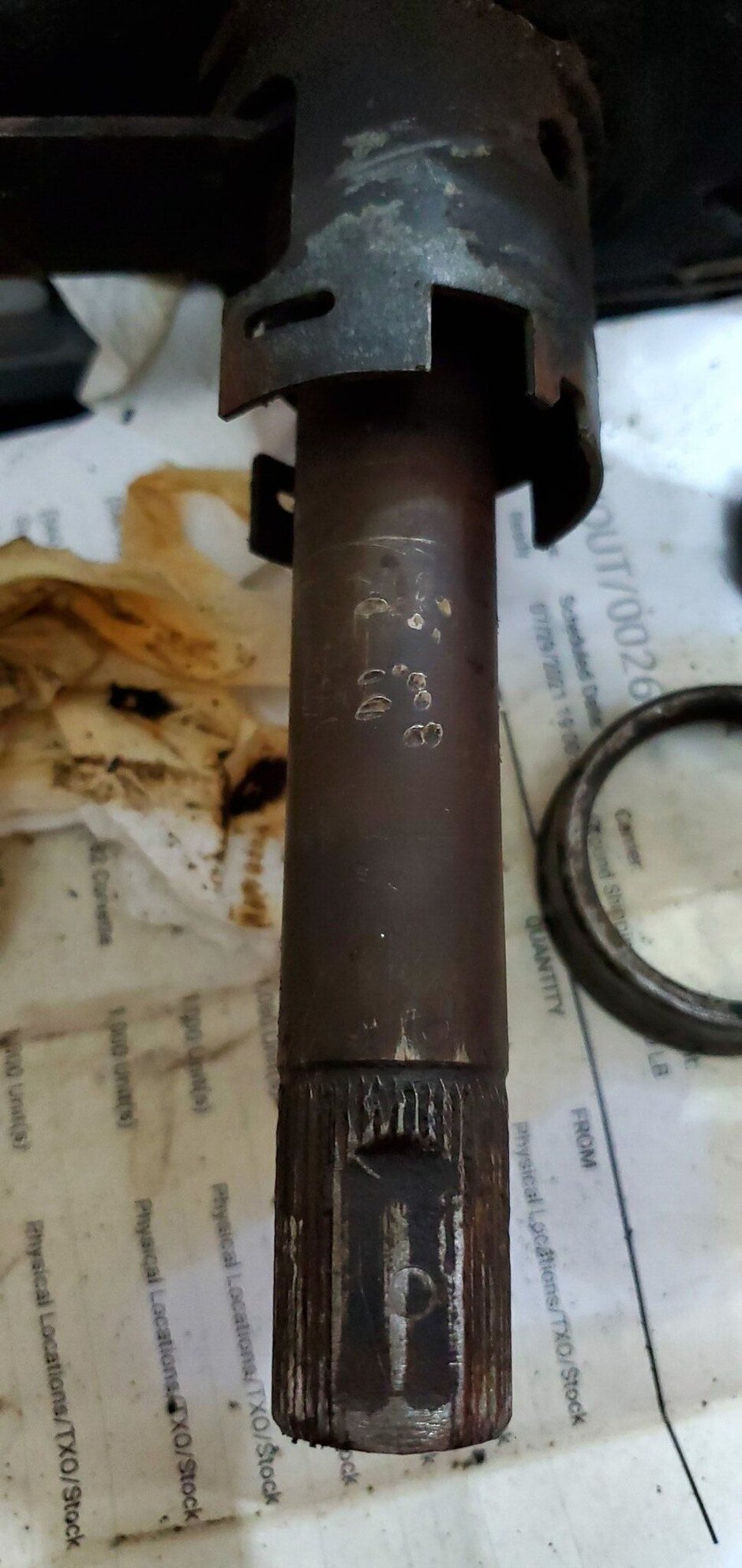

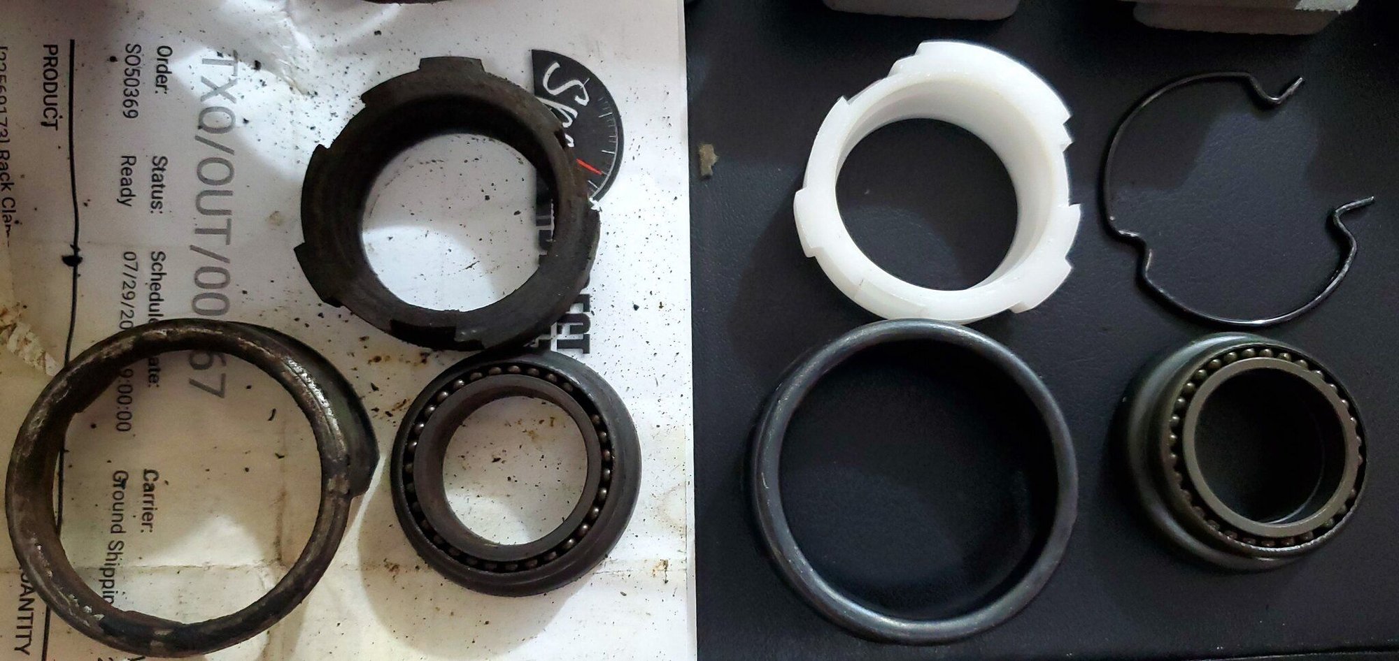

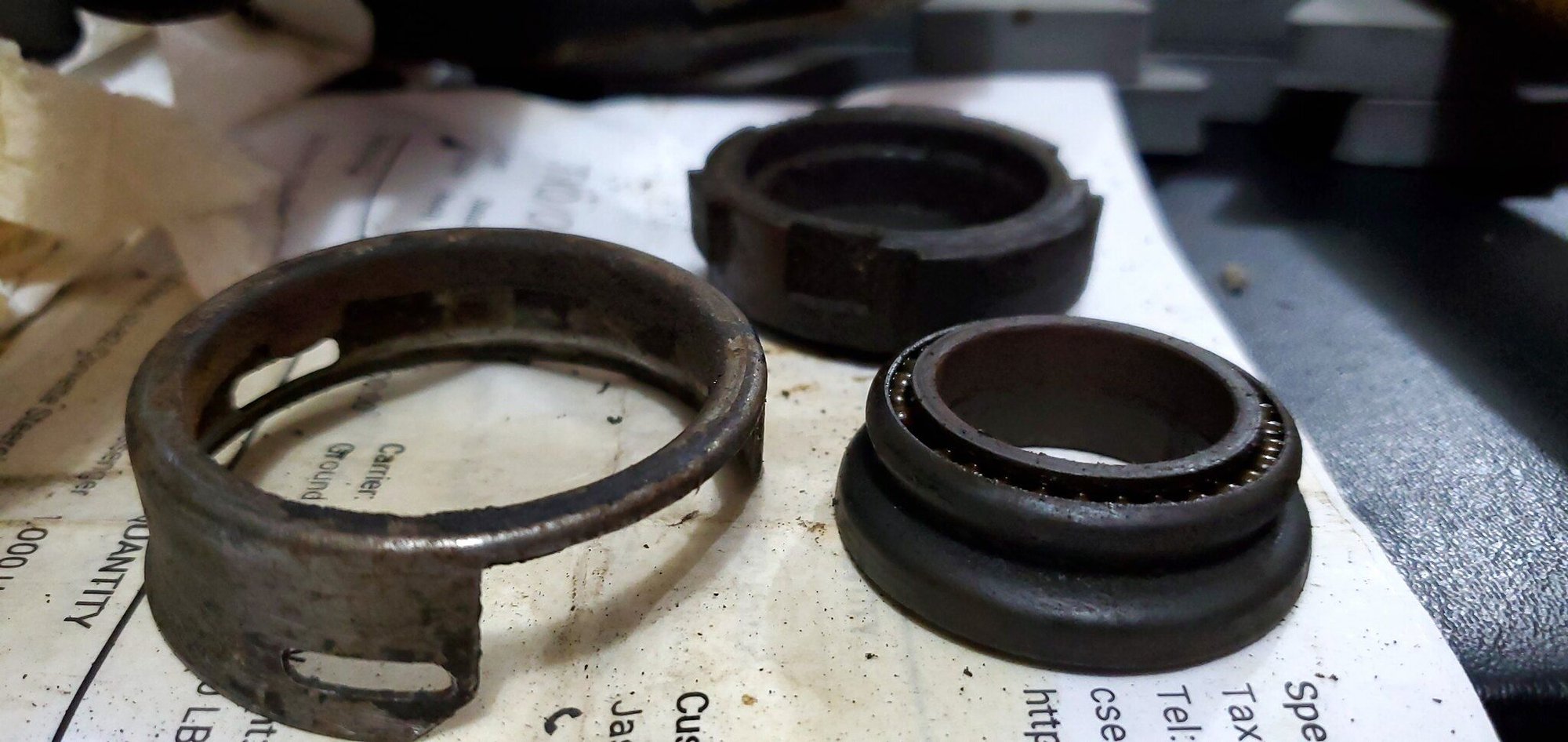

I wire brushed the shaft and hit it with PB blaster. The bearing eventually wiggled off. I was afraid those dents in the shaft would cause problems but it was okay. The bearing rolled a little rough and looks to be missing a ball or two. The kit I ordered replaces the bearing, the black plastic part, the metal retainer piece and the ring clip that holds everything together.

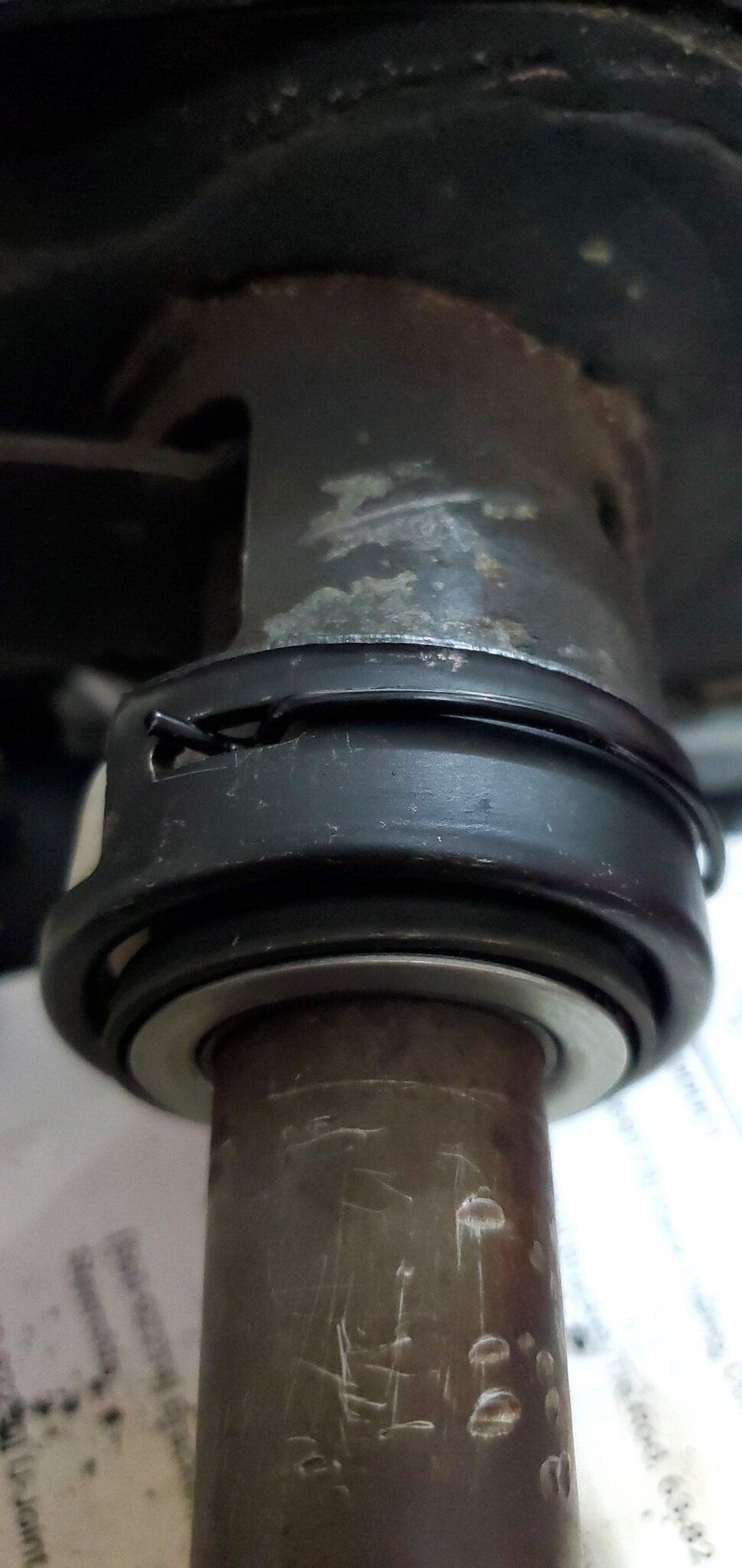

Just to close the loop on this...I installed the new bearing and associated parts and it eliminated the binding in my steeroids steering.
If you're replacing this bearing, I recommend snapping the plastic retainer and the bearing together on the shaft before pushing into position. It takes a bit of force to get the bearing into the retainer.
