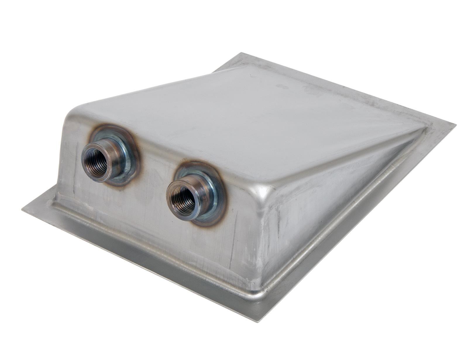

If I were to do it again- I would put a sump in the tank-
https://www.summitracing.com/parts/sum-290300
