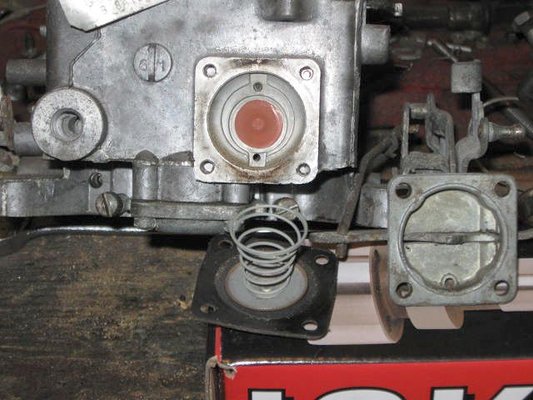

most Holleys boil fuel out of the accelerator pump nozzles after shutdown causing a flooding issue.
Blown or leaky power valves are also a problem.
Cranking while holding half throttle or more usually does the trick. Just be ready to let off the throttle when it cranks lol.
The old bowls had a check ball that required some action from the accelerator pump to seat the ball, were not prone to this problem.
The newer orange umbrella style check valve is always seated so when the fuel in the pump cavity gets hot, it boils out through the discharge nozzle.
Factory ford bowls have a tiny hole drilled outside the umbrella to allow fuel to boil back into the bowl. Even the new bowls have a dimple where the hole goes.
You do lose a tiny amount of shot from this, but from my experience if the transfer slot it set correctly, you dont need a ton of accelerator pump.
BTW I am not advising you drill a hole in your fuel bowl, just sharing my experience with hot start issues and holleys.
