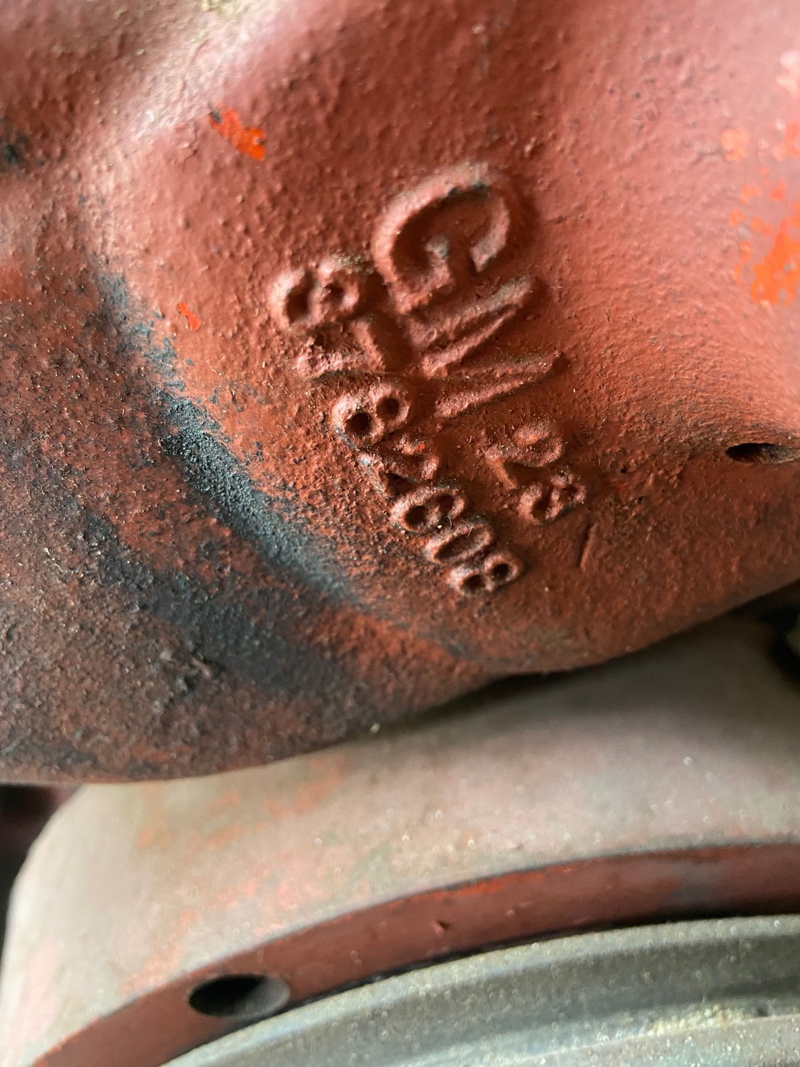

What water pump pulley mates up to a 3850838 crank pulley

I have a 3890419 but it gets into the balancer, by about 5/16th of an inch ?

The back side (block side) hits the front side of the balancer…..

Gotcha. I would check the depth of the mounting surface on your water pump to ensure that it is where it is supposed to be. My initial guess is that it got pushed back on it's shaft. Just a guess because I am not outside looking at mine.

Checked everything , seems the balancer bolt was missing and balancer had backed out some…..thanks
