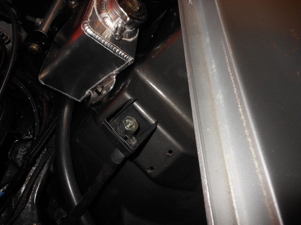

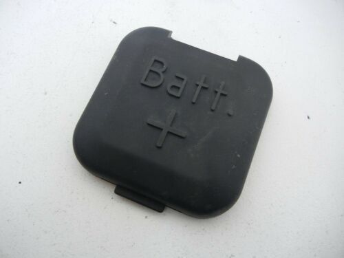

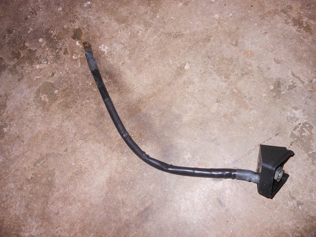

Originally Posted by Danish Shark
Do you have a picture of the terminal under the hood?
That's a good idea.
/Karsten
Yes- several car manufactures do this- when the battery is hidden away under the trunk or back seat.
Can get a really nice one at the junkyard for $5-10. The big BMW sedans (E38) are really good qallity
A lot easier to get to and less chance of reverse polarity- and when it sparks not near the fumes from the battery
Plus puts the power right where you need it at the starter .
Terminal cover

1) Safer- no fumes-battery less likely to blow up
2)Less likely to reverse polarity - damaging fusible links and alternator
3) Pulling dirty jumper cable around and over the seat- crawling around the cables to start- really?
4) Much easier under the hood- side terminals and jumper cables- are a pain
5) Puts the power right where you need the high current- at the starter
