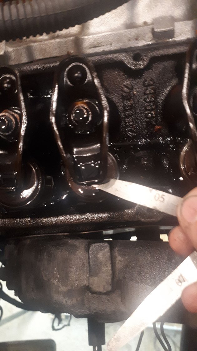

Hello,
I would like to adjust the distance between the valves and the rocker arms.
Can you confirm to me that it is good value that must be used ? I have the HAYNES book but I can't find where the procedure is explained, what's the name in English please?
thank you very much and good day

Valve lash adjustment
98% of c3 Corvettes use hydraulic tappet lifters on the cam requiring 0 lash plus a partial extra turn
Only the highest performance motors have solid tappet lifters requiring a valve lash gap like your picture

ok so is it normal that i am not gap ?

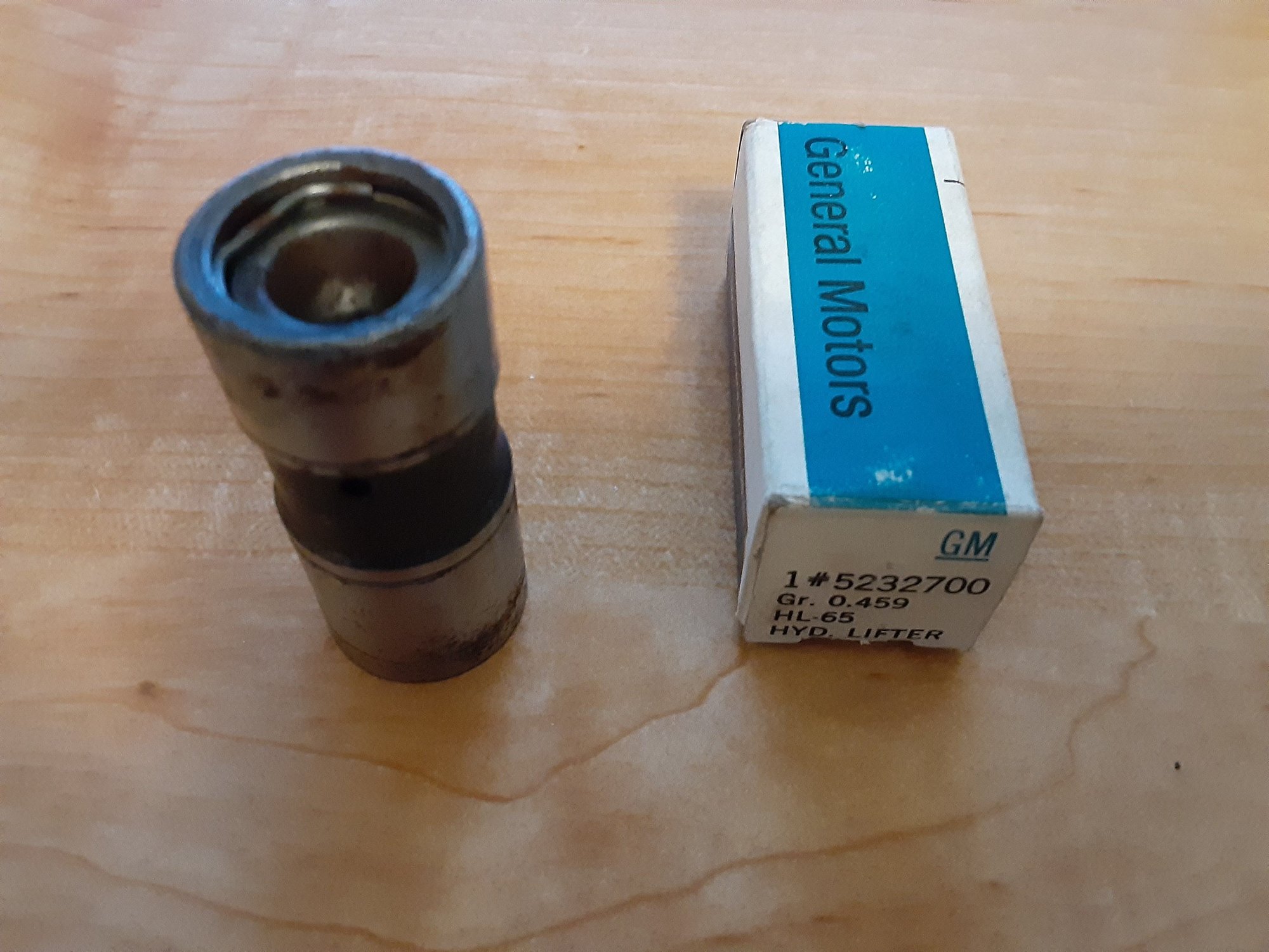

do you have a picture of what a hydraulic lifter is?
i don't know what i have on my engine.
tanks !

I checked your profile trying to find info on year of car, engine, etc. No information in your profile. Guessing by your user name you have a 79. If you have the original engine. I would lash them at zero plus half turn down.
If you have a different engine or one that's highly modified. Perhaps you need to fill us in.

It is normal that you have no gap

thank you for your answers.
here it is not easy to know the history of my car. It's only been a month since I bought it. i updated my profile, it's 74, 79 it's my year of birth.
I'll try to find the documentation you recommend.
here is the photo of engine number.
have a good day

CLA comes back as: 1974 350 4bbl. 195hp TH400 trans. It has hydraulic lifters. There is zero lash and it must be set with a lifter preload. I set them at zero lash and one half turn as others have stated on the forum.
E-Mail our member Lars, I believe he has a valve lash paper he can send you to read. You can get him at: V8fastcars@msn.com
