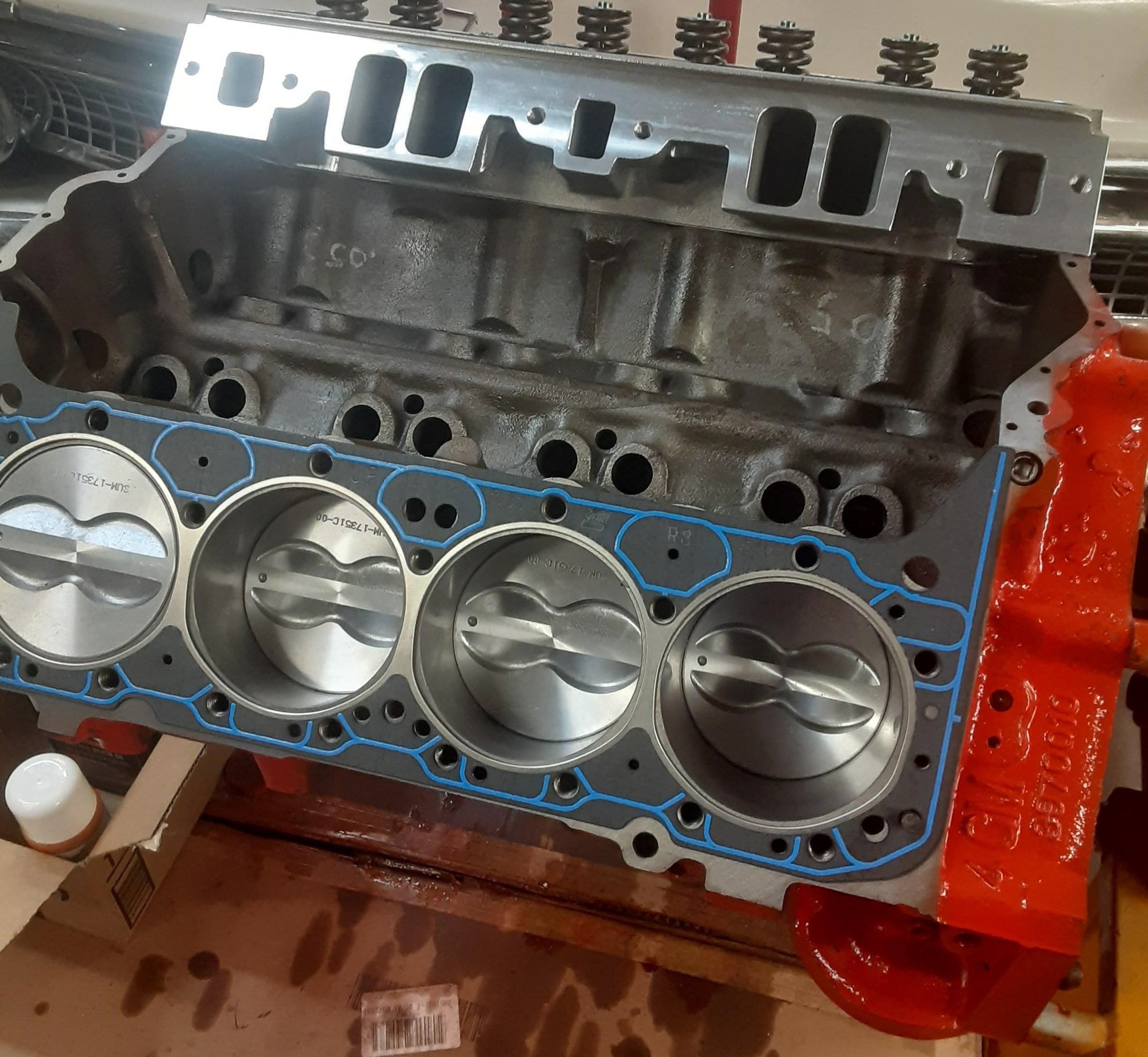

About two years ago I bought an LT-1 warranty replacement (CE) short block with all its forged components from the C3 parts section here. This was all before Covid hit and my all too busy engine builder having time for me. During this time, I had been purchasing parts for what I was originally planning on an LT-1 type engine build but without solid lifter cam. With the LT-1 being the precursor to the L82 model engine it seemed like a fitting tribute for its replacement of the existing non-original gutless engine (w/wrong casting #, 512 vs. 010 block).
My engine builder and the machine shop suggested dumping the domed pistons and going with the flattops which he did. He said it looked to him like the engine had never been fired before. The bores are 4.0” and no evidence of wear just some surface rust which he honed out. There was evidence that the engine had gone through a machine shop before though. He said the deck was off some 50 thou in the corners so the shop decked it and he said it turned out well and is now a zero-deck engine.

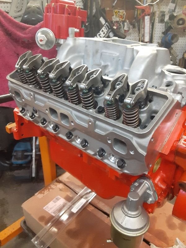

The parts list includes Summit Racing’s flattop pistons (Speed Pro’s?), Comp Cam 268HE hyd FT & lifters, Dart’s entry level aluminum heads, mostly all ARP bolts, new Performance Chevy Holley 770 carb (also bought here), old school aluminum Winter’s intake, aluminum valve covers, etc. etc.

afaik, seems 17351C piston is not forged (as OE LT1) but is hypereutectic ...
...and does not have 1.560" compression height (as OE LT1) but has much shorter 1.540" CH. That's a budget rebuilder piece.
Block appears to be decked but also appears head bolt holes may not have been chamfered with adequate lead-in.
Was Your LT1 returned to you with Your OE LT1 Forged crankshaft ? Did you Verify ?
Was this Assembly Balanced ? Have you seen or copied the balance sheet ?
JMO ... "some 50 thou" etc etc is incredible YMMV

EbbnFlow,
Thanks for the feedback,
Yep, knew they were hypereutectic, less noisy I've heard, it's ok.
Gotcha.
Good catch on the deck holes, didn't think of that, don't know if he did that before assy, I'll ask.
Forged crank still in there and looked good, so did the bearings, but he replaced them anyways.
Engine was previously balanced, but no didn't see the sheet, I'll ask.

The decking numbers don't add up if your block was out. 050. Unless you're just trying to get it closer to flat
Bad pistons. Modern forged don't make any noise even with big strokes
