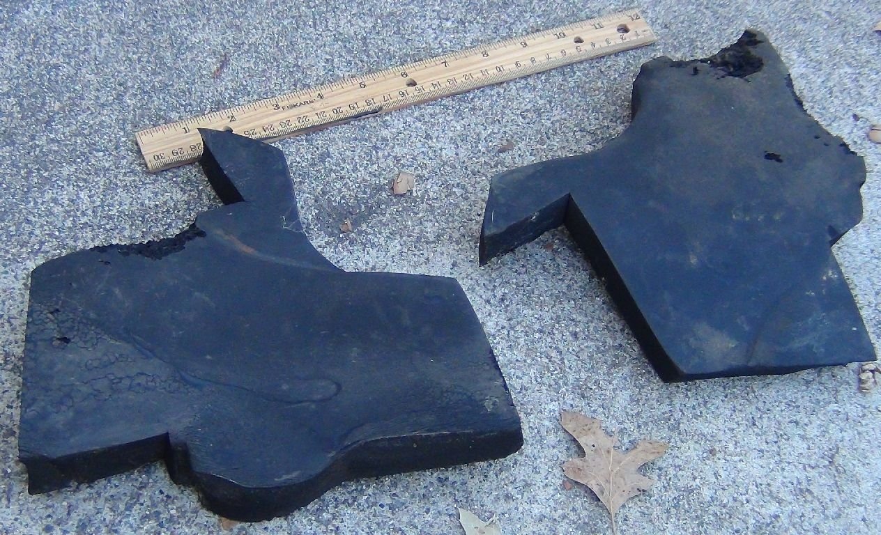

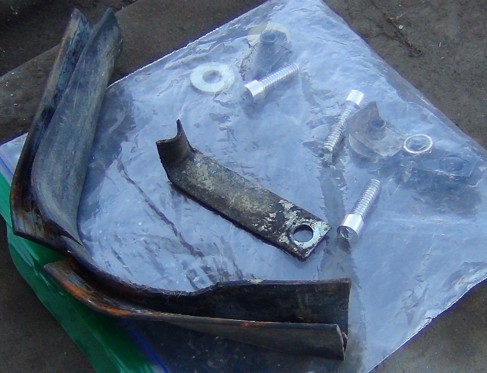

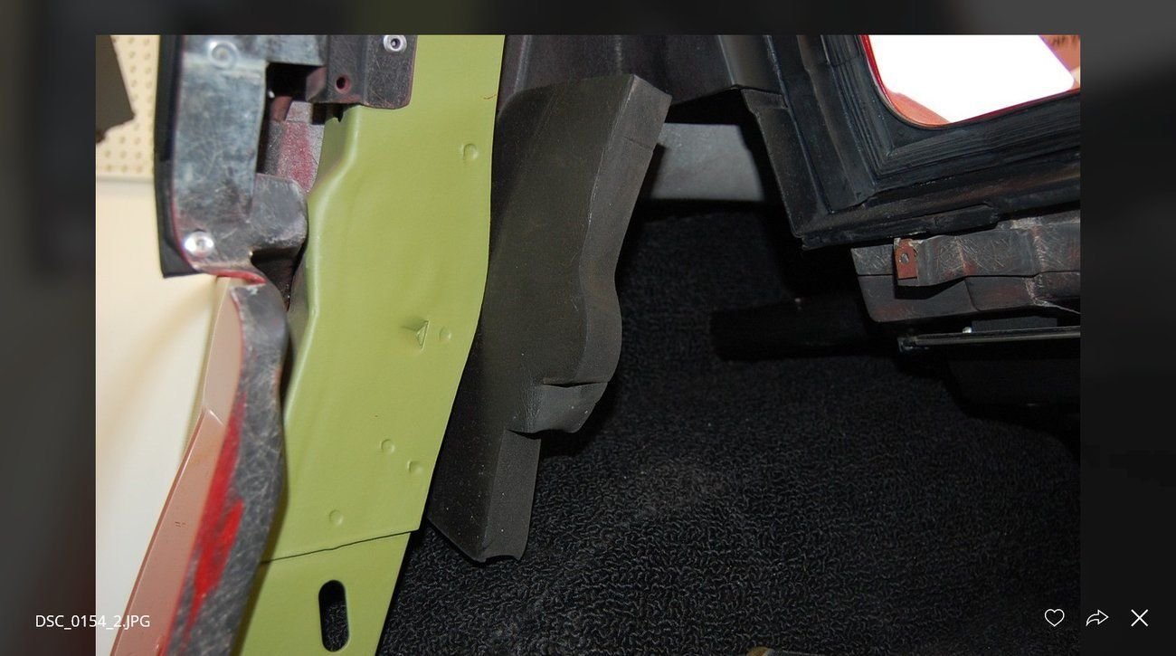

Default Unidentified parts
Okay, back to the 70 LT1.
I have identified all the parts in the parts pile except for these. Any idea?
These are thick foam pieces.
1. Some sort of rubber seal
2. A bracket of some kind, found with engine parts
3. Chrome cap bolts

The black foam block goes in this location both left and right sides.

I think the rubber seal goes on one of the inner fenders or the splash shield between the frame and under where the side fender louvers are.
Though they appear similar in size to the allen screw holding the drivers side mirror to it's bracket the chrome cap screws do not belong on a 70 corvette.

The rubber seal or gasket goes on the bracket that holds the steering column to the dash.

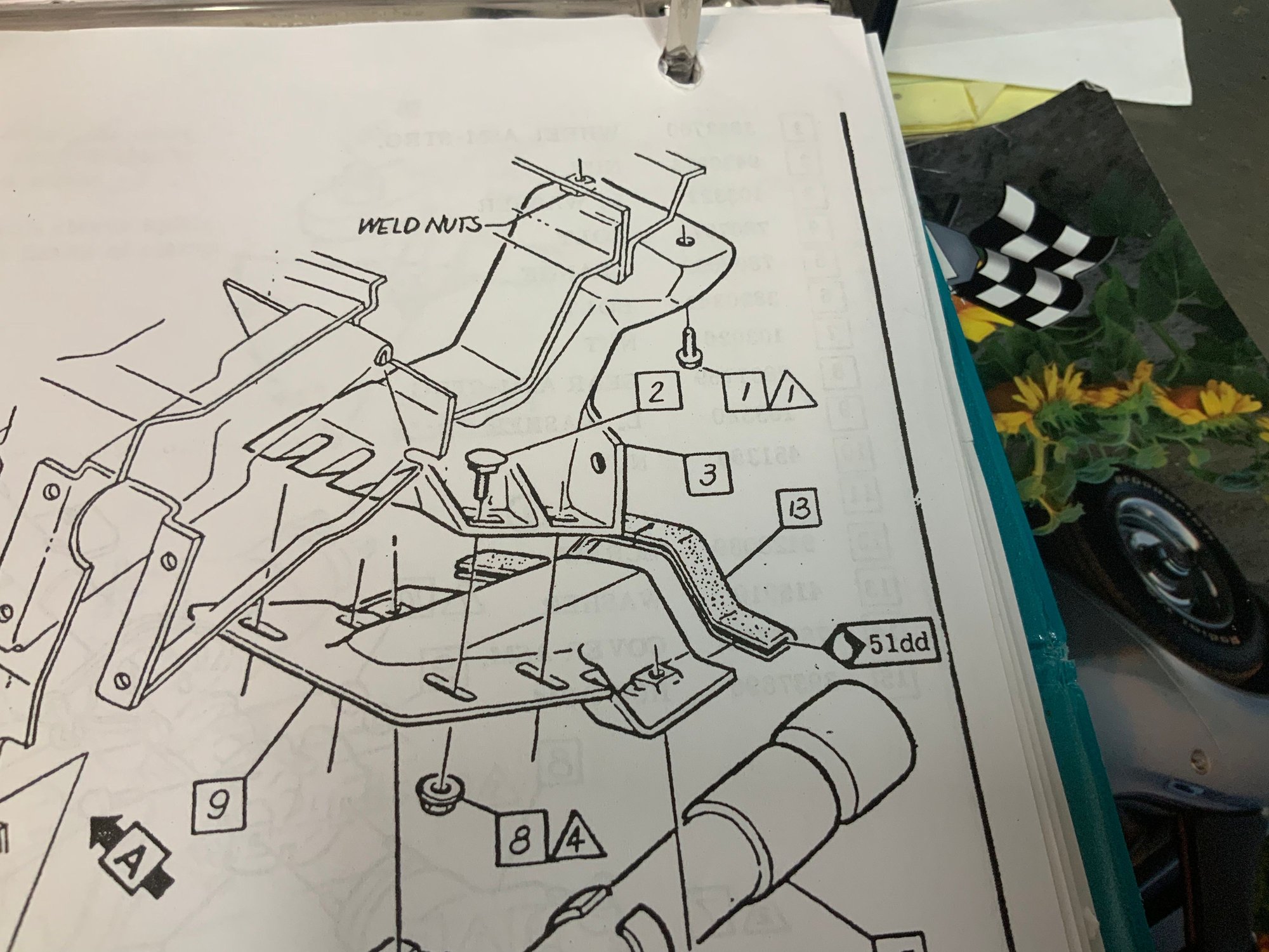

Any idea what purpose it serves?
Our the page in the AIM, that it would be on.
Would be under rear door trim most likely anti vibration. For 1971 in the AIM it located UPC Bolt Weld page L54 (Body Side-Bonding Of Body Panels To Underbody) Item 12 part number 3956231

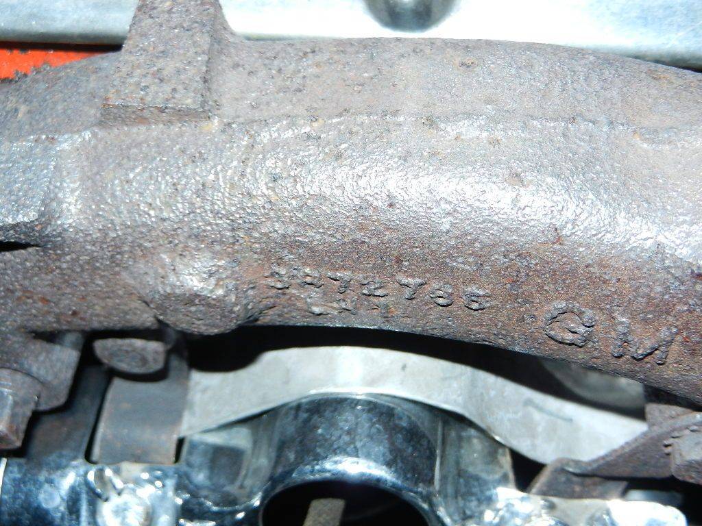

Did you see the request above for pictures of exhaust manifolds?

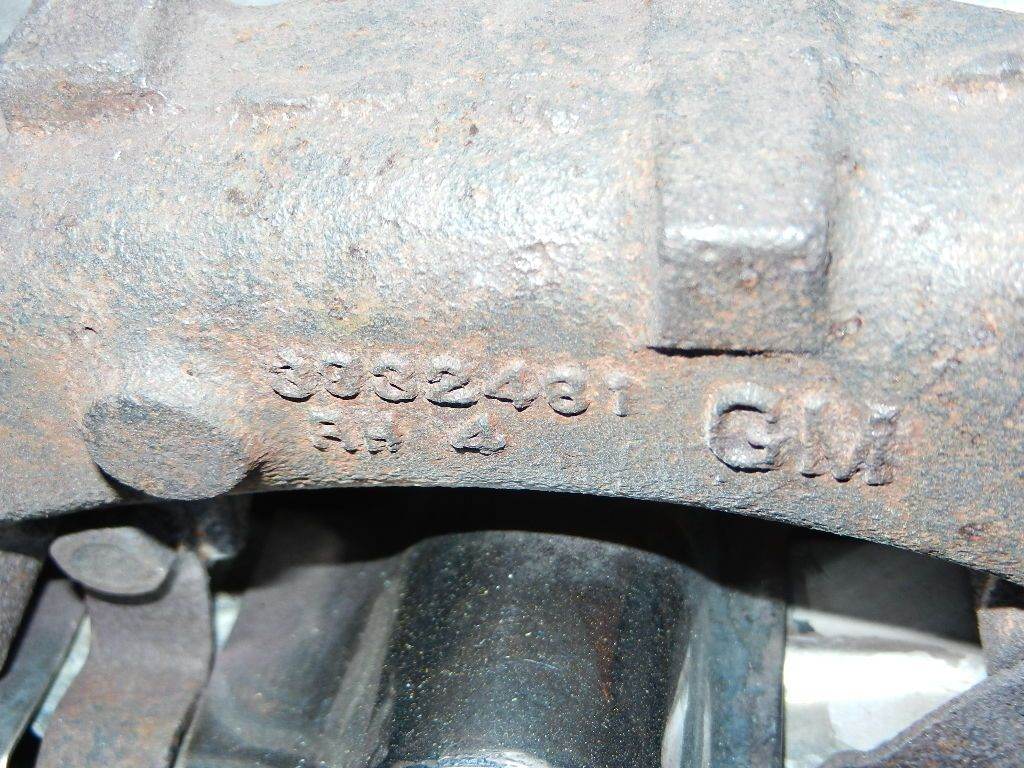

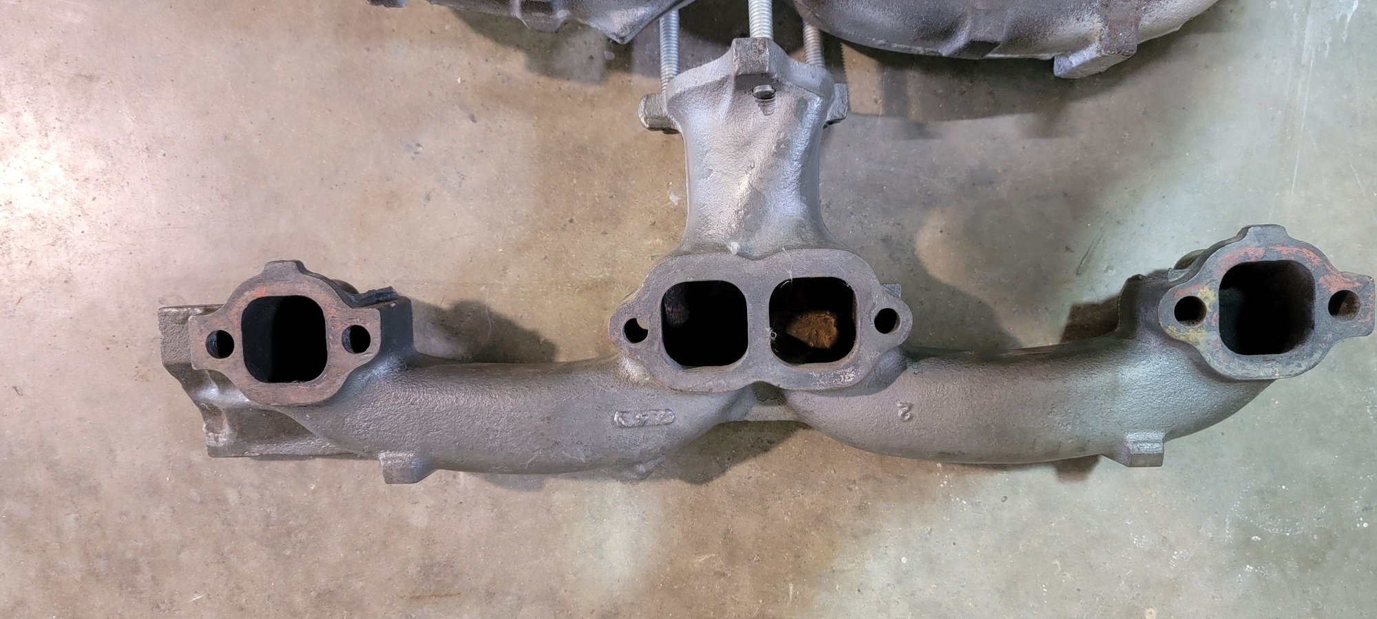

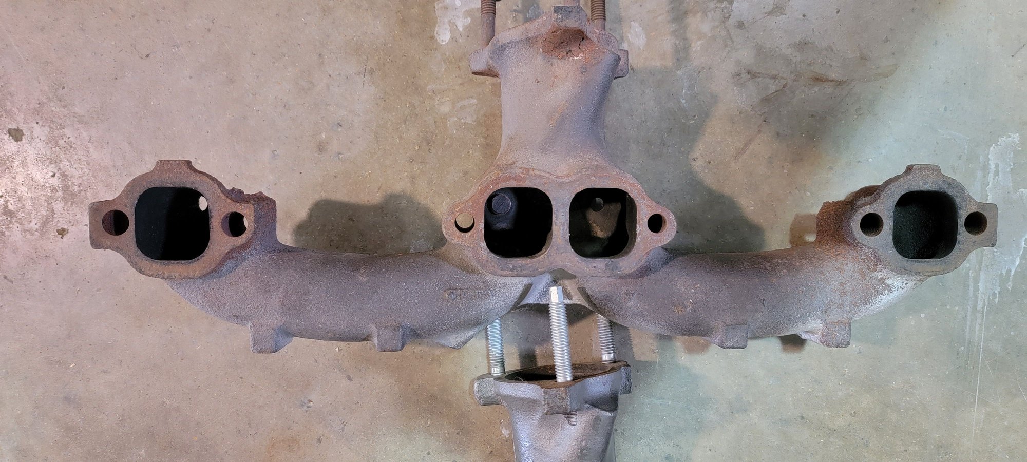

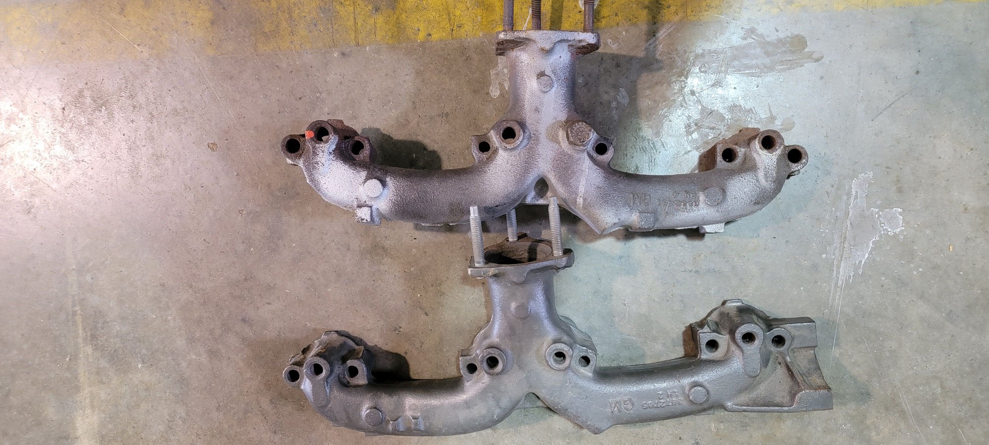

Per your request, here are pics of my spare LT-1 exhaust manifolds

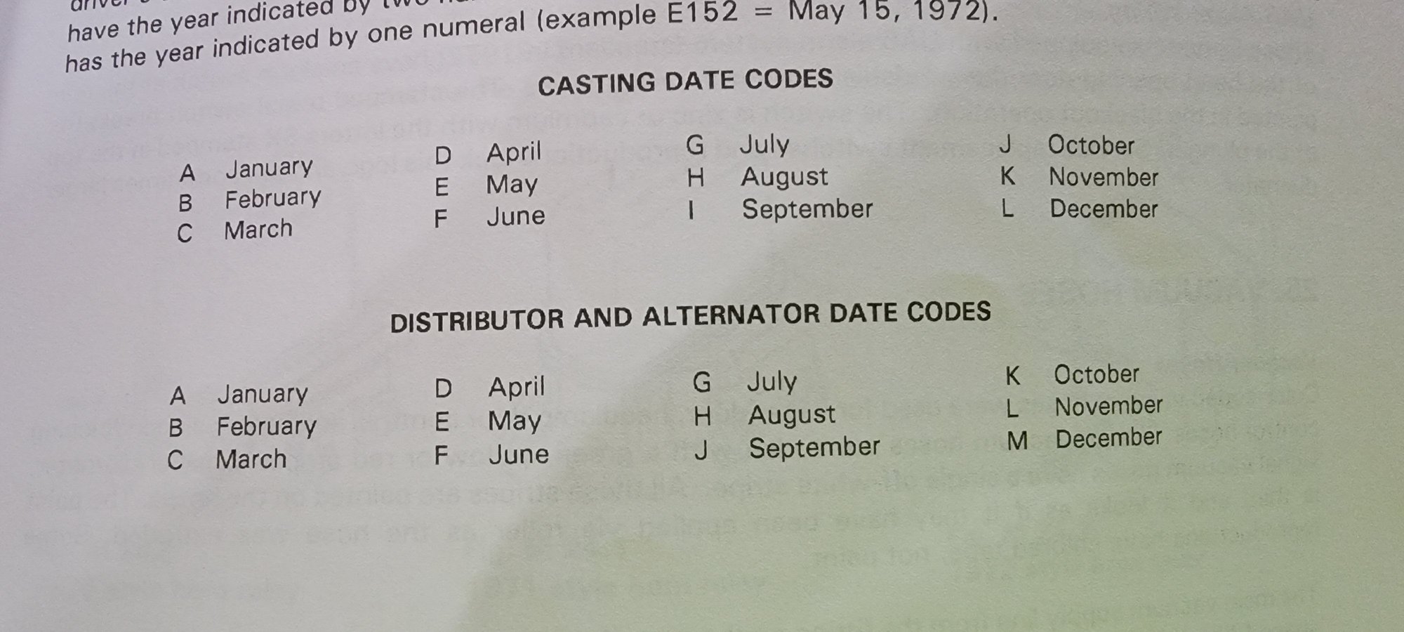

Thank you. Are these off a '70 LT1 vette? If so, what is the build date on the matching vette's Trim tag?
Can you make out the date code on the back of the manifolds?
On the front I see:
Right: 3932461 RH 4
Left: 3872765 LH 2
Any idea the significance of the trailing "4" and "2"?

Yes. They are off my Jan 22 1970
LT-1. I will have to take a close look at casting date code. Don't remember detail.
