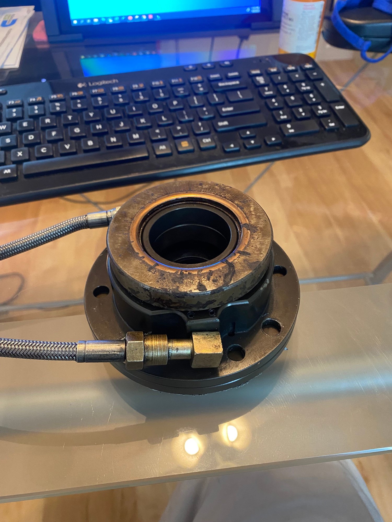

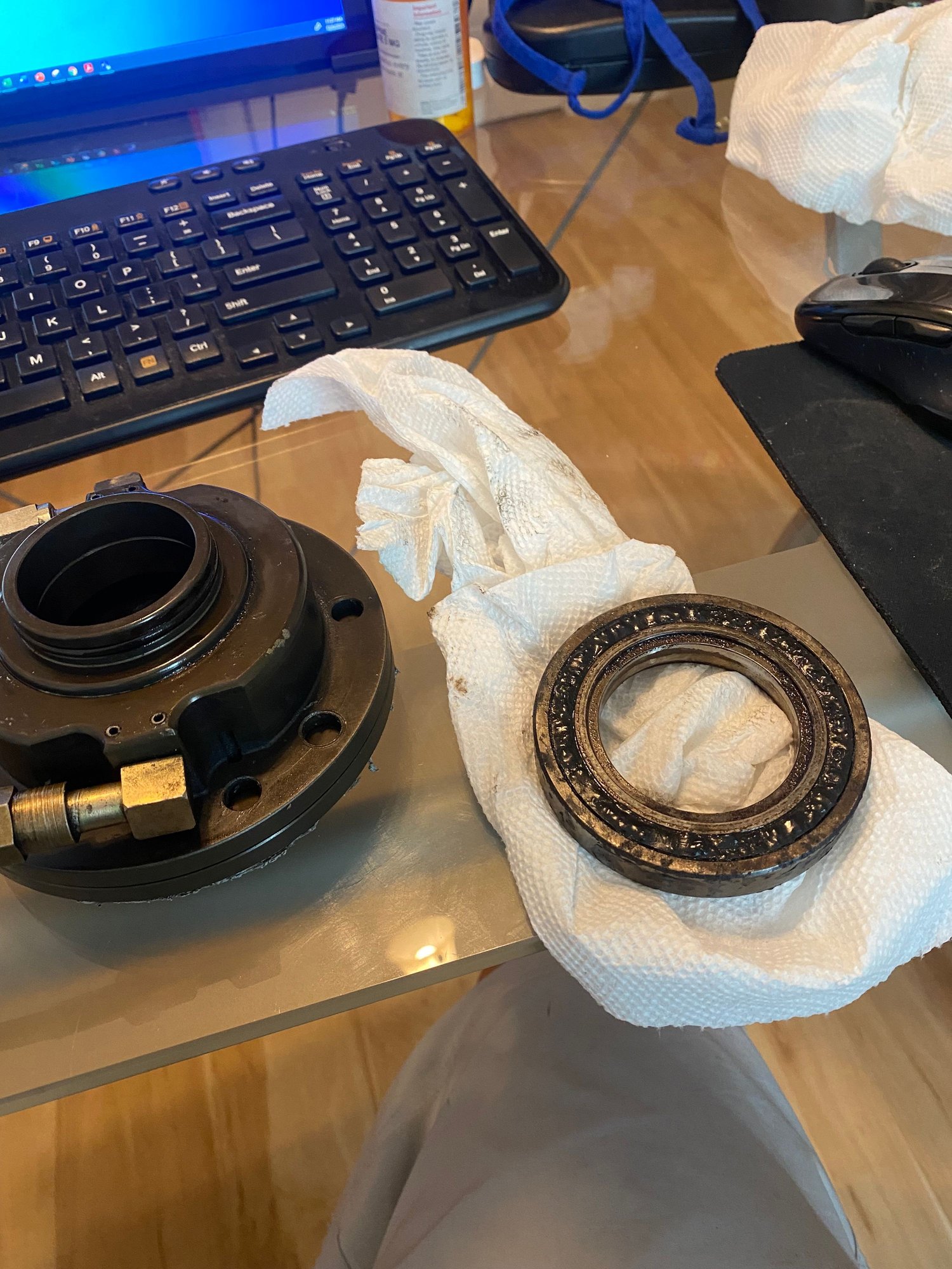

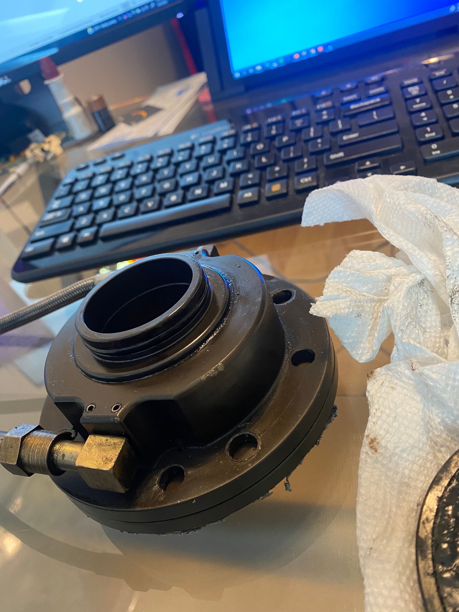

I just purchased used TKO600 that came with Hydralic bearing installed. I'm attaching pics below to see if you can provide some imput.
1. Can anyone ID what type of bearing this is? The hydralics look good but the bearing in the front doesn't so I'd need to see if I can source a replace
2. I'm really tworn between going with the hydralic clutch using this bearing or going stock with Zbar. What would you recommend?

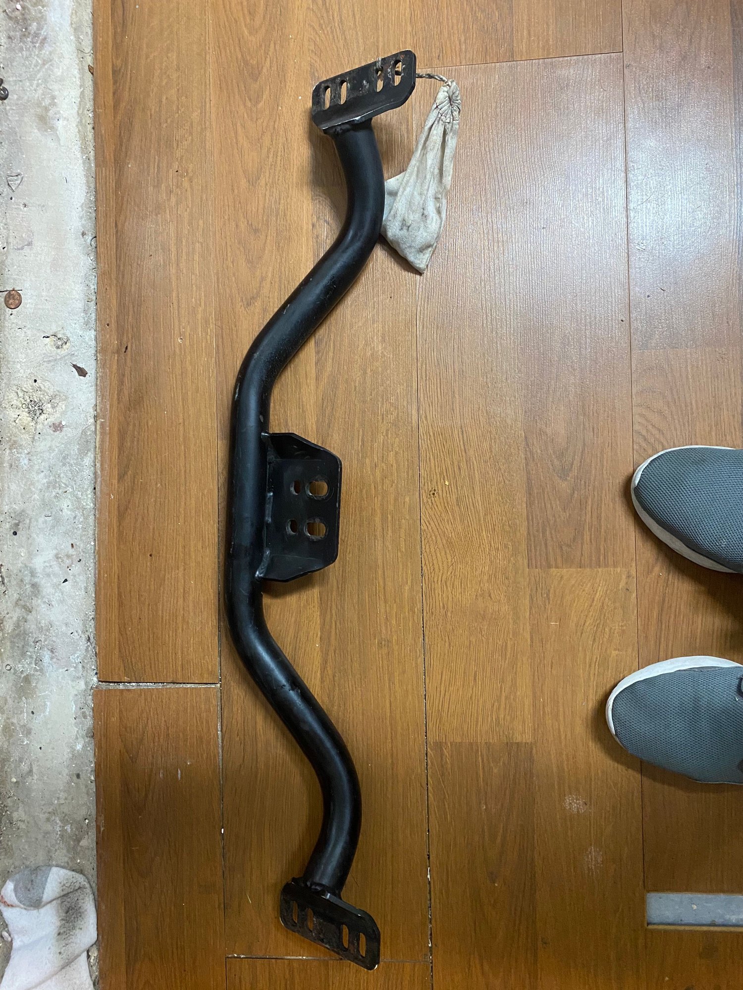

3. I also got a cross member but it's for '67 to '69 camaro so I assume it won't line up but just checking to see if anyone knows

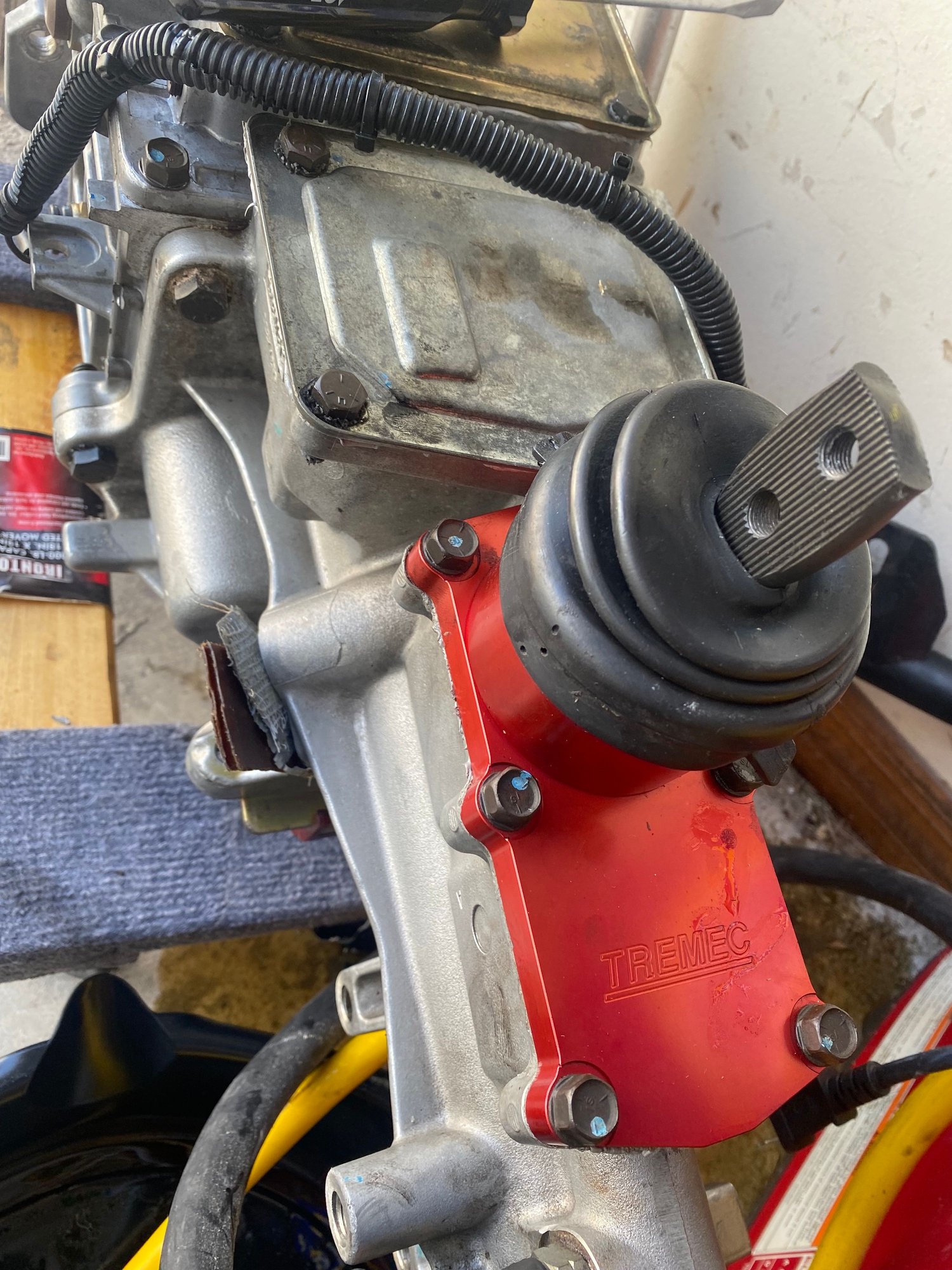

4. I need to offset the shifter to have it come up in the right location in the tunnel. Any shifter recomendations? Anyone have the offset inches required to fall in correct postion?

Agree with GKULL, The modified TKO600 for the C3 has the shifter offset towards the drivers side to place the shifter in the same location as the old 4-speed which was offset to account for the shift rods. I've seen people get around it by modifying the shift lever (welding up metal to form a right angle right at the boot and making the offset in the shifter handle), but the kits used a modified tail housing.
Might be worth calling Silver Sport and seeing if they, or someone else will sell you a tail housing with the modification pre-done.
I went with the hydraulic clutch on mine (American Powertrain kit) when I did the conversion. It works, but I'm not happy with the pedal feel (hard and right up at the top). Most likely fixable by going back in and spending more time ensuring the clutch master cylinder is in better alignment. I put it in so the rod is traveling in a straight line, but not quite perfect I guess. My point is that if you go hydraulic, spend ample time on the master cylinder install and make sure you get it right.
Wish I could help on the hydraulic bearing. Only info I can provide is that the unit is not the same one provided by American Powertrain.

Thanks. I called MDL and Silver sport but they are now only offering the machined offset for TKX not TKO. I was told that bolt on offset shifter won't work becuase the height it adds so I may need to get something welded to acheived the offset without increasing height.

In regards to the shifter offset I've just made a spacer block or modded the shifter handle to make it fit.

I used my original bellhousing and z bar, works great. I also modified the factory shifter (like you have) by cutting it and welding an offset in, both to move it across and to angle it back as original. I did still have to open the hole in the tunnel a bit to accommodate it, and used an aftermarket rubber shift boot to seal the larger hole, but the stick comes through the console as original and looks factory.

Can't find a picture of the completed shifter, but here is as I was mocking it up.

Very nice. Thank you. I'm thinking that I'll just have to cut the tunnel and make an adapter based on measurements. I have a 14 year nephew who just started welding so this will be his project. LOL
