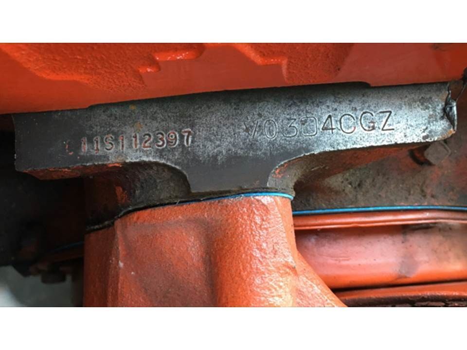

Look at numbers stamped on the block in front of the head on the right and post them here or take a photo.
Here's an example of a '71 LT1 stamp:
