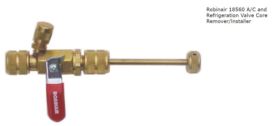

When my son was well he had, and has a tool to replace valves without loosing pressure when changing valves. Don't ask me how it works , but I saw it over and over. Was amazing to watch.
Dom

Yes, a friend of mine who used to work home air conditioning had the same thing, never knew how it worked either.........

Those are nice to have.
