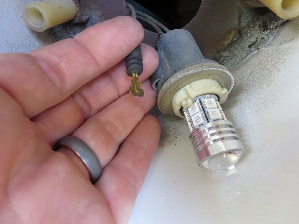

I found a failed ground inside a tail light socket. Perhaps the input has failed in yours? You can pierce the insulation and test with a needle-tipped test light, or a test pin/Exacto blade and multimeter, and see if you can find where the power stops flowing. I ended up replacing all of the sockets.
