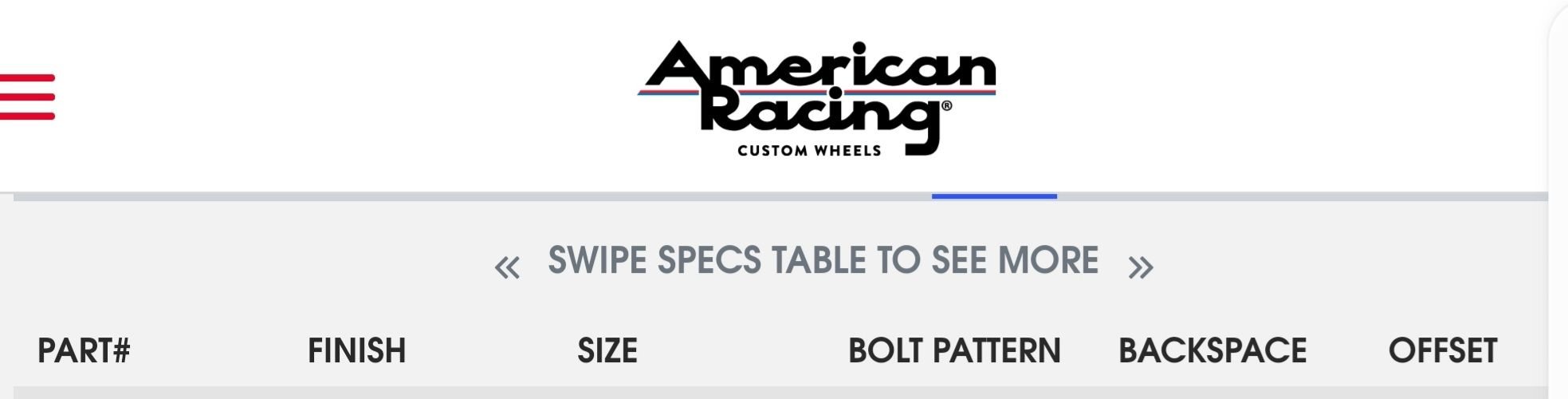

I'm also in the market for similar new tires and wheels for spirited driving but not auto-cross or track. Hopefully, the OP won't mind a few similar questions too.
Michelin Pilot Super Sport 275/40R18 tires are what I'd like to run on my 72 C3 with VBP Performance Plus suspension.
I'd like to use an off the shelf wheel from American Racing.
Is the 18 × 9 the correct wheel or should it be the 18 x 10 or something else entirely?
Keeping it simple, I could probably settle for 245/40R18's on 18x8 as that would allow better tire selection than the current 15x8 steel rally wheels allow. Not many decent 245/60R15 tires left and none are up to the Pilots etc.
Struggling with the Back Space and wheels sizing. The more I've read the less I know.
Thank you

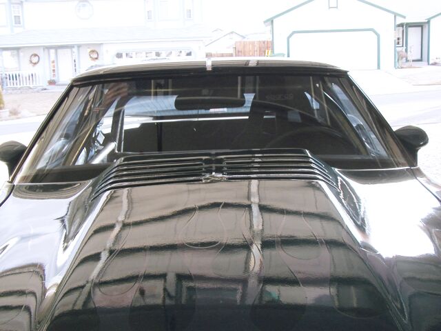

Seeing around the carb / hood scoop seems to be the biggest issue we have here! LOL!
Yes, big motor intakes require taller hoods. Which does block the view.
