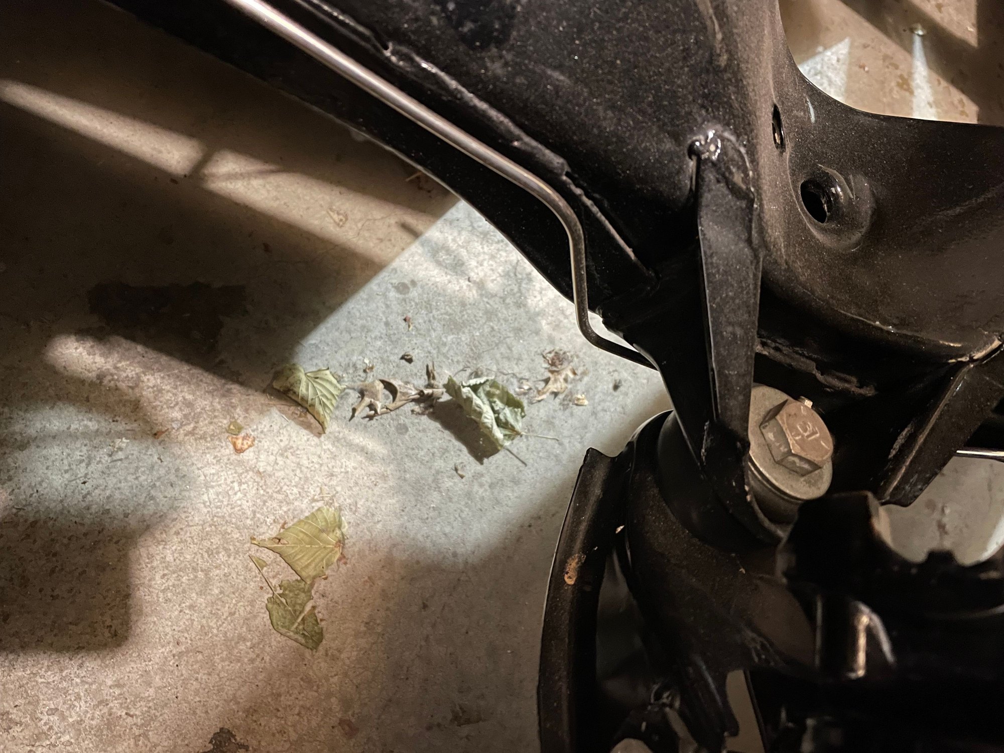

Hey guys,
so last week I started the vette and when I pushed the pedal, further travel than normal and the brake light came on. Turns out one of the seals on my right rear caliper had torn and all the fluid had leaked out. Rear MC was dry.
so I replaced the caliper, recentered the proportioning valve by stomping on the brake(light went out on dash)
but I cannot get any fluid to the caliper. When I use my vacuum pump it just holds a vacuum. I had tried letting it sit for 24 hours with the bleeders open to gravity fill it but the level in the MC doesn’t change at all.
I think the proportioning valve still has fluid cut off to it, but I thought I had centered it and the light is off on the dash.
i can bleed the left rear caliper no problem. And if I crack the bleeder and push on the brake fluid squirts out of the left rear. Fronts are the same way.
Any thoughts or ideas to try?

The fact that you have fluid & pressure at the left rear means that the line going to the rears is fine right? So the prop valve is not the issue here.
I think I would back track at the right rear. If both bleeders have zero fluid, then back track to the steel line. Just barely crack that open. Push on pedal.
Still no fluid? Back track to rubber hose and so on.
that was my understanding of the system, thanks for confirming. If I can bleed the left rear then I should be getting fluid to both rear lines.
I think you all might be right with the hose, if I crack the steel line to the caliper I still get no fluid. I’ll check the hose next, it looks to be very old and has a slight bulge/bubble on one side.

Well I replaced the hose, and no change. I ended up using the tubing from my vacuum pump and filled the caliper myself. After I filled it I was able to bleed it with the two person method just fine.
I have no idea the root cause, I am assuming I just had an air lock case, maybe it’s from the specific caliper design. The replacement is duralast brand. Or maybe the hose did have something to do with it and it just wasn’t immediately obvious.
thanks everyone for the ideas and tips.
