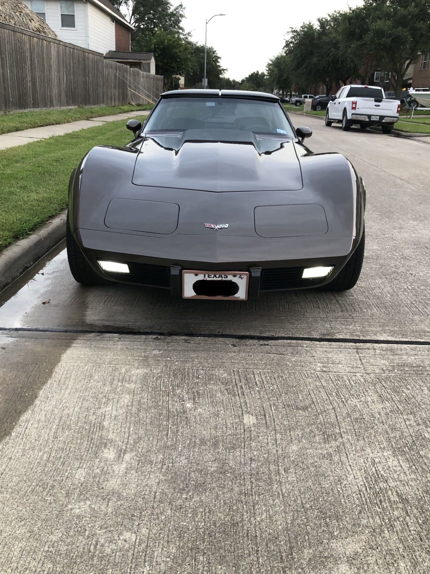

FWIW, here's my 79 with 1157 white/amber switchback LEDs. It's getting a whole new wiring harness, so no point documenting that until it is done. Hopefully I'll just tack it onto @G-Sting's 79 thread.
Looks good and bright, Bikespace!

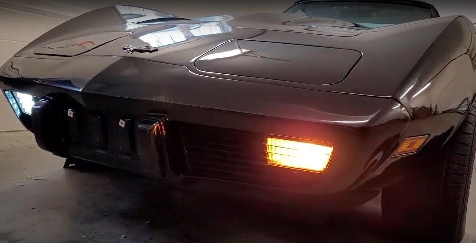

Bikespace thank you very much for posting this info . geeze , i have been racking my brain for the past few weeks trying to figure out what is going on with my 1980 VETTE i converted my 1980 a few weeks ago everything worked perfect , as shown in the video below , , now when the headlights are on the turn signals do not work . but if i pull the bulbs from the side turn signals , the front and rear signals work with the when the headlights are on . i replaced both FLASHERS with the ELECTRONIC flashers w/ the reverse polarity . i used 194 LED bulbs in the side turn signals should they be a different type ?

Originally Posted by 1980 BLACK VETTE
Bikespace thank you very much for posting this info . geeze , i have been racking my brain for the past few weeks trying to figure out what is going on with my 1980 VETTE i converted my 1980 a few weeks ago everything worked perfect , as shown in the video below , , now when the headlights are on the turn signals do not work . but if i pull the bulbs from the side turn signals , the front and rear signals work with the when the headlights are on . i replaced both FLASHERS with the ELECTRONIC flashers w/ the reverse polarity . i used 194 LED bulbs in the side turn signals should they be a different type ? https://www.youtube.com/watch?v=vvDEPqhDgEs
Welcome to the Forum, and thank you for posting a video! That always helps.
I realized I did not do the best job explaining the reason, but the problem with the front side marker lights is that when the headlights are on, current needs to be able to flow in both directions as the turn signals operate. That can't happen with most LED bulbs. You may be able to find bi-directional LEDs (basically two LEDs sandwiched together), but I didn't pursue that when I made the modifications to my car, so I went with the Blinker Genie solution as shown around post #19.
The simplest thing to do is to replace those 194 LED bulbs with 194 incandescent bulbs. That should fix your problem.
If you're stubborn lilke me, and insist on LEDs absolutely everywhere, you'll likely need to implement the Blinker Genies, bi-directional LEDs, or a DIY solution with two LED bulbs in one holder.

yes i put the old 194 back in and same result . its odd that everything worked perfectly at first then a week or so later the turn signals no longer work with the headlights on

no i just used LASFIT 1157 . where should i find the grounds ? sorry i am not good at this electronic stuff . learning the hard way i guess .

I took another look, and it seems that these 194 LED bulbs are bi-directional.
https://www.superbrightleds.com/cata...se/category/2/
They state in the specs: "Polarity sensitive: No"
I could order a pair and try them without the Blinker Genies in my other C3.
That doesn't help you, though. With the incandescent 194 front side marker lights, LED compatible flahsers, and any 1157 bulbs, it should just work. Those Lasfit bulbs are not switchbacks, as far as I can tell, but do claim to be bi-directional, which shouldn't matter in that position.
Perhaps switch to incandescent 1157s in the front, too, just for the test. If that still doesn't work, Id look for loose wires in the sockets, or in the front harness. I think there is somewhere in the front harness where the ground is connected to the chassis, but I'm not sure where.

i was just down in the garage messing with it and this is whats happening https://photos.app.goo.gl/nrLMQHixRgrfdCmw9

I'd 100% suspect those front 1157s at this point. Can you swap in the old bulbs to test?
Perhaps I just got lucky with the 1157 switchbacks I used.

i will try the old bulbs again and see what happens . did you see in the video that with the lights on and left turn signal the right front was blinking and nothing worked innnnnnn the back
