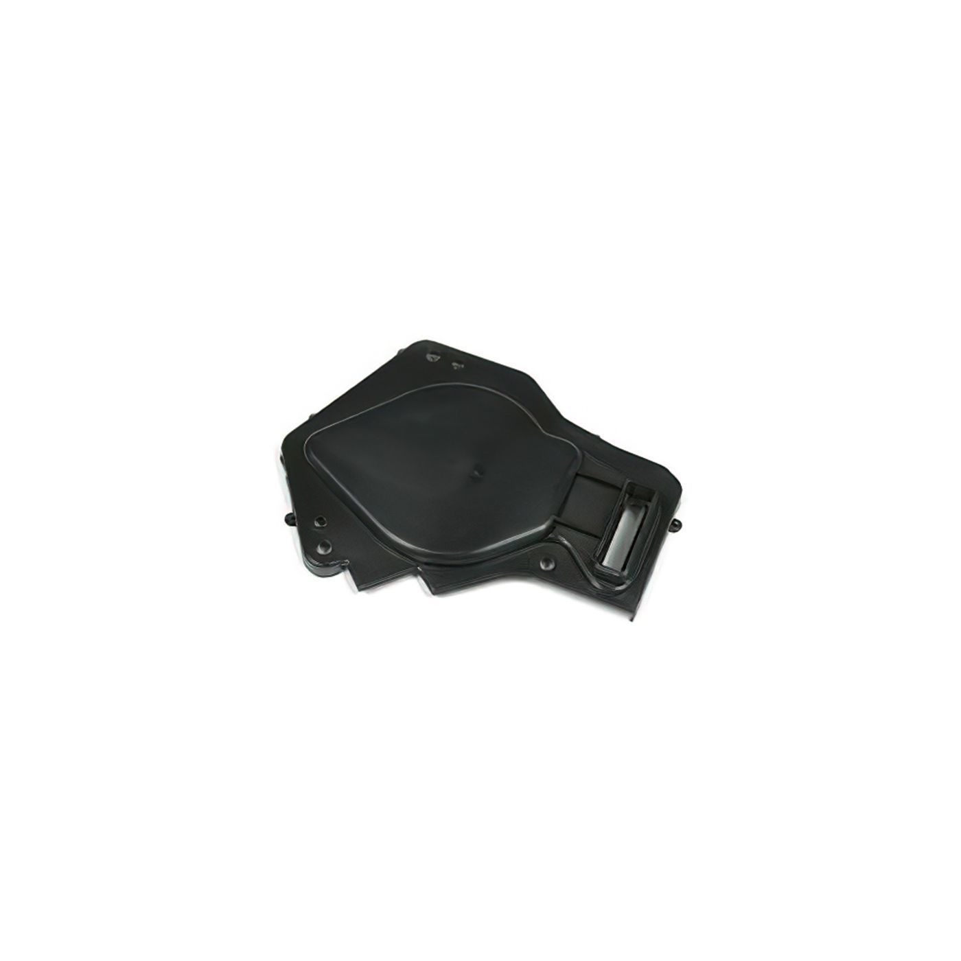

If you are not going with the mechanical pump- you can use a universal washer pump- then use a 75-82 cover on the motor- it'll clean up the maze of hoses coming off the wiper.
