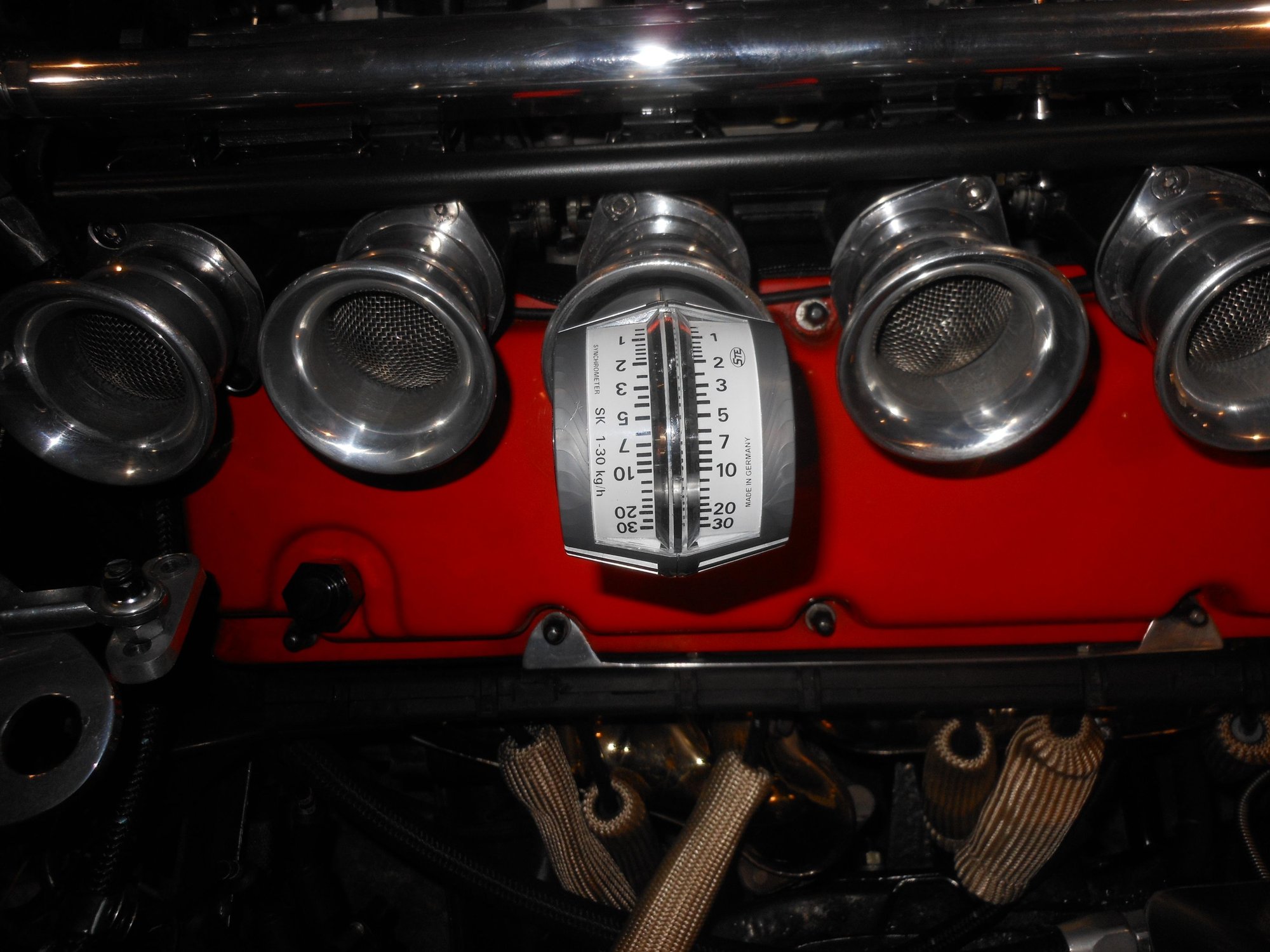

Originally Posted by Richard454
Here's another pic I took that really shows the engine rake off- I'm thinking definitely a plexi- hood section now!!!

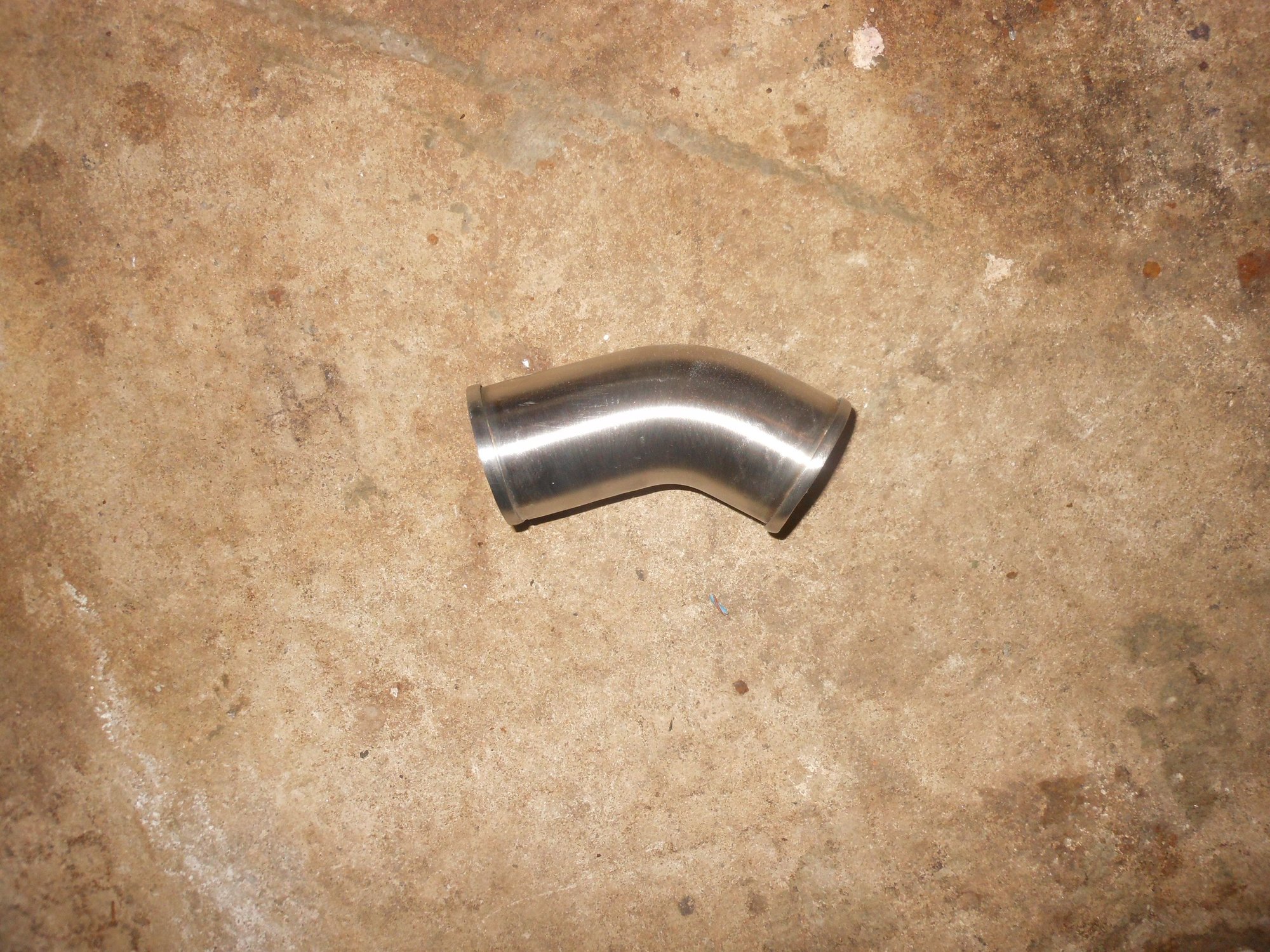

I fixed the SS pipe thay puked all my antifreeze-
I had used a 1 3/4" SS exhaust pipe pre-bent- as the BMW waterpump has a 90ş bend and couldn't find any hoses that were close- thought it wouldn't come loose...but I was wrong!!!
Saw some neat tools on Youtube on how to make a flange ....but I don't have a bead roller- plus stainless is a little tough to just bend!!!
Laying around- I had a piece of 2" SS pipe- so I cut about a 3/8" piece off with my trusty angle grinder. Then fitted it just like a piston ring around it - had it a little more than 1/8" proud of the smaller pipe.
I welded a bead around the inside and then hit it with a grinder- followed it up with some 120 paper - worked great!!!

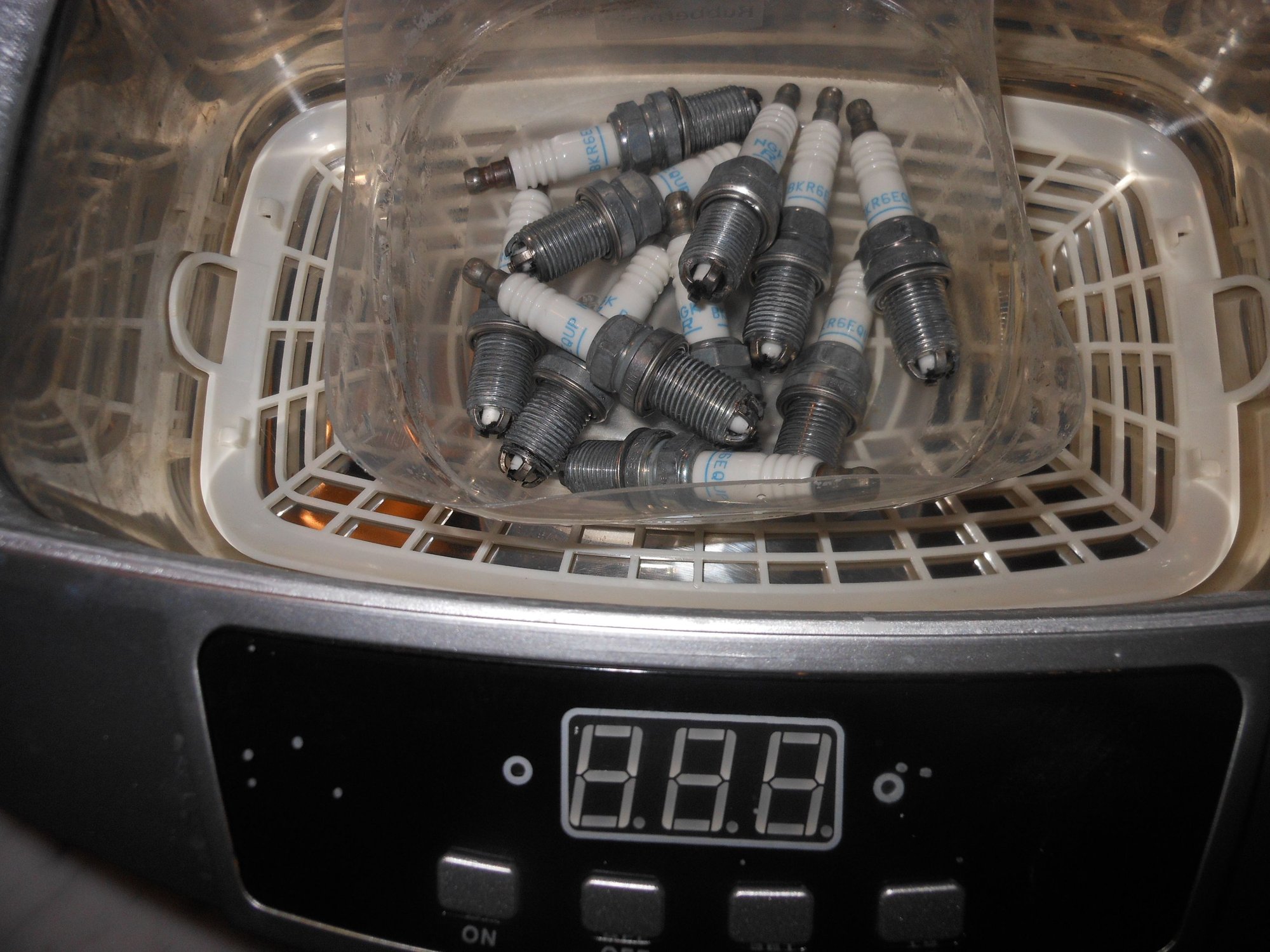

I cleaned the plugs with my ultrasonic cleaner- in the past have been using plastic zip lock bags to put the cleaner & part(s) in and filling the rest with water
For the plugs I had really good success with using a plastic container- cut the edges toi fit- filled it with the cleaner and rest with water. Uses a lot less cleaner and easy clean up.

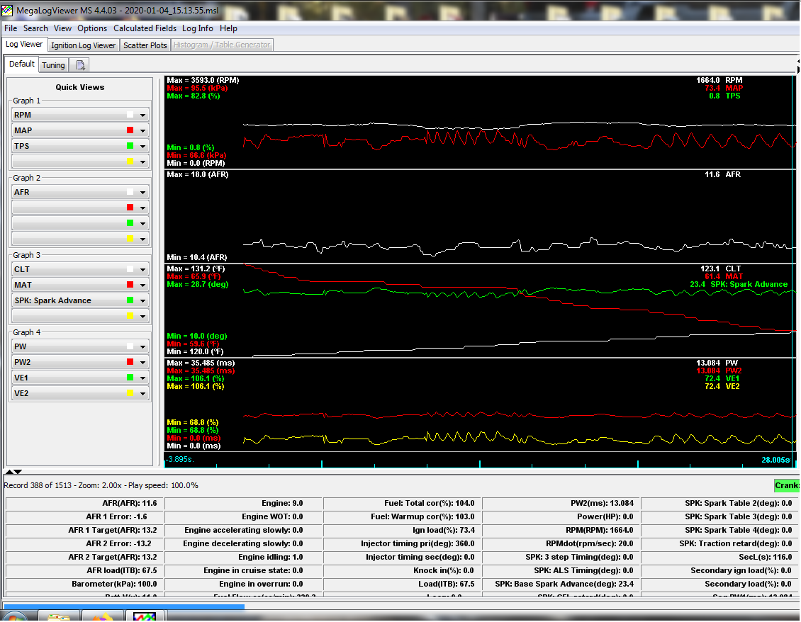

Ran it today- lite right up- and got a little bit of logging in- but pulled the plugs and they have carbon on them....Crap....
So spent most of the evening reading over my tune - how to tune - youtube on how to tune...the owners manual...
Anyway- I had the O2 sensor not doing any correction-which it's supposedly just used to get the engine started-then turn it on...so I changed that and will try the auto-tune feature tomorrow.
I am also concerned that maybe the plugs are not getting a good spark- I've got an extra set of LS coil wires and will try bypassing the longer set I made up- and see if that helps...
Stay tuned- pun intended!!!
ultrasonic cleaner trick-

The start-up log...not bad...as far as I can see or understand...

Hey Richard, I'm far from an expert on tuning but isn't 11.6 AFR pretty rich for not being WOT? My Hemi runs between 13 - 15 at a steady state then at WOT goes into the 11's. Just a thought, maybe not a good one though
Hey Tony-
Yes- you are correct it is high...the mixture is supposed to be a little rich till coolant temp (CLT) reaches 160ş- it wasn't there yet-
As I (and I'm sure you have too!!!) find it's usually more than one thing messed up when it looks like an easy fix!!!
BUT a few of the plugs were not carbon covered...so that's why I was checking the spark - vacuum leak and my tune set up.
When I did rev on it -it went lean- so I have some work to do...but I have it running - supposedly the rest is easier...I hope!!!

I assume you checked your 12 injectors for balance. Anyway, I wouldn't worry too much at idle or when the engine is not up to temp as long as it's running well. At Idle it could be the injectors are not even or the throttle opening not being exactly the same for each cyl. Nothing to sweat about IMHO. Get it on the road, up to temperature and some load, do some logs and then check the plugs after.
I forgot if you had a log manifold or separate exhaust manifolds. If separate, then shoot a temperature on them to see how close they are. Back in the day, I used to log an EGT for each cyl, but I only had 4.
