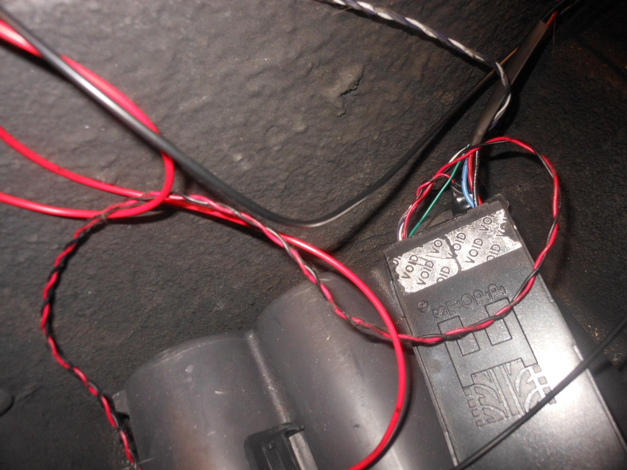

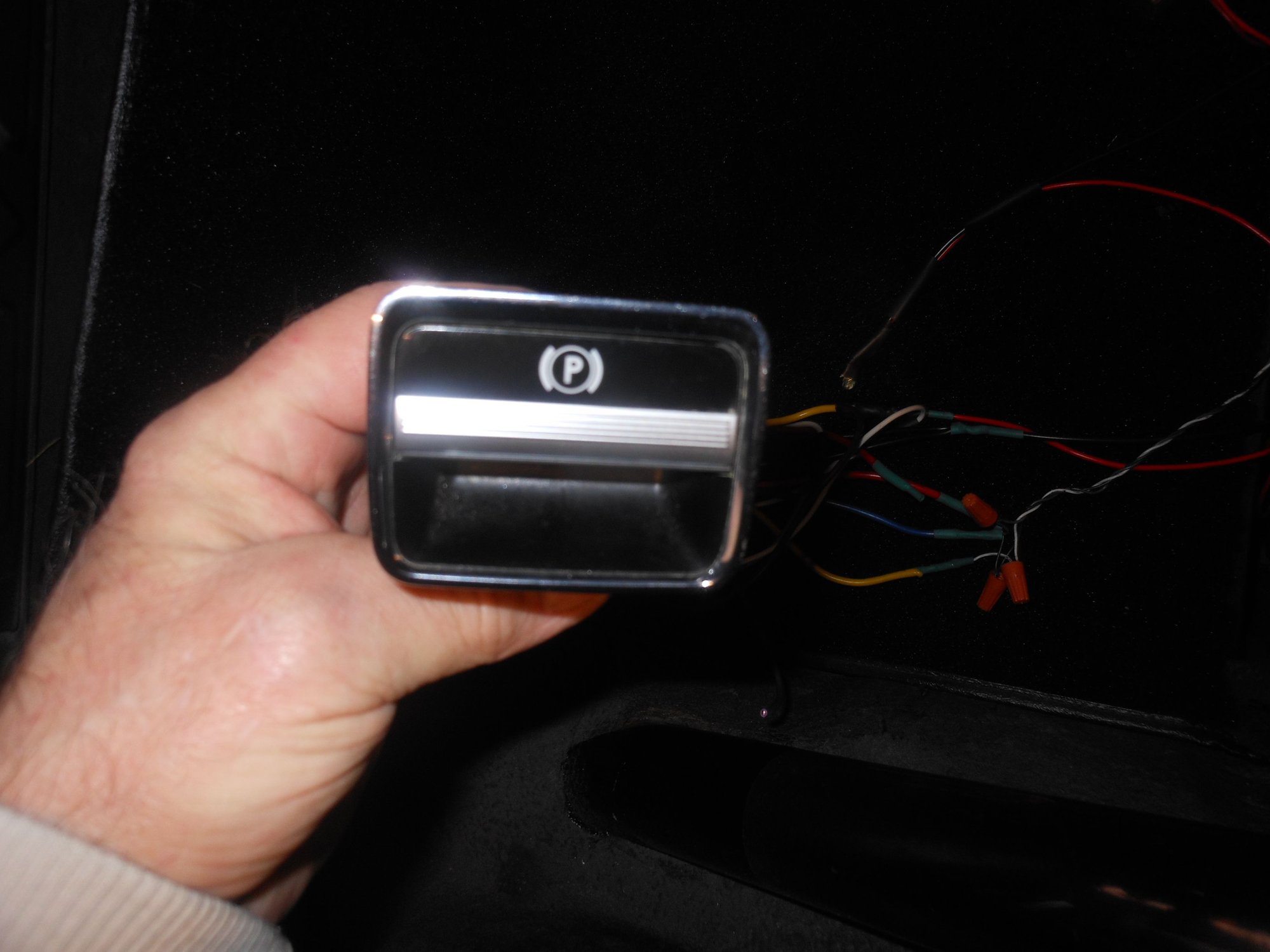

Working on the wiring....
Been messing with a solution for a while on this one-
I have a E-stopp electric barking brake- the guys at E-Stopp would not give me ANY information on how to "customize" it-
Told them I just wanted to "change" out the switch- but no luck.
Even had a buddy of mine stop by their booth at SEMA and see if he could get any info...Nope!!!
Their switch just looks out of place in my interior - also have a nice looking billet one- but still not my cup of tea.
So- I just cut the "void if removed" sticker and looked inside...cut up some wires and figured out what was needed to incorporate a Mercedes Benz S550 electric parking brake switch-
A couple of Bosch relays and I'm there,
Pull out- disengages the parking brake- push in the button and it engages-
https://youtu.be/hr0-AeuPCHQ
Will look good mounted on the lower dash-
Opps- I guess it's out of warranty!!

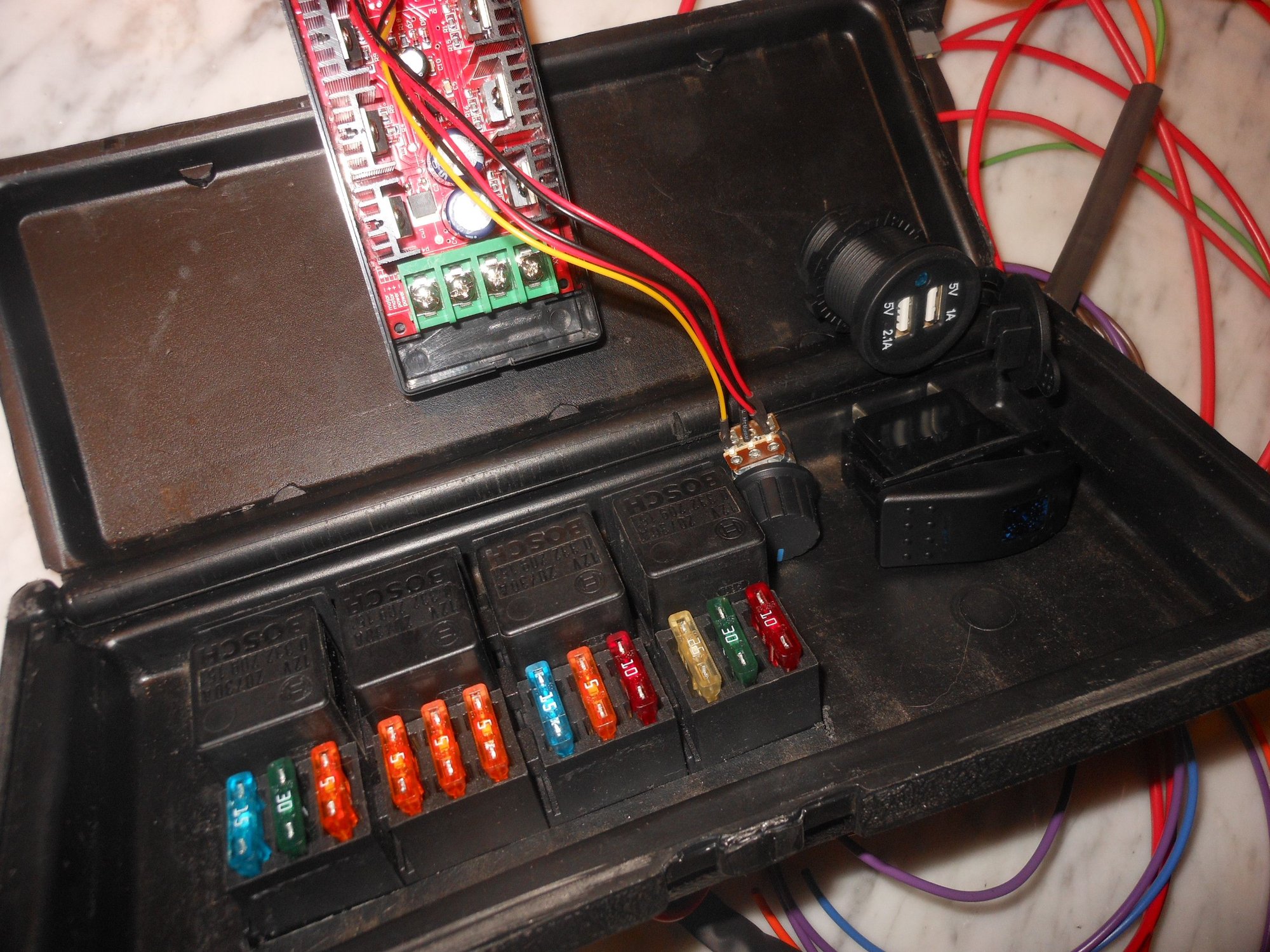

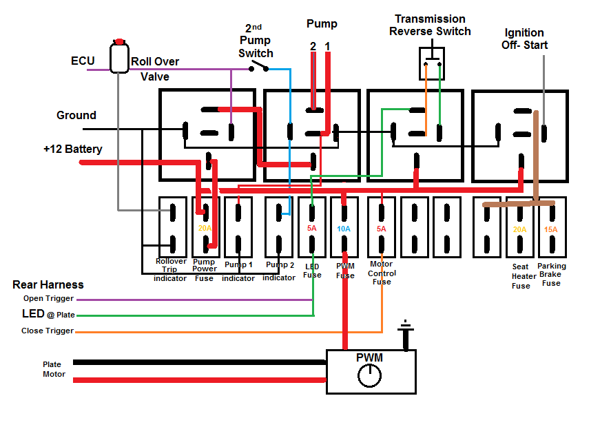

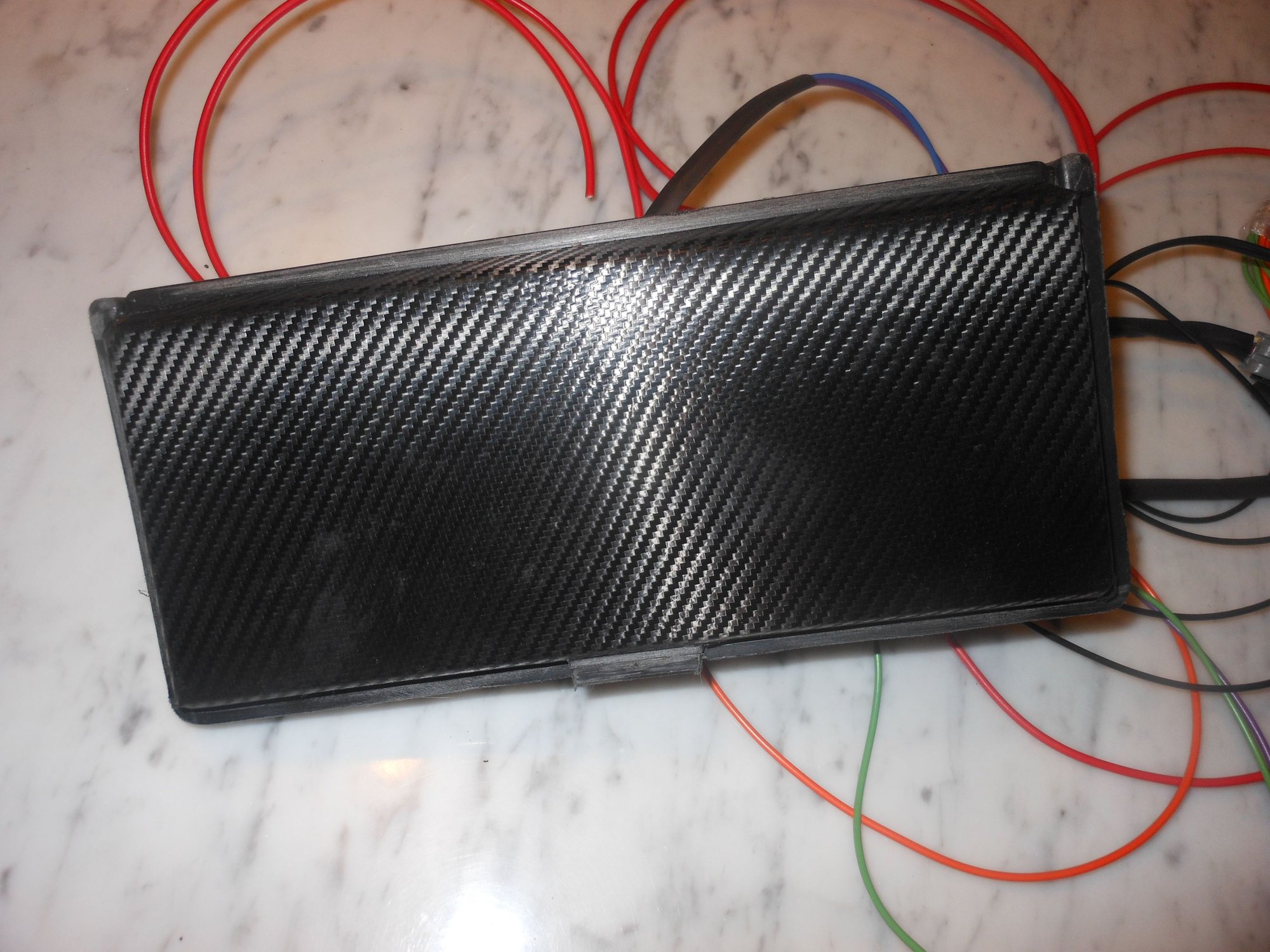

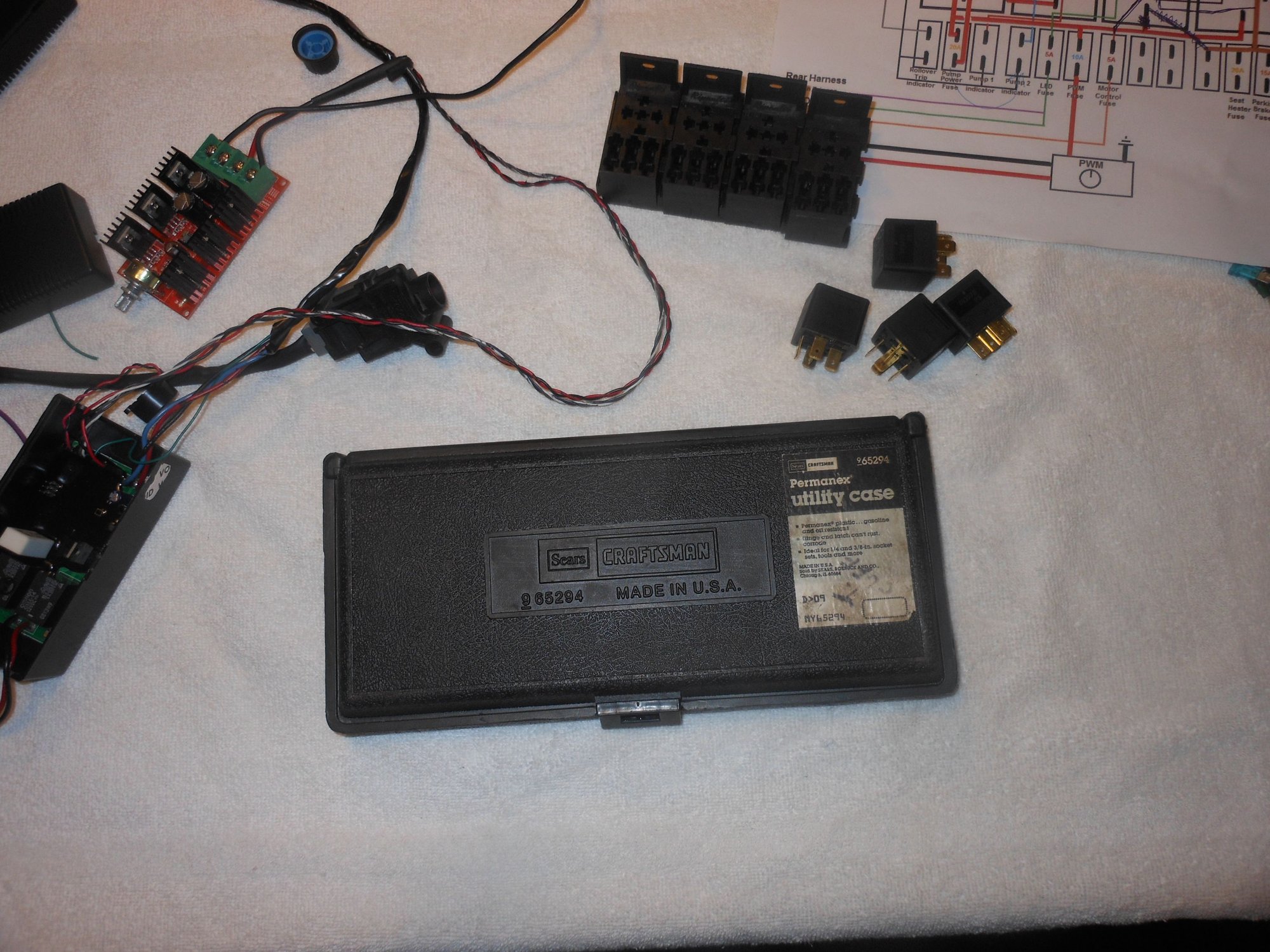

Here's my rear storage compartment relay bank-
Started out as a craftsman socket holder!!!
3M Carbon fiber wrap
Relays - fuses- fuel pump switch( to switch between primary and back-up ) PWM control for plate motor- and USB charger plug
The fuses light when blown- and three 'blown" ones to tell me the fuel pump is on(one or two) and if the roll over inertia switch is triggered. If the car won't run- in seconds I'll know if the pump is working
I'll label the box-as far as fuse size and what it controls-
That looks like the same Mercedes E brake switch I set up for my buddy. I designed and built him a controller that runs off that switch to open and close Tesla E brake calipers (actually made by Brembo) he is installing in his 56 Belair.
The way I set it up, the LED behind the switch bezel lights green if the brake is open previously, it lights red if the brake was closed, it flashes orange if the brake is changing states. It also has an interface to the reverse lockout circuit so the Ebrake can never be applied when the car is moving, if I remember correctly.
That switch fits nicely with the Belair interior. Very cool.
Yep- I was rethinking how to keep the e-brake from "working" while driving down the road too. The E-Stopp ECU has an ignition input- which I didn't like the idea of "just in case."
SO - I used a PAC TR7 module to time out- and ONLY be operational if the brake was on. So parking the car- put your foot on the brake- pull the M-B switch and it locks down the parking brake. And only will release if you apply the brake and push in the M-B switch.
AND if you going down the road- brakes go out- foot on the brake pedal - pull the switch and it'll engage the parking brake.
Only once in my driving career have I had the brakes go to the floor- my 65 C2 that had a single master cylinder...fortunately the parking brake slowed it down enough....
I'm listening to the audio of you e-brake motor. It sounds like the motor is hitting a hard stop when it's releasing the brake. Probably sensing stall current on the electric motor.
On the setup for my friend, during opening, It's on for a fixed time after the initial releasing inrush current (while also detecting a hard stop just in case). That way the caliper doesn't open more than it needs to.
This is a kit from E-stopp.- and that's how they have it set up. They have for years made handicap accessibly controls- so I'm just running what they have. I just added a better on/off switch rather than the pushbutton it came with.
I did look at calipers for the parking brake-but not much out there that will work with out thicker rotors.

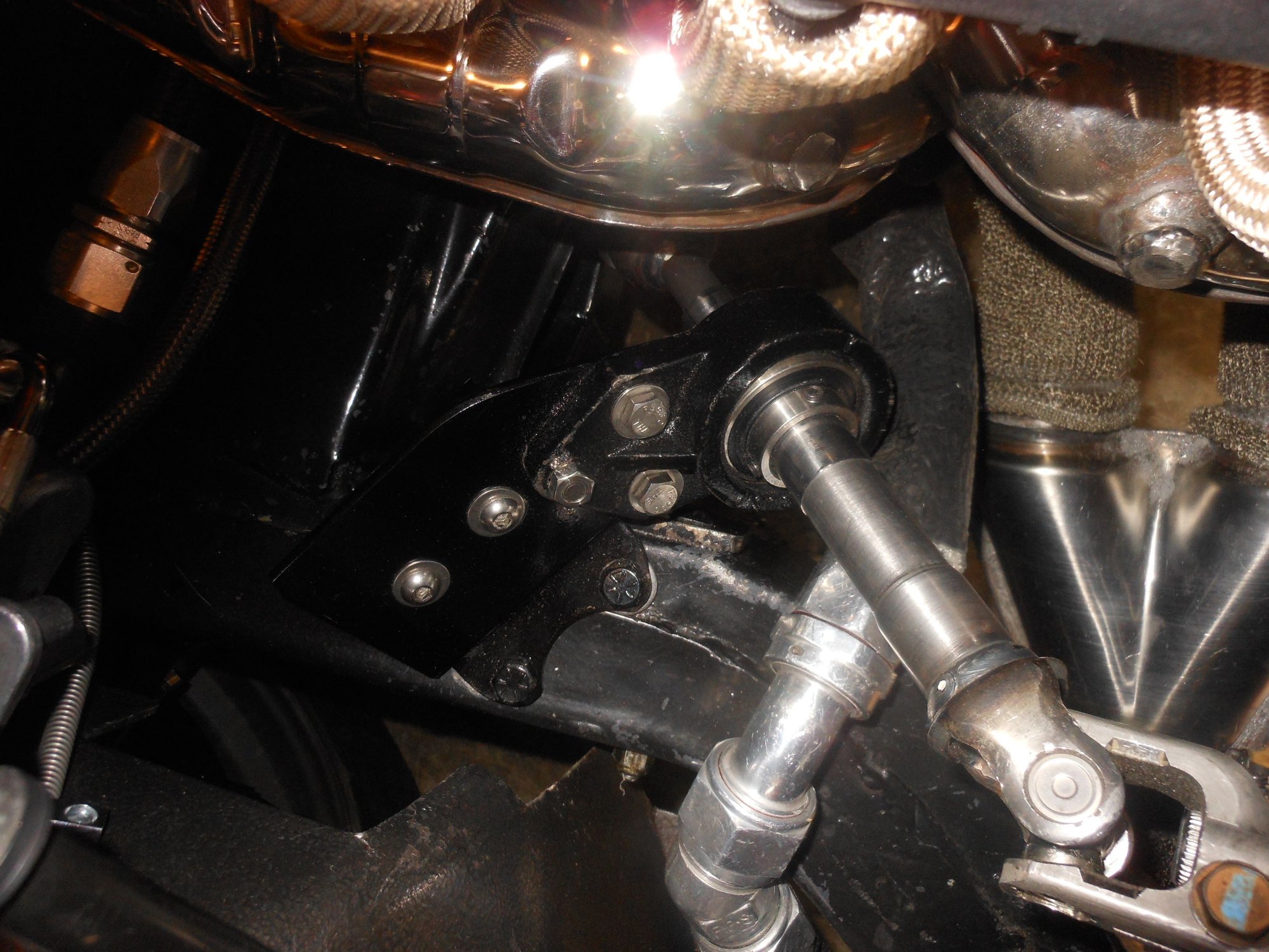

Big step in my car ...I now have steering!!!
After fighting the Flaming River R & P Manual Rack and cradle to fit around the oil pan for quite a while...
Cutting up the steering column- shortening it - taking out the key and adding my delay wiper control- modding the hub to fit a Nardi steering wheel-
The topper- decided to take a Nissan Cube's electric power steering motor and ECU- modified it to fit the column...
Whip up a steering linkage that would collapse in case of an accident and work around my dry sump lines and exhaust...
Success it works!!!
It was soooo cool to turn the front wheels with little effort!!!
center support bearing for the steering shaft-
Here's a quick video of my electric power steering conversion...
Actually it's the first time my car has squealed tires in quite some time!!!

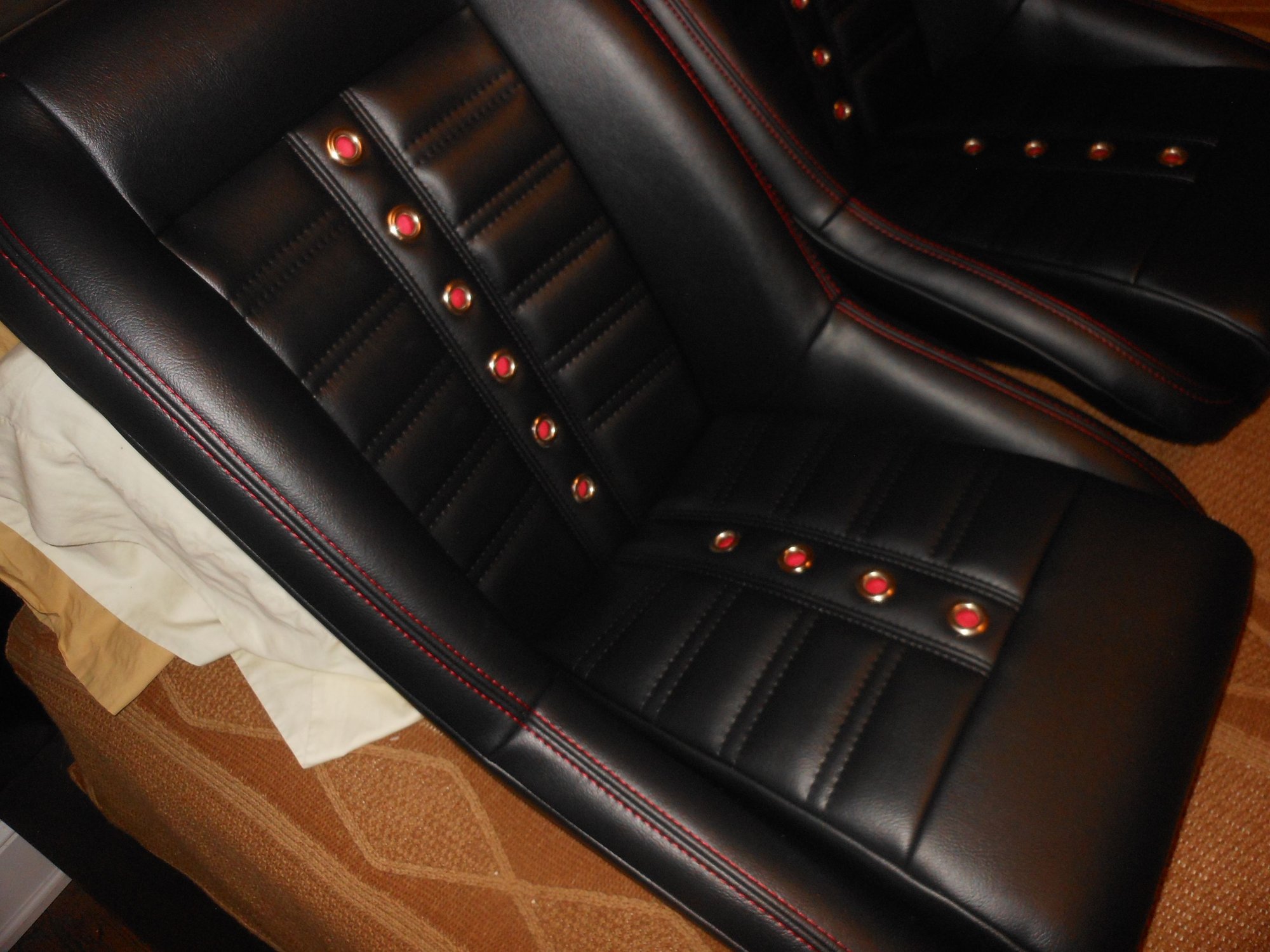

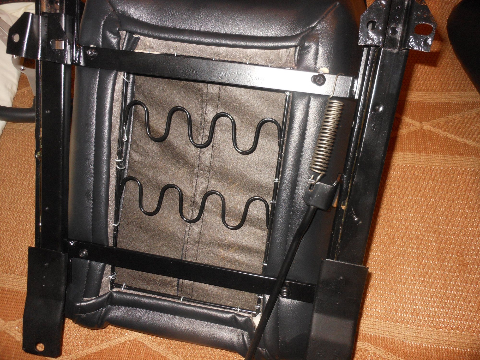

Got some new seats.- used the C3 tracks- and the seats are only 1/4" taller than the old worn out OEM ones-
I really like the red stitching- so I got a red fabric pen and did the steering wheel-
