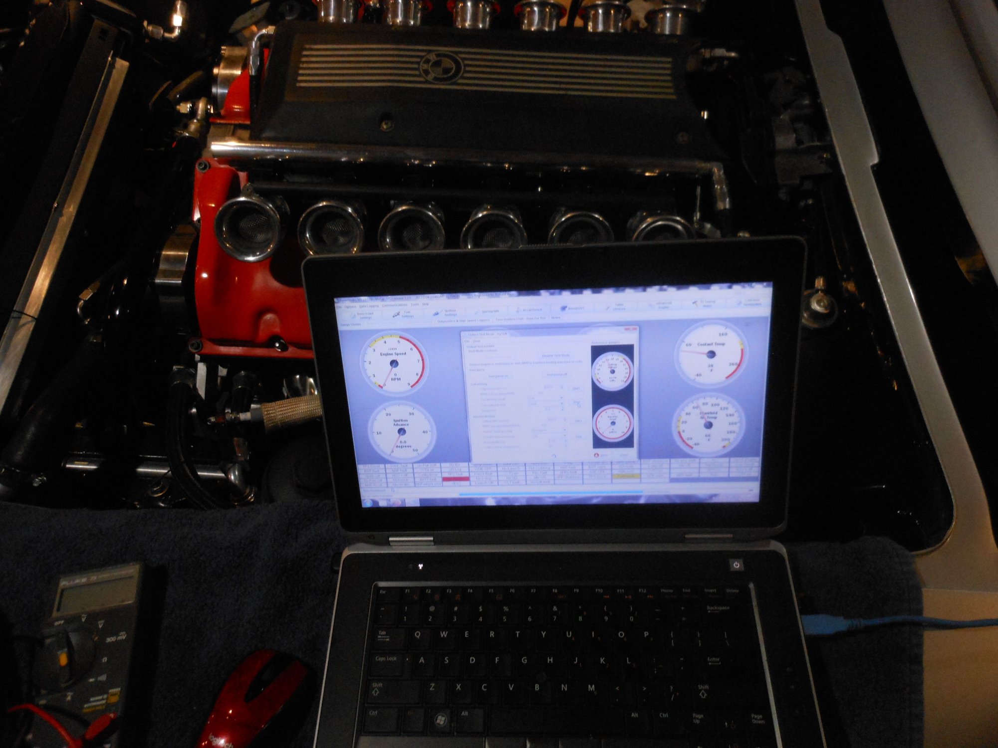

Anyway- i pulled the plugs- to do a quick check- and as I thought two plugs weren't firing..so the video is actually of a V10!!!
I pulled the laptop out and started checking for spark- with the set up tables I can send a spark to each plug and test- so that will help me narrow down troubleshooting big time!!!
So I rolled it outside for the first time in a while- I'm happy with the look!!!
Checking for spark- beats the hell out of getting zapped and having to run the engine!!!

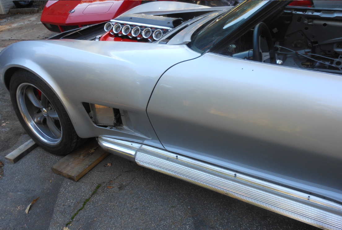

Here's another pic I took that really shows the engine rake off- I'm thinking definitely a plexi- hood section now!!!
To Corvette V12?
