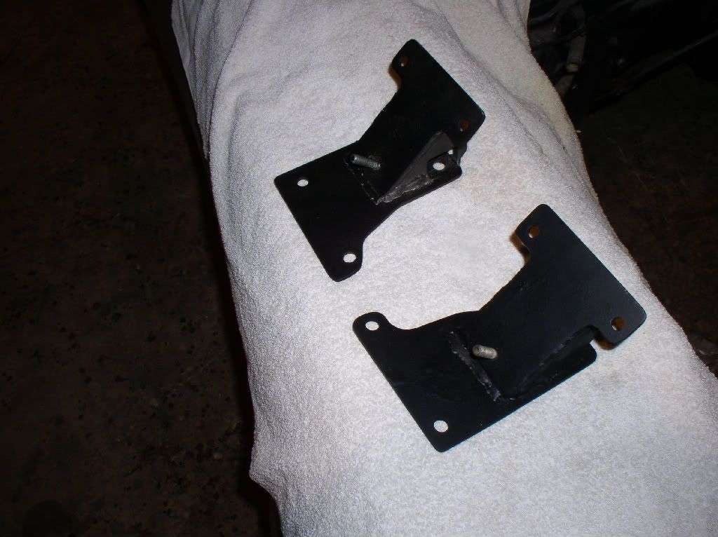

And here's my idea/ project a BMW V12- NO frame mods/NO firewall mods/ Stock motor mount bolted to a mount I made that bolts to the stock V12 block mounts- Will even fit under a small block hood....

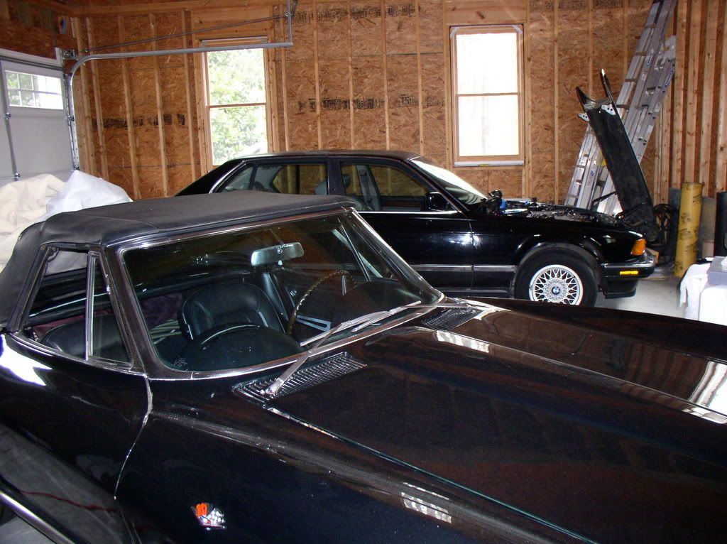

When I open the hood- this is what I see - and proud to say- "I built it..".
BMW V12 M73 ALL aluminum-

Jag V12 are nice- but about as heavy as a Cast Iron big block (685lbs)
However- the BMW V12 I'm gonna run with weighs in about 500lbs- fully dressed - A little more than a LS1.
As far as power goes- About 300HP in stock form. I've pulled all the accessories (A/C & P/S) and setting it up w/ a dry sump-a little clean up and I really will only see about 350HP. So- really close to what my original LS-5 made back in the day.
Hauq- Manual transmission is not a problem- The BMW 850's came w/ a 6 speed-and they are not too tough to find.
Richard

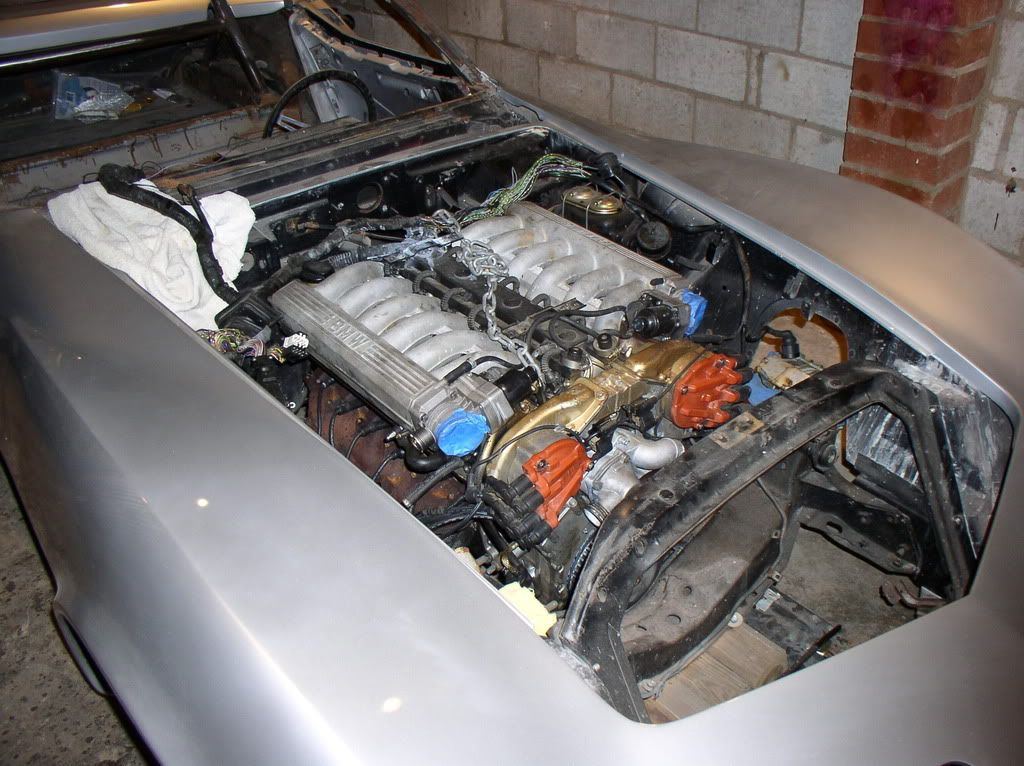

Here's one of the swaps that gave me the idea-
Is a Datsun 240/280Z w/ a GTO replica body on it and a BMW V12 powering it-

Actually- thanks to reading the Lambo Kit Car building forms- these guys have mapped out all the wires. I'm using the stock computers (1 for each bank of 6cyl and one that syncs them-3 total).
Before I pulled the motor - I clipped wires and made sure everything worked correctly- I even wired the electronic throttle under the hood and made sure it worked-
Electronic throttle-
In addition to the six wires for the drive by wire throttle- have only 3 check light bulbs to wire- power/switched ignition/ ground and fuel pumps (2). It's really not that tough.
The dry sump has also been done before- BMW uses a two part oil pan and I just have to cut a piece for the lower pan- add some hoses/pump and tank.
