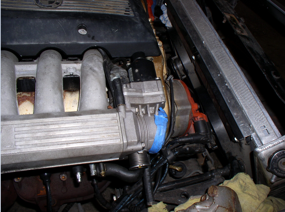

Here's the latest- I'm working on the cooling system-
Dewitts radiator w/ twin spals- looks like I'll use the stock BMW Expansion tank- up nice and high so I'll bleed the air out of the system really well. I still have plenty of room for a mechanical fan- but I've got to run the air -which I might pull out below the radiator?
Richard

It's really amazing that such an engine can fit a C3 chassis, and keep everything under a stock hood.
Very nice job, Richard !
Did you set the new engine at the same angle ( transmission ) as the stock GM V8 or is it slightly different ?
Looking at the pictures, it seems that the new V12 is almost horizontal.
In the pics- the back end of the engine IS sitting higher than it will. I have a jack under it- the speedo cable is in the way of a temp sensor- easy fix.
As far as the placement of the motor- I used the crank centerline on the Chevy engine as my reference when designing the mounts for the BMW V12. So -yes it's be at the same angles as the stock. Also going w/ a dry sump- I have no clearance issues at all.
