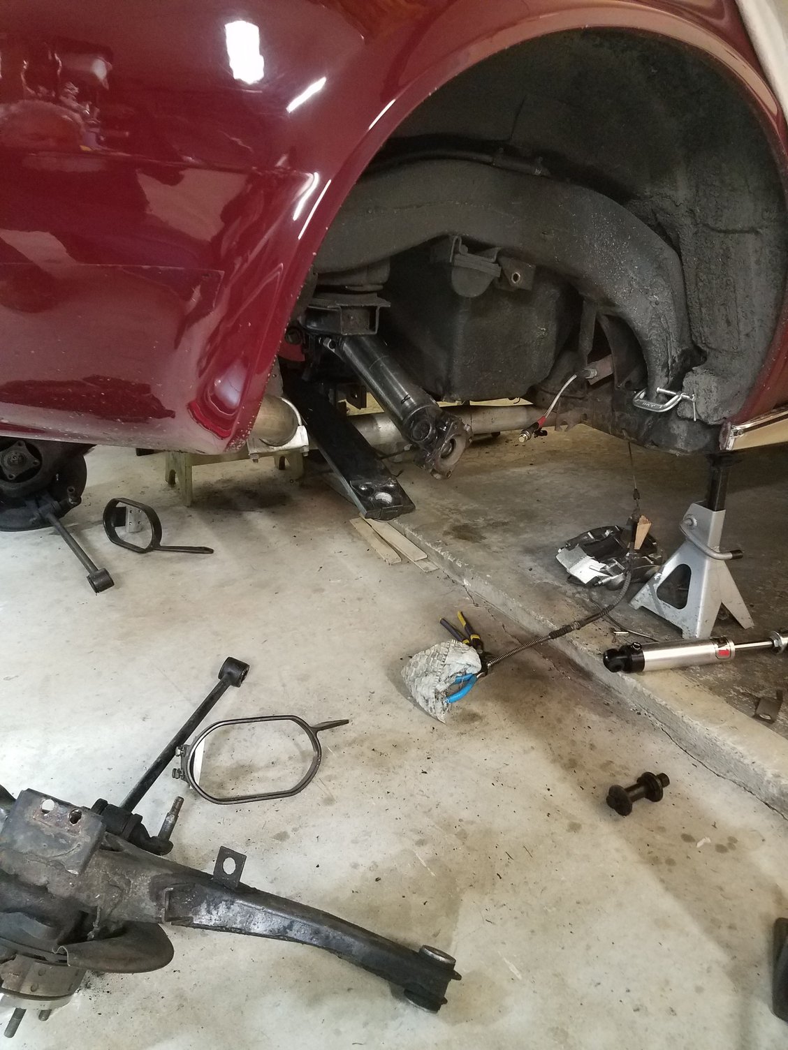

Well, actually I started yesterday on the brake lines. Today I got everything out in about 4 hours. This process was greatly simplified by the fact that I had the arms out about 12 years ago and used the stainless steel pivot bolt and shims when I reinstalled them. This time the bolts practically slid out after removing the nut. The shims look like brand new. The only real problem was the struts. They weren't moving after a few major hammer blows so I left them on the arms. I will take them to where I have access to a press and more extreme measures, if necessary.
This started because I noticed when the back of the car is jacked up, I could rock both wheels when grabbing them at the 12 and 6 o'clock positions. I was not hearing any unusual sounds but the movement has me concerned.
I'm considering upgrading the outer axles while the arms are rebuilt. I PM'd Gary R on the Forum and he was nice enough to provide some info on axle options. Or, I may just stick with the originals.

Good pics. Let us know if you find slack in the bearings.

Bruce the play you have in the axle is from the bearings not being setup tight enough. You can do a bench test by laying the arms down with the rotors bolted on, spin them, then put your hands at 3 & 9 you shouldn't feel any rock in the bearings. The stock spec is way too wide and at 003" true endplay you will feel movement. Don't go by what you see on youtube, I haven't seen a real good video there yet on setting up rear bearings, of course I might have missed some.

Gary - I did try the bench test with the rotors held on with lug nuts. Both rotors do rock slightly when held at the 3 & 9 positions, also at 12 & 6. I guess this confirms I need bearing replacement and proper set up.
Doorgunner - Slack, slop or wear, I've got it.

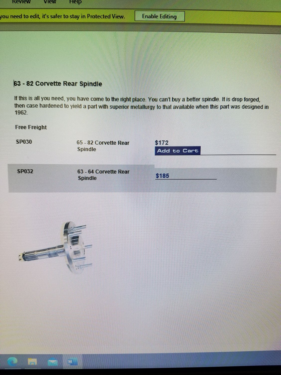

I followed up on Reno's lead on Duntov Motors. I found the axle shown below. This could be what I'm looking for since I really don't have a need for $1K + axles in my car. I need to get some more info. Does anybody have experience with these or with Duntov Motors parts?
I have not had a problem with them at all. They are serious about racing and very helpful

well since you asked here is what is known. They used to be FastCorvette there may still be some here who remember them or had dealings that were lets say, not the best. Then changed to Duntov. Do a search about them here.
I doubt they make those axles and they are not Tom parts, which have been track tested for many more years.
