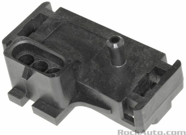

1981 (or 82) Corvette? The 14029543 may be the your A.I.R. relay.
If I'm right about the year, I'd guess that's the vacuum sensor (Manifold Air Pressure or MAP sensor). Does it look like this?
You should pick up an assembly manual and shop manual specific to your car, but a wiring diagram is here, if that helps in the meantime.

Nice find! At least I guessed the year correctly.

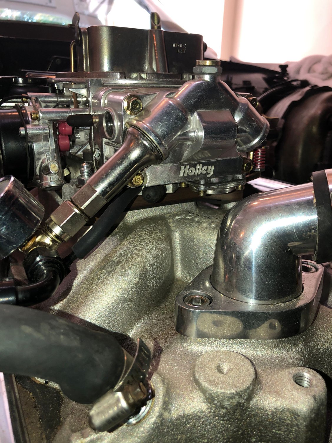

Yes sir, it is 1981 and the picture you provided is the part I am referring to. So do i need to find the connection for that open end plug?
It's under the that rectangler plate with hole in it. So should I plugged that vaccum cannister port or just leave it open? Also if you see this picture below, that green connector looks like Mixture Solenoid plug and it's not hooked up because car has Holley street avenger carburetor? Car came up with code last night code 23 after few days of driving. Should I short that connection with paper clip? Thank you so much.

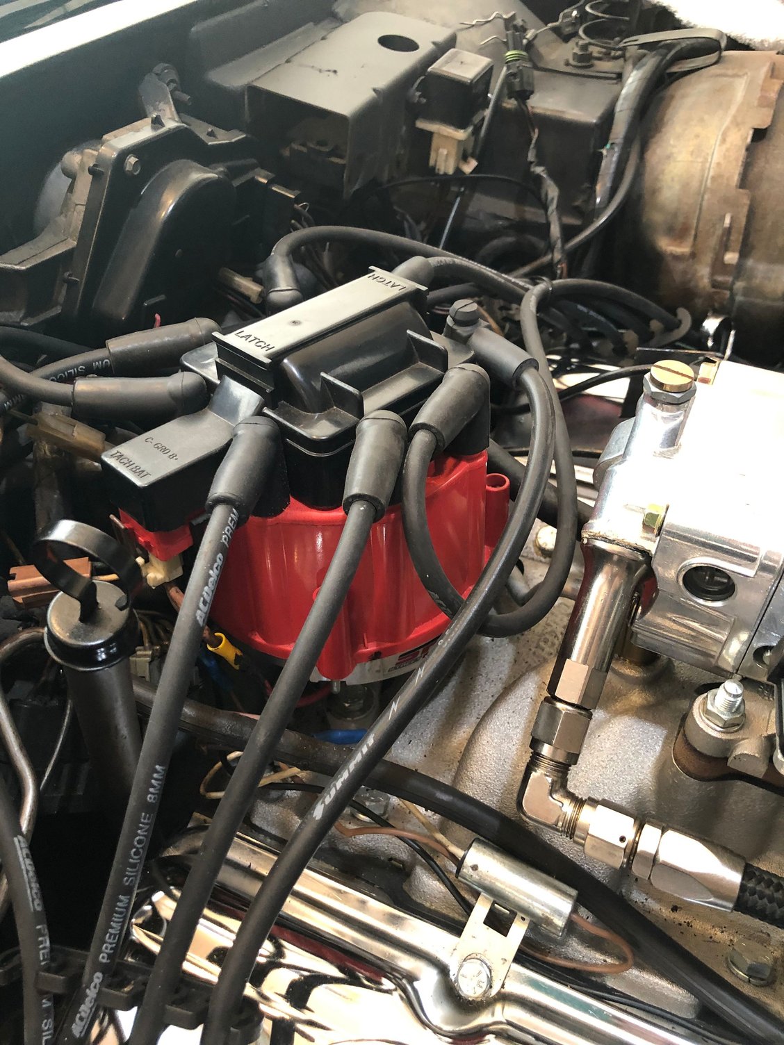

Here are some pictures. Car has new motor with cams and heads. Distributor is MSD HEI. Yes, I found it strange why would ECM throw a code 23 when connector isn't hooked up. Car runs like monster since i bought it with no carb issues.

Now I really don't know why the computer is throwing codes. Nothing in your engine compartment suggests to me that the original ECM is in any way involved in making your engine run.
I'd follow all of the vacuum hoses back to the source, and plug any vacuum leaks.
Is the distributor computer controlled, or does it just not have a vacuum advance can at all? If the previous owner was drag racing exclusively, that might make sense. Vacuum advance on the street is helpful, though. If you want to tweak the timing, email Lars (PM me if you can't find his email), and ask for his timing and HEI setup papers.
Otherwise, if it runs, run it!
