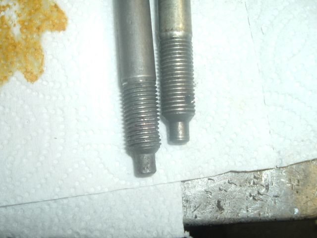

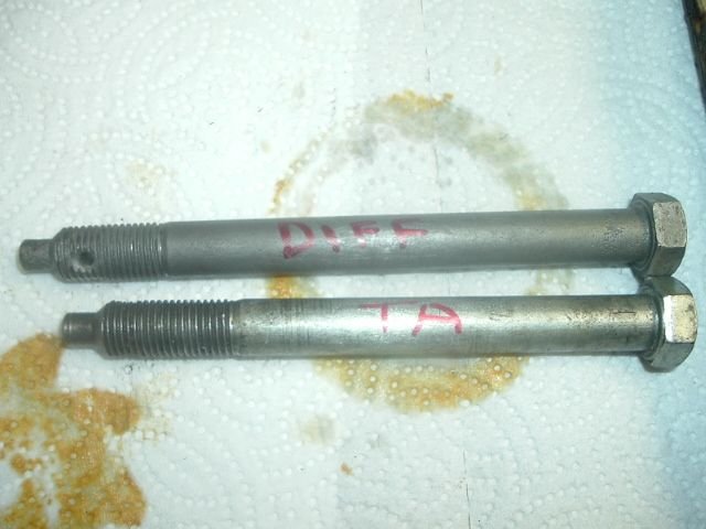

Originally Posted by ralphspears
FYI Look at those bolts. They are the same as the trailing arm pivot bolts! Last time I bought repro trailing arm bolts, I didn't like them because the threaded portion of the bolts caused the treaded portion to "bite" into the frame. The trailing arm bolts function as pins and so the contact with the frame should be via the smooth surface of a pin shaft. On my 68 I've removed those bolts to use as replacement trailing arm pivot bolts. Any bolt can be used for the differenctial torque bracket shown in the photo.

The is a length difference between the diff bracket bolts and TA bolts. If I recall they diff ones are a little longer.
I found some in my shop today.
