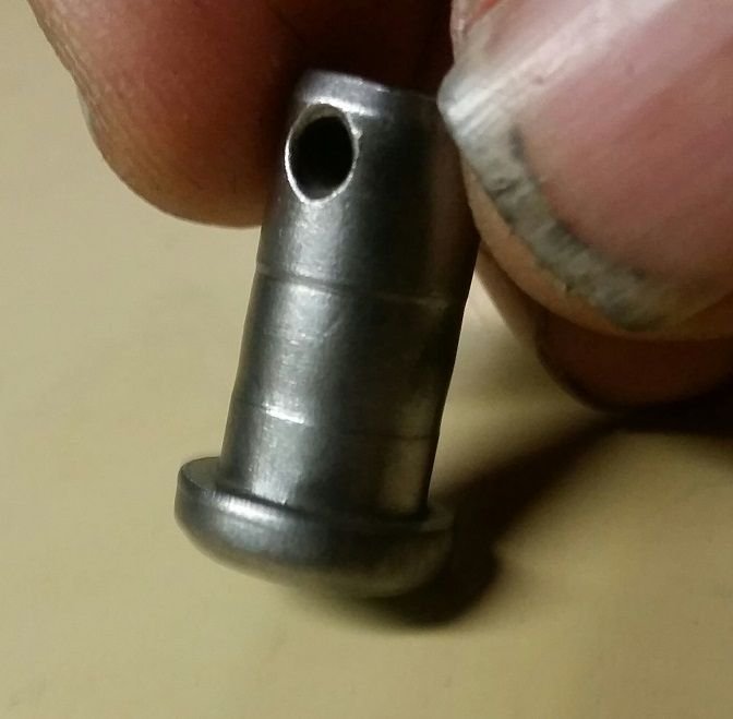

New to these transmissions so I don't know how much wear is going to effect this or that.
For those in the know, is the wear on this 3 & 4 Lever Clevis Pin going to create a noticeable slop?
Was attached to the upper/normal throw Lever holes. I'm planning on using the lower/short throw Lever holes.
Would you replace it?
Thanks,
Steve

If I had a new one handy or was ordering other parts and not in any hurry, Yes. However if I wanted this car on the road today, don't think it would worry me much.

Thanks mate. Thought as much too, but wanted some opinions.
Much appreciated.
Steve
P.S.; couldn't find any for sale on the net anyway.

Yes you can use it, but look for a new one.
Dom
