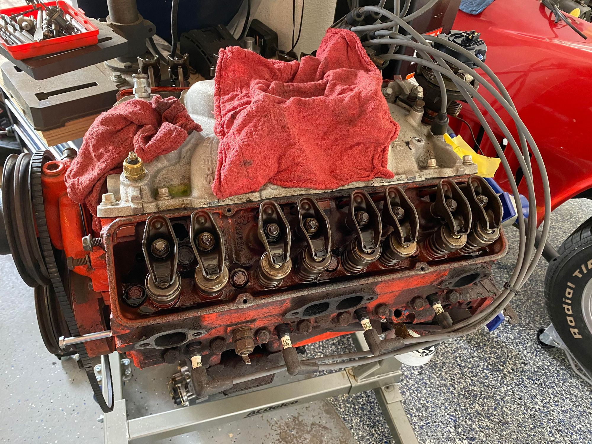

This is going to be my documentation of my engine build thread. I know I had another thread on engine pulling advice but I want this one to document the entire process. I pulled the engine and transmission as one unit. The 4 speed was fine but I am going to upgrade to a TKX 5 speed probably from SST. The engine itself is a Chevy 350 (not numbers matching) with a 4 bolt main. The compression numbers were all 150 so I may just keep it and upgrade the heads. The heads that are on it are casting numbers GM 462624 and from what I have read they have 76cc chambers and are absolutely the worst heads available. I can only assume the cam is similar. The engine was lethargic to say the least and was in dire need of a clean up, new seals and better heads and cam. It does have an Edelbrock Performer intake manifold and Edelbrock 600 cfm carb but that's all. The car also has headers and the Allens Chambered exhaust straight out the back.
Id like to be somewhere around 400 HP. So that I know what I have, what do you suggest for a head and cam combo?

the 624 aren't the worst head. but they are up there. first you need to do an autopsy, if you will, on the engine. pull the heads. throw them in the river. after checking to see if they are among the rare 2.02 valve heads. which they won't be. now clean and check the piston tops. most likely oem small dish cast, and standard bore. but also possible aftermarket and 30 or 40 over. now disassemble the engine. crank, pistons and cam out. DO NOT pull a couple of bearings and say they are good so they all must be. also cam bearings are easier done and cleaned up after with a bare block. .now you know your bore size and condition. your crank condition. if it needs rebored, go find a vortec block. hydraulic roller setup for a few hundred bucks. and the iron is better and the thermostats never got pulled out and left out so most of the bores are in very good shape. both my 880 vortec blocks show no bore wear. still thinking 383? works with either block. now you need to count dinero and decide how much you want to sink in this engine. good bores, crank and pistons? you can re-ring it for 100 bucks. or you can easily drop 7k in an aftermarked 4-1/8 block and a forged 3.75 crank and forged flat pistons and top of the line brodix or afr heads. and you still haven't got a cam yet. you want a roller setup. you do NOT want 200 buck ebay roller lifters. now, after counting up parts cost you need to look into new or rebuilt short blocks or complete engines. and see which way makes the most sense. many guys are leery of assembling bottom ends themselves.

like dj said. you are replacing the clutch anyway. the number of splines is only diff. and the 26 is stronger. all the stuff you are gonna be doing which clutch disc is way down there priority wise. next question: are you driving the car this summer? it may effect the amount of work. pull the heads. lets see what this engine has for pistons. pull the pan too. many truck engines are forged crank and pistons. what is the 3 letter code on the stamp pad?

that is why you are doing this. that is a cast crank, so nothing fancy. pull a couple bearings and read the back of the bearing shells. will tell you if been rebuilt or orig gm and the month and year. stamp pad is front of the block right in front of the right cylinder head. have you decided how much you want to spend? and whether or not you MUST HAVE that 10% displacement boost of a 383. you can always get 185 cc heads for the 350 so you don't have to buy again when that 383 or orig 400 small block falls in your lap... oh, your car is very close to chebby engine orange-which they called red. and there is no hard and fast correct chevy orange color. it was whatever was in the semi trailer full of orange paint that pulled up at any given engine plant at any given time. maybe paint the engine to match the body...

I may just go with a crate engine and sell this one. I just checked my rear end ration and can someone tell me if I did it right? I jacked up the left rear tire and marked the driveshaft. Then I spun the tire through two rotations and counted 6.5 turns of the driveshaft. What would my rear end ration be?

jack up both rear wheels. but sounds like around 3.25. you will be disappointed by the lack of interest in an old 350. hard to get 200 bucks for them these days.
