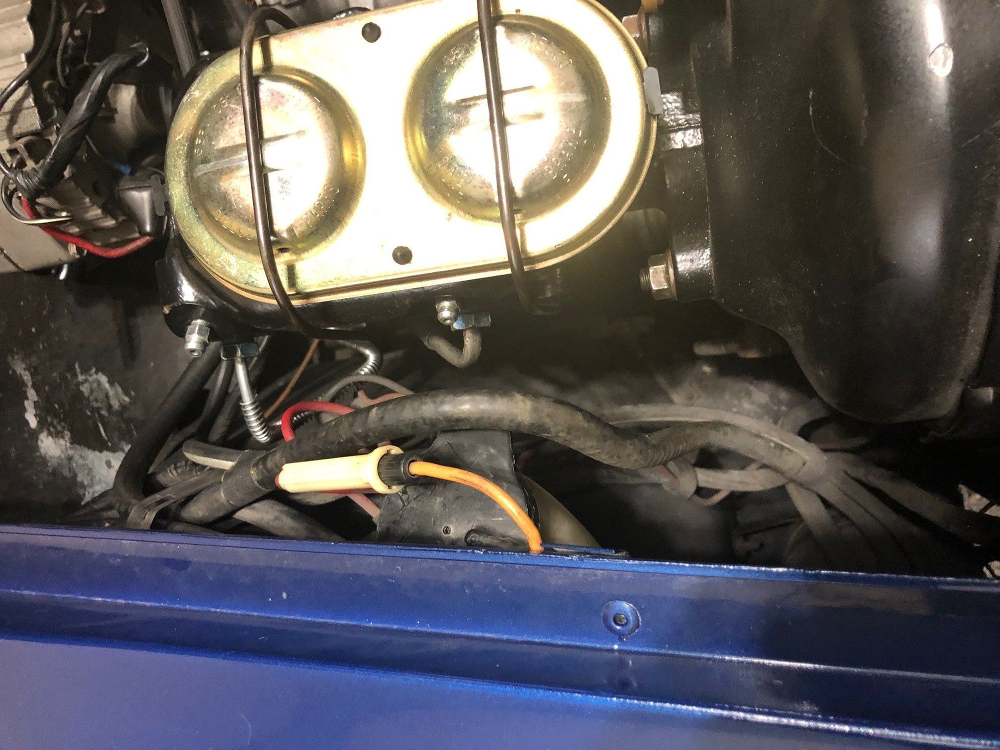

Edit to add: Mine is also a 73, would you be able to post a picture of that fuse holder? Thanks!

Well for sure than the problem is the fuse holder. There is a red wire going into the fuse holder and an orange wire going out and follows around the fire wall. It is tucked up under the fender.
