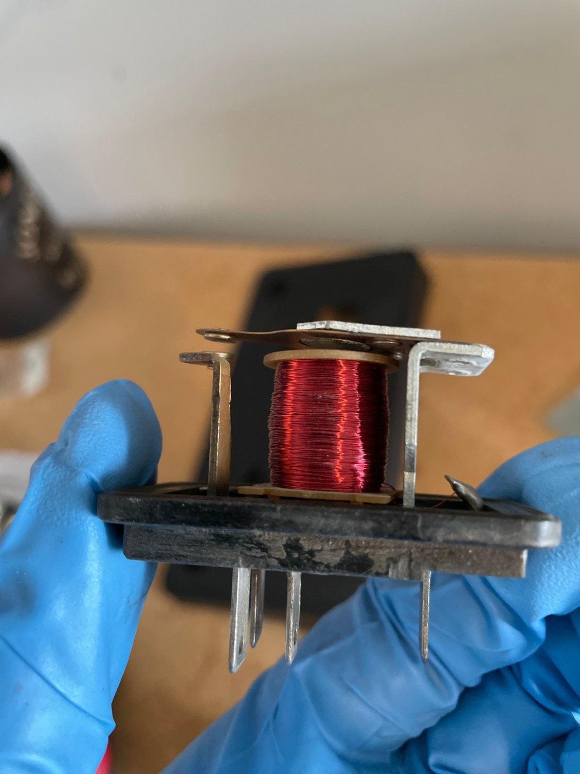

Hi everyone, this is the relay for the blower. As you can see from the picture one side isn’t touching, making contact. Should it be?

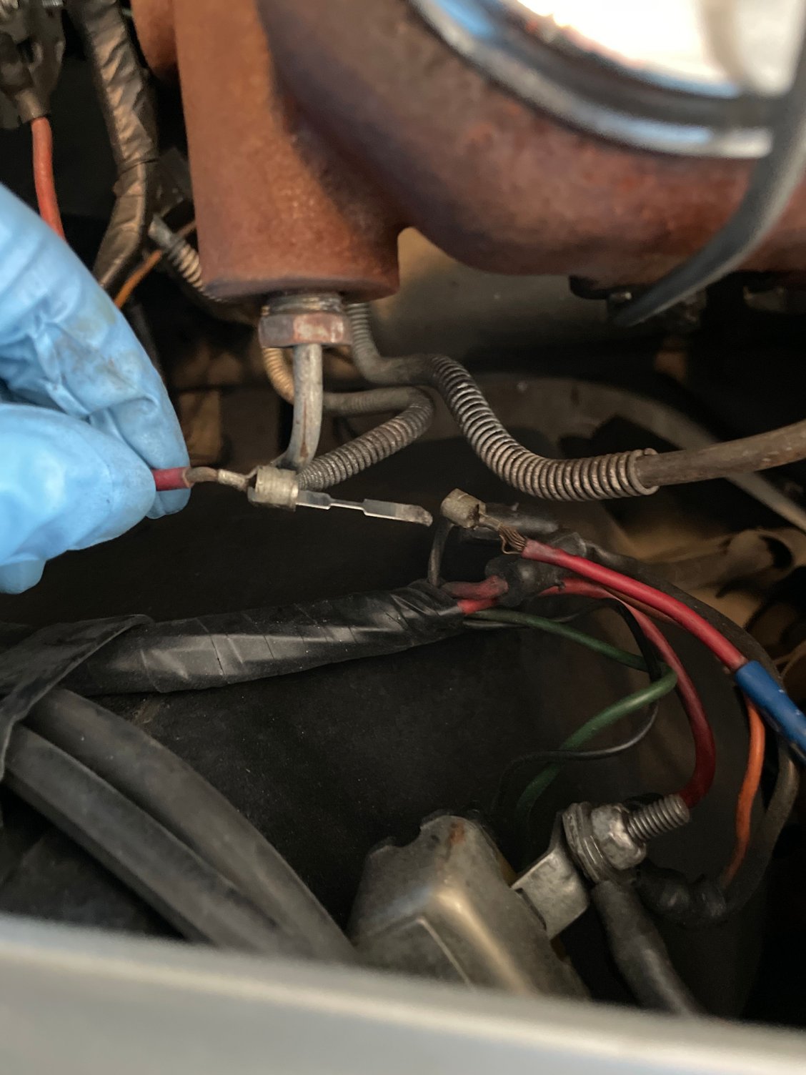

Hey everybody, so this is what I found in place of my fuse. There is a fuse there however, the fuse is blown.

At store now, and just realized I have NO IDEA what amp fuse to get 😅

Fuse replaced. High works great.
BUT, now it won’t shut off. Blower is running even when it’s not suppose to.. WTH LOL

So, it was running because I made that relay touch on both sides. Not meant to do that I guess. Changed that relay back, changed the fuse, blower working great!
