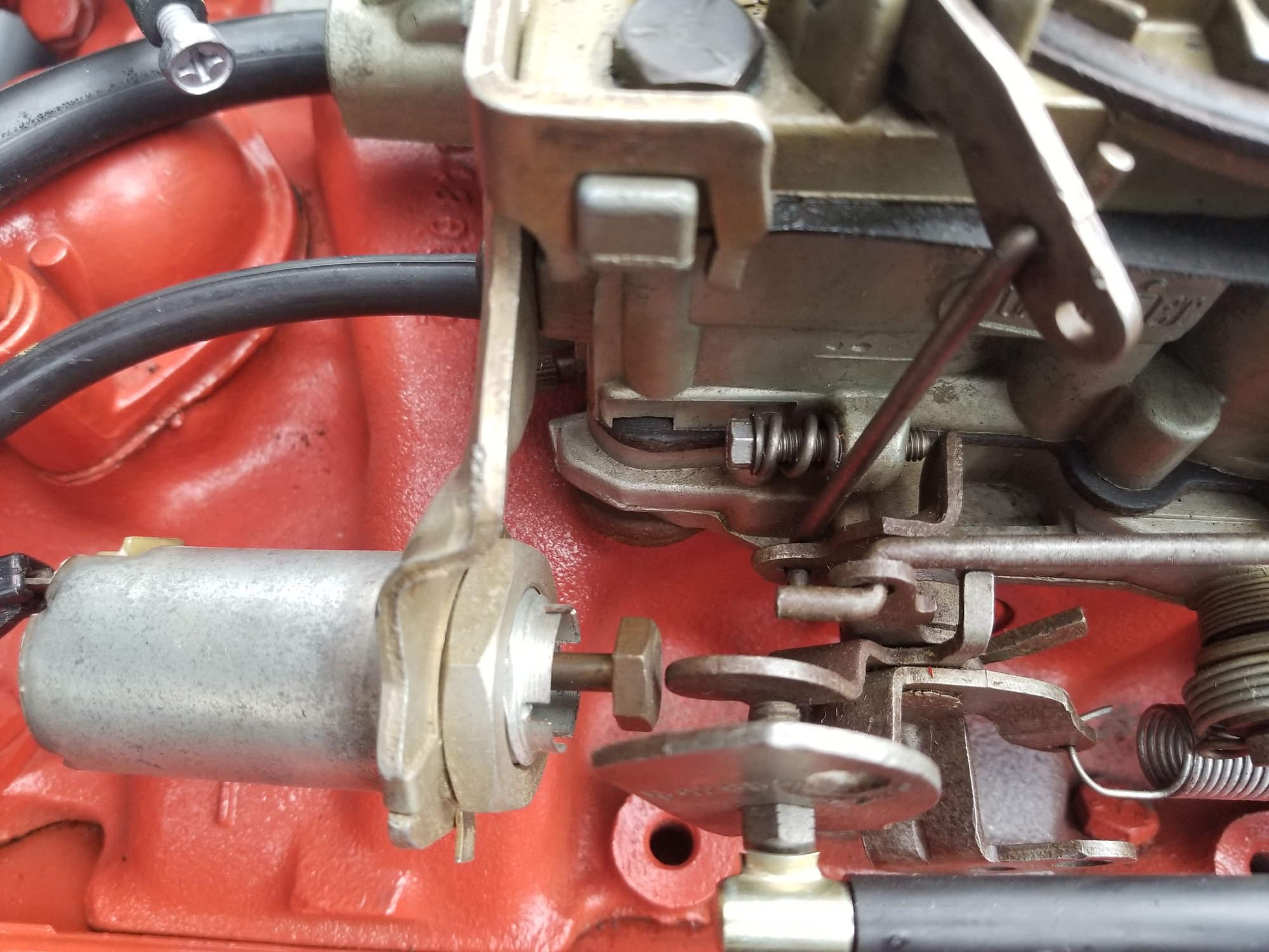

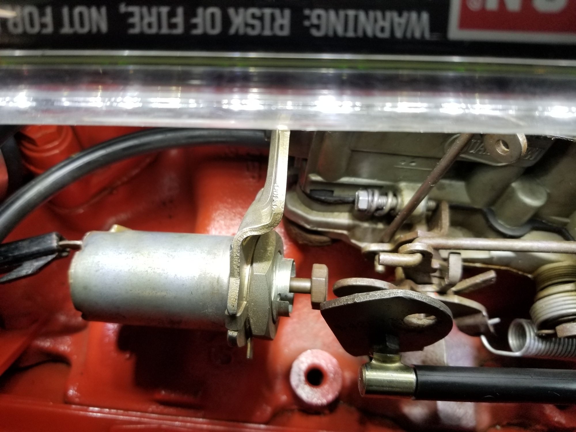

Question. 73 L48 4 speed. Restored car and NCRS Top Flight. Idles around 1,000 rpm. But throttle arm not touching solenoid plunger and idle screw not touching. Choke off cam.
Just bought and all emissions hooked up and air pump. Runs smooth as silk but around 230, which is correct in stock settings.

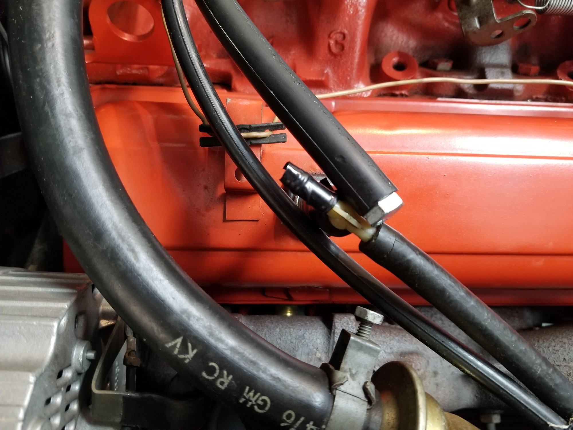

So I disconnected the TCS switch, plugged line and ran full manifold vacuum to distributor. Initial at 10 degrees and with vacuum hooked up adds 16 for idle timing of 26 degrees.
Runs around 220 and still high idle. See pic, plug this line an idle drops to 800. Charcoal canister vacuum leak? Other pics is current unplugged TCS and full manifold vacuum.
But the stock carb has me baffled, seems throttle plates closed. Is there something internal that keeps idle up?
Tks. Doug

The small vacuum line from carb to vapor canister must be connected to a 'ported' vacuum fitting on the carb. If it is connected to 'manifold' vacuum, that larger line would be trying to purge the contents of the vapor canister at idle. That will put extra A/F into the idle mixture and screw up idle quality. Make certain the canister 'trigger' vacuum line goes to a ported fitting.
If that line is connected correctly, the vacuum switch on the vapor canister could have failed in 'purge' mode, so that the canister is ALWAYS purging, regardless of the carb signal. If that is the case, the vapor canister and/or vacuum switch on it would need to be replaced.
But, with that purge line plugged off (as in the pic), you have removed the canister from the system and it is idling at 800 rpm. Does the curb idle adjustment screw on the carb allow you to raise/lower that idle speed? If not, you may have some other vacuum leak in the system or a carb setup problem or internal fault in the carb which is preventing proper operation.

I was testing all lines, the large line from base of carb, manifold vacuum, unplugged and capped off in pic brought idle down to 800. Only line to alter idle. Plugging back in to PCV T fitting brings idle back up to around 1,200. The small line from carb to canister looks like correct connection. I sprayed carb cleaner all around and no idle change. See pic, idle screw and solenoid plunger not touching throttle arm. Choke fast idle backed off. I don't know if the 1973 Qjet has some internal function, idle air bleeds, etc. that overrides what you would normally think at this point would make car stall. Idles at around 1,200 with nothing touching throttle arm. Car accelerates smooth as silk from a stop, secondaries come in like a light switch. Tested idle vacuum and reads 17", vacuum gauge does not fluctuate even a hair. Tks. Doug

I noticed that, unless the throttle plates have come loose from the cross shaft and bound up
the ability to close all the way, only other thing would be the cross shaft wore the base plate
shaft holes to the point the throttle plates are binding.
only your eyes and some history of the carb can determine which.

Check the choke linkage and stove for complete actuation.....if it is hanging up or not pulling all the way......it can stick the throttle open.
My question is that is the throttle level on the idle screw stop? Impossible to tell from these photos......

Then something is hanging the throttle open…..and that something is generally on the other side of the carb and has to do with the choke….the choke may work but not pulling the fast idle cam off…is the lever in the blue circle in the pic all the way down?
There is almost nothing emissions about this carb BTW…..besides the solenoid it is the same as a 66’ model Q-Jet in function…..only the choke mechanism can hold the throttle open unless there is something majorly wrong with the unit and I doubt it very highly given the condition of you car…..
There is nothing internal that bypasses or lets air through other than the plates…..and they are hung open a bit…..get them to shut and problem solved.
