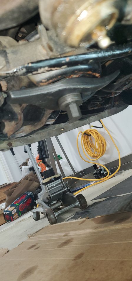

I've changed out lots of springs and rebuilt the a-arms at the shop and at home on my own stuff. Time is money especially now at the hourly rates shops charge. I've tried different spring compressors over the years and found them to be a waste of time.
Safety is always first. Big long big block springs are the worst. I used the shock or just a stick of rebar in the middle as a safety device. You take off just the bottom or the top nuts off the shock and leave it in place. With the vette frame on stands, place a floor jack about a 1/4 inch from the bottom of the a-arm. Loosen or even remove the castle nut from the upper ball joint, whack the side of the spindle with a Big Hammer next to the tapered ball joint. The spring will slam the a-arm down is why you have the floor jack close. Then you lower the a-arm with the jack. remove the jack. Long springs stay in the pockets even with the a-arm all the way down. With a shock or a piece of rebar down the middle I use a crow bar to pop the spring out. I've had them blow across the floor without a piece of rebar or the shock inside. If you are rebuilding the a-arms another removal method is to leave the jack under the a-arm when the ball joint pops out and unbolt the a-arm from the frame and lower it away and the spring will fall out.
Don't waste your time with spring compressors!

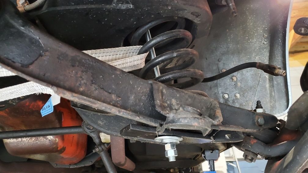

Pretty much people find what works and goes with that. I ABSOLUTELY HATE DEALING WITH COIL SPRINGS! When I removed the springs out of my 81 I used the 2 fingers from a coil spring compressor and made a plate that goes across the bottom of the A-arm. Once the ball joint is free I SLOWLY loosen the compressor until the tension is off the spring. Don't forget the strap the spring done with some chain. If it happens to get loose I imagine the last thing you'll see is a bright flash.😳 The coils in this car were heavy duty so that made the pucker a little intense.

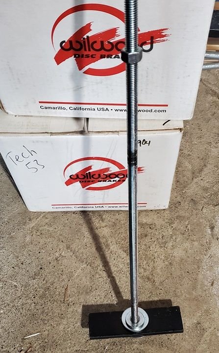

I use a piece of 1/2" all thread ran through the shock tower to compress/release tension on the spring. I cut superstrut to the proper length and ran the all thread through it to sit against the lower control arm and shock tower top. I wrap a couple of tie straps around the spring and frame as a safety measure in case the all thread breaks. Simple, cheap and effective.

Here's how I did it. A threaded rod and a tie down strap.
To Coil Spring Removal w/ Fork Style Tool
