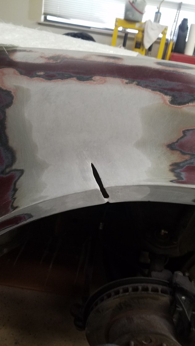

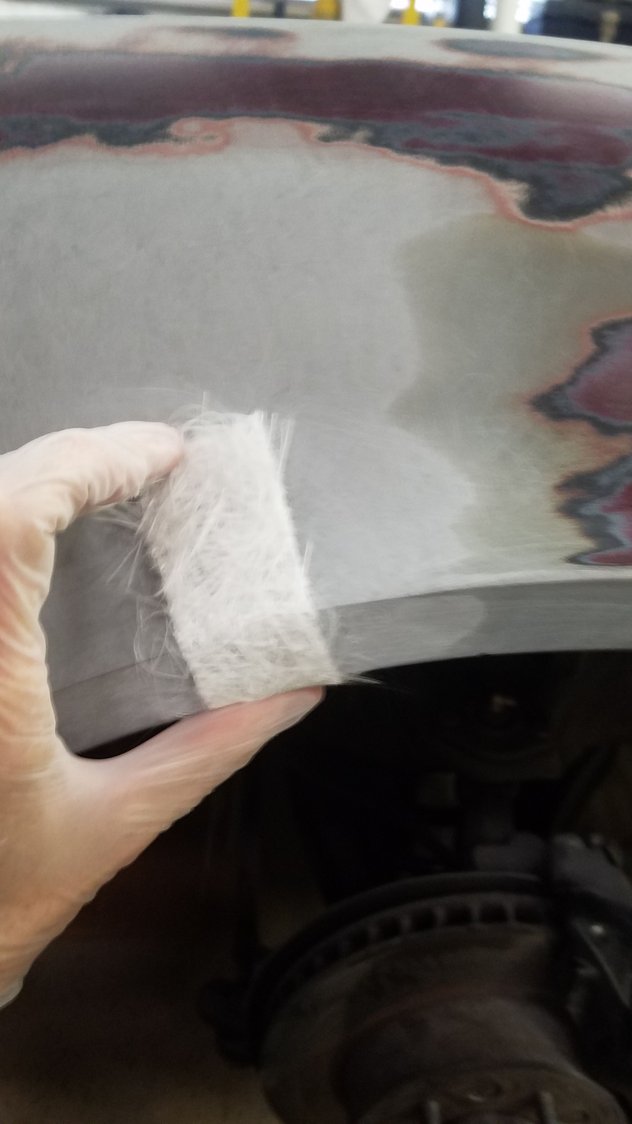

Well I started working the first fender crack today. I noticed very quickly as I started V'ing it out that it had moved laterally within the glass a bit as well. I had to open it more that I expected to get to solid fiberglass. I've dished it out a bit, but I'm kind of guessing on how much to dish out. Three layers of glass on top seems like it might be high, but I don't know how much the glass with shrink down once it's saturated in resin. I've cut three progressively larger strips of glass to apply on the top. Is it best to use a single piece to wrap around the fender, as shown in the pic? Will it cause problems going from a nice round shape to a sudden vertical as it wraps to the front side of the fender?

if you would like to use glass
fill the crack with thin strips the length and width of the crack
progressively make them wider to fit the crack
back tape it first
You will prob need 3 strips maybe four.
I also use chopped glass in resin and make a mixture to fill the crack
or fill the crack with VPA

As I mentioned in my earlier post #4, start with the underside first. Rough up the area with some 80 grit (by hand), then thoroughly clean with acetone. Pay particular attention to the area of the lip to ensure good adhesion.
You don’t need more than 2 layers. The first layer width should be as you have in the pictures with the second layer approximately twice as wide.
Follow the instructions for adding the activator to the resin exactly. Too little activator and the cure will be slow or, worse, never get to full. Too much and your cure time will be too short. Lay out the patch pieces on a smooth surface covered by aluminum foil. Apply the resin so the patch is saturated, but not so much that you have resin dripping all over the place. The strength of the patch is in the fiberglass, not the resin. Work any air bubbles out of the patch with your fingers.
Not sure of the environment that you are working in. If a heated garage, great but if not, you may want to pickup an inexpensive heat lamp. Don’t put the lamp too close to the work area. A couple feet away at least.
Once you have the backside patch cured, you can feather sand the outside so you have about 2” “trough”. 2 layers is all you need.
Once cured, get a couple pieces of PVC pipe of 2” to 3” diameter and wrap a sheet of 80 grit paper and hand sand to contour. Use a sanding block to achieve a straight edge on the lip. Take your time, sand a bit, feel the contours, repeat as necessary. You want to get the contours as close to original as possible so the only reason you’ll apply a filler is to fill the small air pocket holes that will be exposed while sanding.
Piece of cake!

What you posted for cut and size of patch doesn't look to be enough. Taper the original back at least 2-3" per side (so almost nothing left at crack tapering to nothing removed 2-3" away) and then use that thin piece first then a bigger and bigger piece as you layer it up. With the taper, the original area gets thicker as you go out so you need more smaller layers at first and fewer bigger layers as you build it up. That also lets you tie the fibers in each layer into the original instead of having a bunch of new piled on top of old with only 1 piece of new matting actually in contact with the old.
