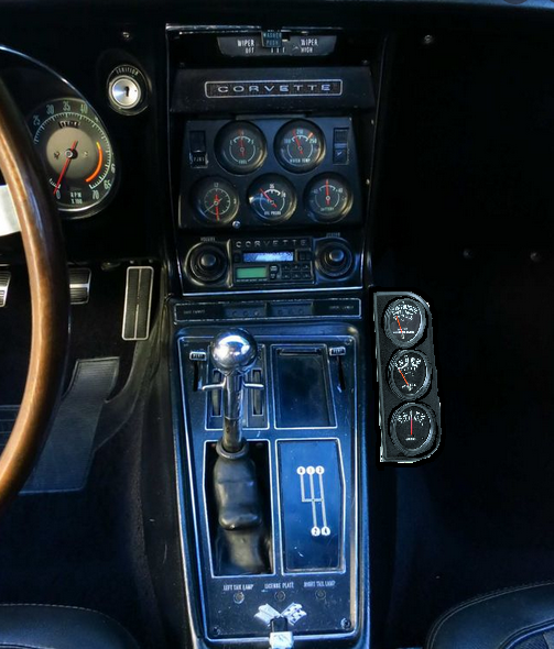

I would grab one of these kits - https://www.harborfreight.com/electr...set-41017.html
Rotate the gauges in the bracket like this:
and put them on the passenger side of the center console like this:

I think that is the perfect solution. Thanks!

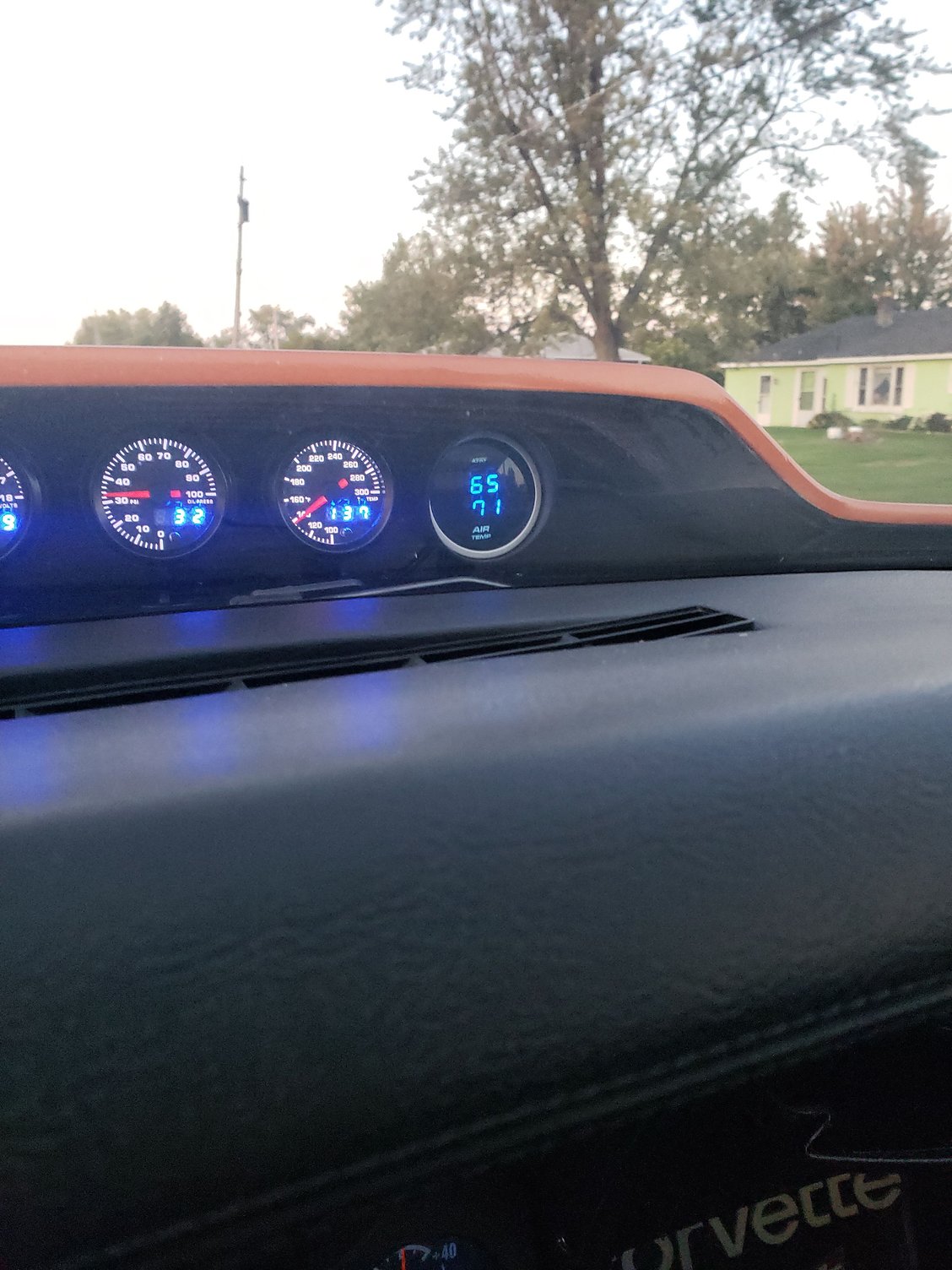

so ignore the air fuel reading as im not sure what was going on there in that pic but this is where I put my secondary gauges.. The one farthest to the right is a dual temp gauge which gives me both under the hood temps as well as the temps inside my aircleaner (upper readout) this enabled me to realize I dont need a cold air intake with my setup with my style of driving. Yes the temps climb at stop lights but they both drop to ambient air temps a few minutes after I start moving. the temps in the air cleaner are often a bit lower due to the hood vents on the greenwood turbo hood and the element top spectre air cleaner.

If I had a cowl hood I would definitely do that, nice!
I don't doubt that those underhood air temperatures are correct. Your hood louvres working great!
