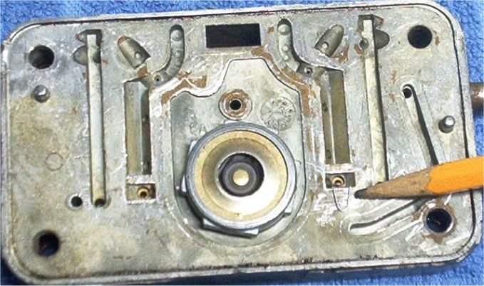

Here is where you can put the staples Lars suggested. Copper wire strand works too. Put one on each side.
Here is something else to check. Idle transfer slot setting is changed with the idle speed screw. Set the screw so the slot is barely exposed and looks like a "square". If you still need more air (RPM) at idle, you can crack the secondary stop screw to allow more air.

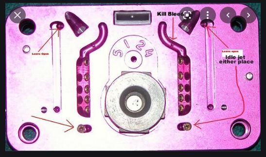

For the IFR restriction, I like to use a plain staple out of an office stapler because these common office staples are very thin - they are only .019" diameter, which tends to be just the right amount of additional IFR restriction if there is a rich-running problem. Also note that the IFR orifice can be located either up high or down low in the metering block, depending on the metering block design, referred to as "idle jet" in this illustration:
Lars
