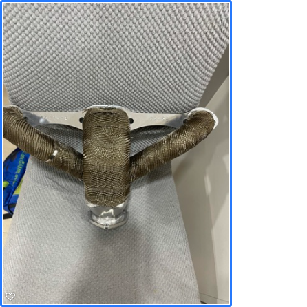

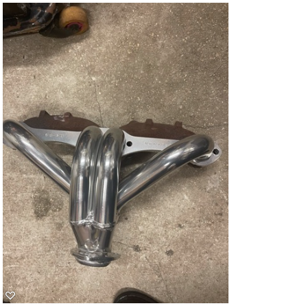

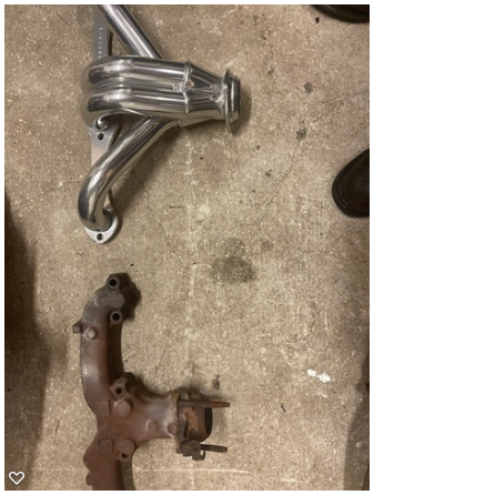

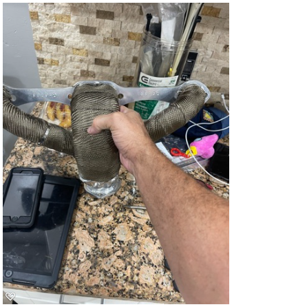

What's up fellas!!!!!!!!!! been awhile. I got some headers I put in (patriot shorties) and new side pipes (patriot as well). I love the sound. I wrapped them with heat wrap. I installed them myself after moving a/c, the bracket, the alternator etc. I also installed heat covers for the spark plugs. It's right up against the dang thing. I installed ngk iridium plugs (incredible quality) but am thinking of going with shorty's instead (also ngk) as the spark plug cable with boot cover is right up against the headers. pics with headers on the engine without the wrap were just to see if they would fit. What say you all?????

mark the pipes where the plug are and massage them a bit to give them enough room not to touch. If there is an air gap the sleeves should work. If the silicone boots is touching it will melt. You may want to add another wrap of header wrap on the pipe that goes by your feet on the fire wall if you dont have any type heat shielding. I now in general your feet will stay alot cooler than under car pipes but every little bit helps.

Ceramic boots help. Jegs has a cut-to-fit set with nice terminals for about $90.

I agree, take headers off and tap them in a bit to get proper clearance for spark plugs, , it won't hurt anything,,, ,,,, we all know, those headers and pipes are not performance up grades...
