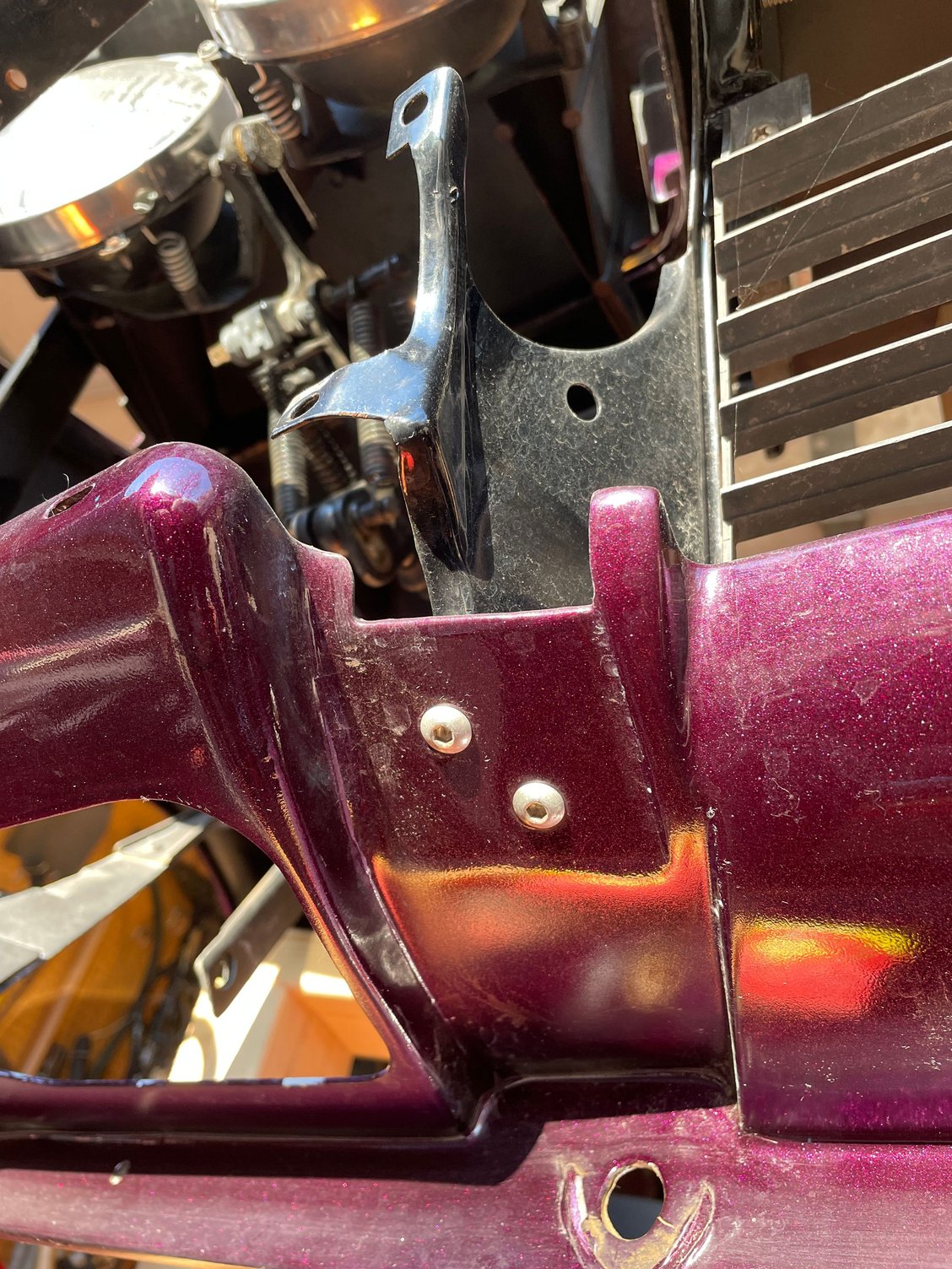

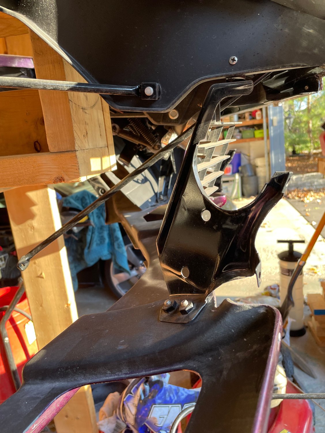

These from my 69 (built the last week of December, 1969). The fasteners are not original. The 2x6s are also not original…
