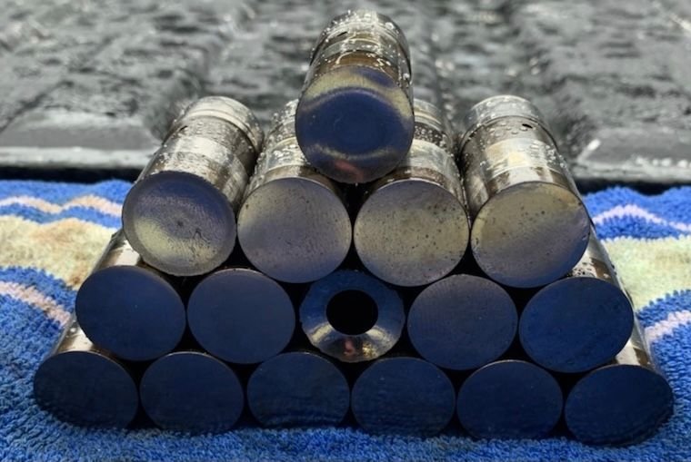

Took my 68 427 apart today and have three wiped lifters, one has a hole in it.
I’m going to change from my solid lifters to a hydraulic roller.

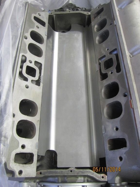

Also I currently have a windage tray above the cam and under the intake, do I need this thing? or should I even use it for a hydraulic roller?

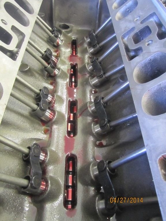

I did a set of hydraulic rollers on my LS5 last time around and used one of the trays in the valley as an attempt to keep some of the oil off the underside of the pancake intake manifold
GM performance products 12555320

Jeez that lifter valley Is gorgeous

Leave the windage tray in there. Take a good look at your cam bearings when swapping cams

I just want to add that the pan in the Valley is a "Valley Pan" and not a windage tray.......windage tray is below the crank in the oil pan.
It does not hurt to leave it in there and it will potentially keep the intake cooler.....but it may not work with tall retro fit hydraulic roller lifters.

The GM valley shield I showed there does clear the rollers (comp-cams) I used without issues as it's not really deep into the valley. I would imagine it would also clear most others unless they are extra tall or something
