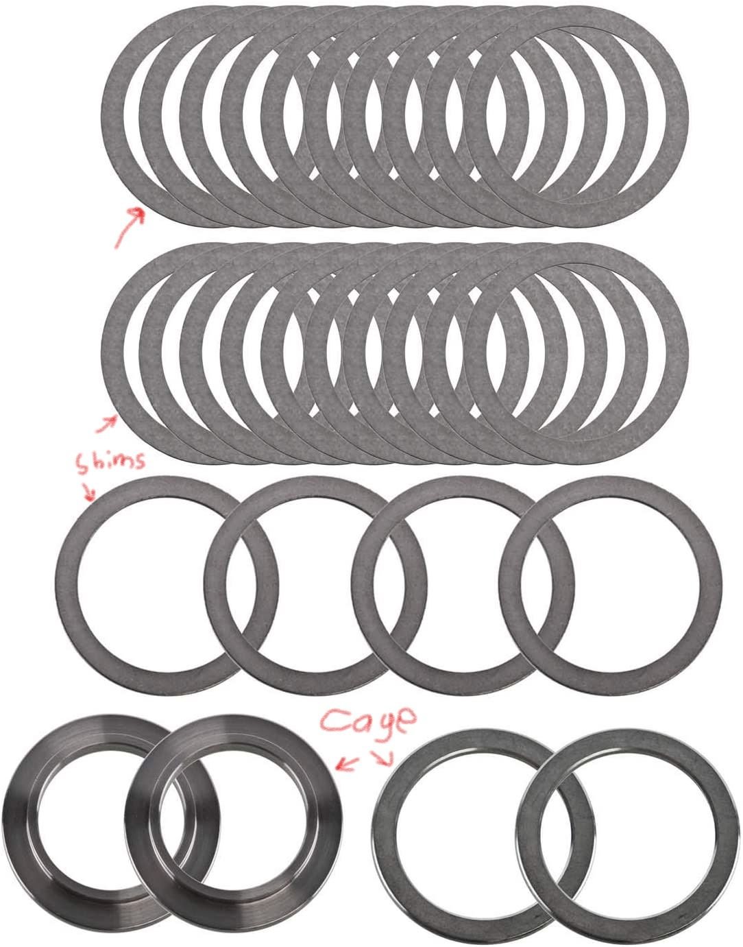

This rear does not require a spreader tool. GTR taught me how to do mine. You adjust the shims using a slip-fit, then add another .005" on both sides at the last step to give the carrier a .010" interference fit. They just tap in with a brass hammer. But if helps if you have the shim kit that has a "cage" to it and you add the thin shims on the inside. Then they tap in easily. GM shims were one piece cast iron ground to fit and probably can not be re-used because they will not fit. Mine were roughly .260" thick each. The aftermarket carrier shims mostly seem to use the cage style. The real trick is the pinion drag alone should be 16 in-lb, and once the carrier is put in it goes up some more, to about 26 in-lb total. Then you have the correct amount of tightness and pre-load on each pair of bearings. It was the first diff I have ever done, and there is a tremendous amount of learning involved!
You re-use the carrier shim cage, and keeping changing it's internal shims, until you get the thickness you want. I wound up with .262" (L) and .223"(R). And a good pattern, good backlash, good pinion drag etc. etc. I probably removed the carrier 20 times no joke!
