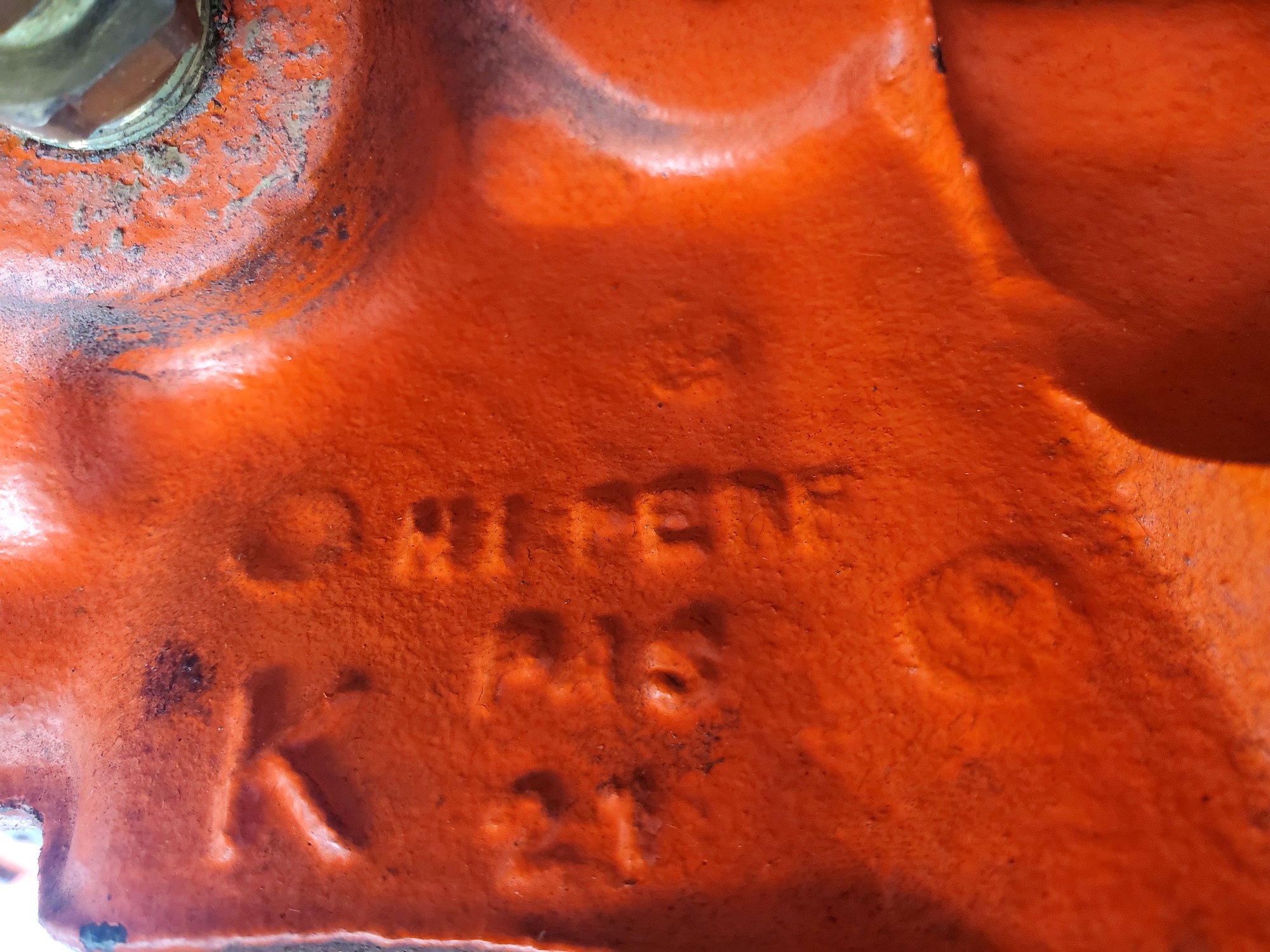

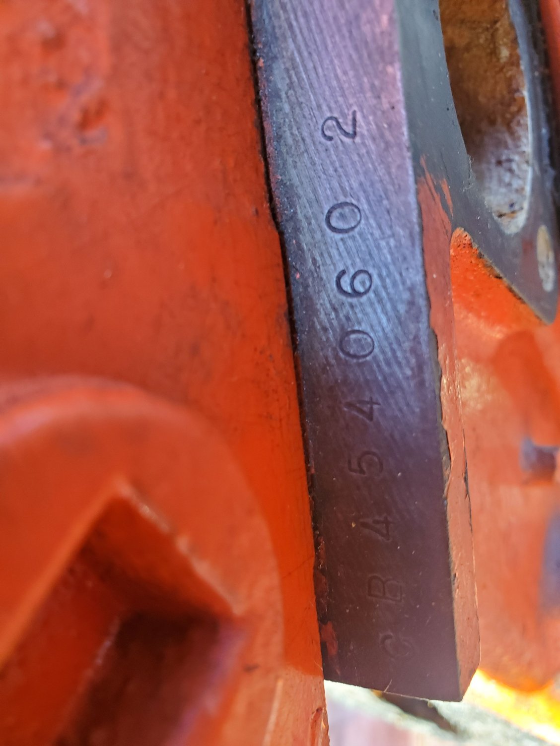

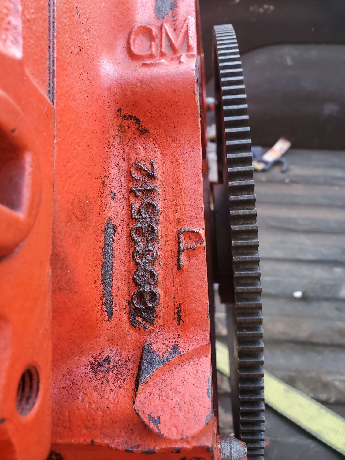

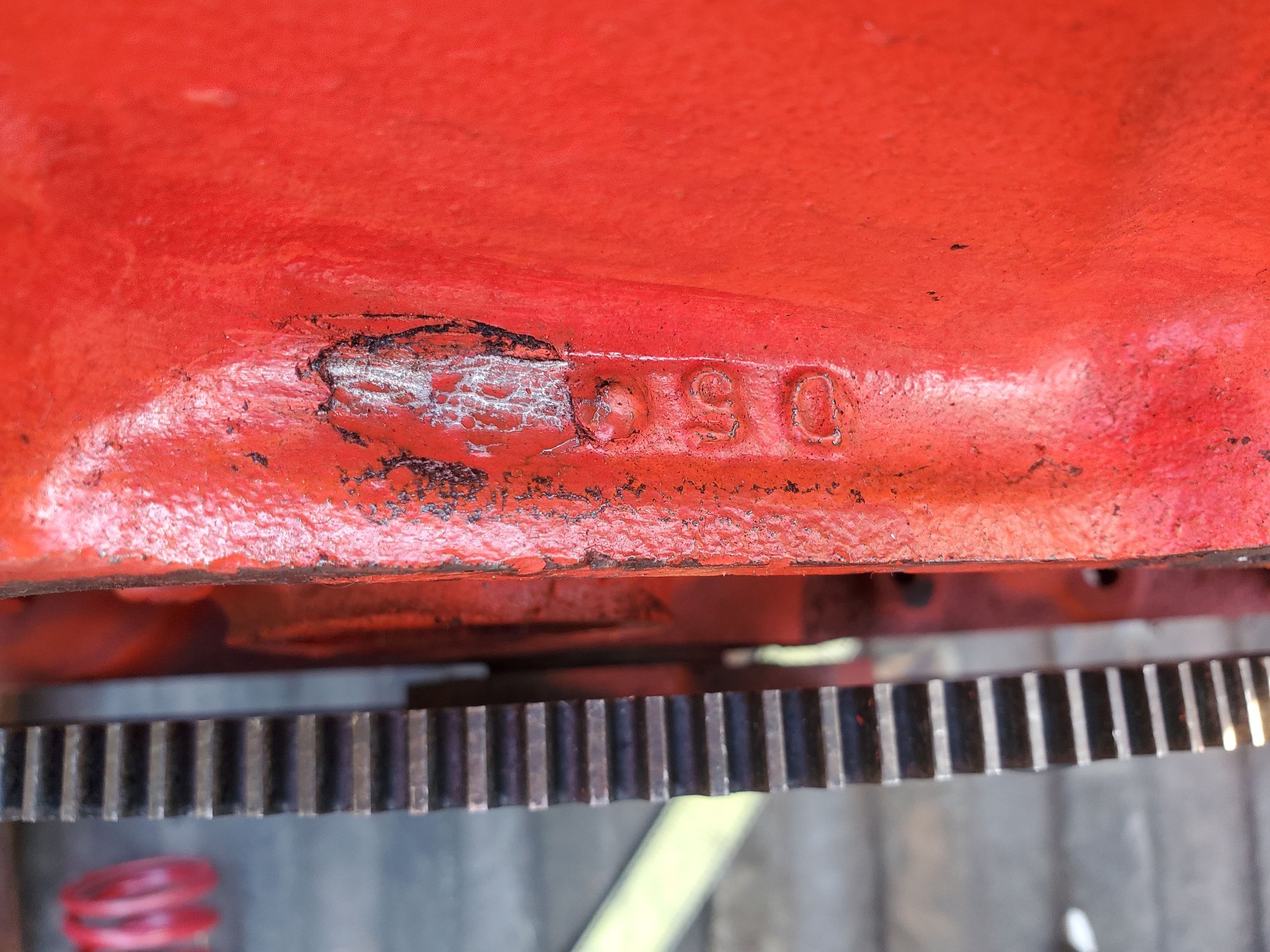

Alright so I'm having trouble with this engine, I was told this was a 69 427 but I have my suspicions. 3963512 is the casting number. D5 is all I see of the date code. I will post pics also. Any help is appreciated

Well, it's definitely been decked. I'm wondering about the stamping: not sure about "CB" but it could indicate 454 and .060 overbore with a 2-bolt mains. The block #3963512 was used for both 427 and 454.

Look by starter for date code. this is probably an early block.
Deck is restamped so ignore those numbers.

Ok so I looked for a date code above the starter and there was no numbers, only what looks to be a "shift indicator"casting. I also looked at the harmonic balancer that was with the engine but it wasn't on the engine, possibly wrong one but Idk. It did have the counter weight but I didn't see anything on the flywheel/flexplate. I guess I'll pull the pan and check the crankshaft numbers.
I think your right and CB is the initials of the builder or company.
